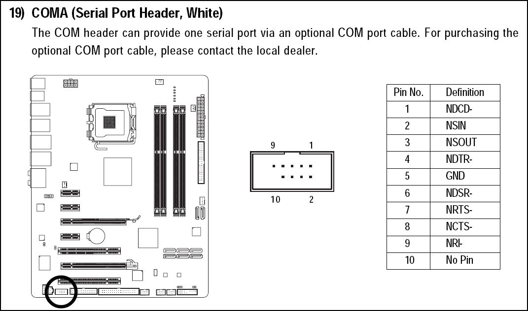

According to the web-page description for that motherboard, there is an internal header for a serial port.  All you probably need is a cable to attach to it.
Newegg must have it wrong then. It doesn't list any serial port on newegg for his board.
I actually took the time to look in the manual for his motherboard.  It says it has a serial port and a parallel port on headers on the MB:
Internal Connectors

1 x serial port header

I do have an internal port. I will have to find an adapter for it. It is the small rectangle 9 pin instead of a db9. If I could find a good pinout I could modify a serial cable to work I think.
Look at the image I attached to the prior post.  It has the pinout.
Thnaks Joe. I went ahead and ordered the motherboard adapter on the bay for 7 bucks shipped. I have the the cable from apc, so I should be good to go once the motherboard adapter arrives.
