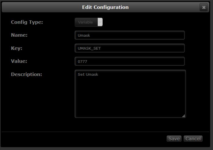

So here is my dilemma (Probably an easy fix, but I am stumped).  I have Resilio on my Unraid server, and it is the main sharing on Resilio.  I have a client (Laptop) that connects and syncs great.  The problem is this.  When I create a folder on the laptop, it syncs to Unraid fine.  But, it only gives permission of drwxr-xr-x.  The problem with this is that when I try to access that folder on another computer via SMB, i am unable to make any changes.  It is only Read Only.  How do I get Resilio to assign 0777 to all folders it writes to unraid?
Thanks!!

@poopsie @sup3rb0wlz
Add a new variable with the key UMASK_SET and the value 0777:
Edit: Not actually knowing a thing about how umask works, 000 may be the correct setting after reading a few more forum posts.
YOU NAILED IT!!!!!!!!!!!  I tried 0777, and that didn't do it.  I then used 0000, and it works!!  You rock!!!  I owe you a cold one or 12!!!!
Hell Yea! Thank you! This is what I was looking for, I knew I'd seen it before!
