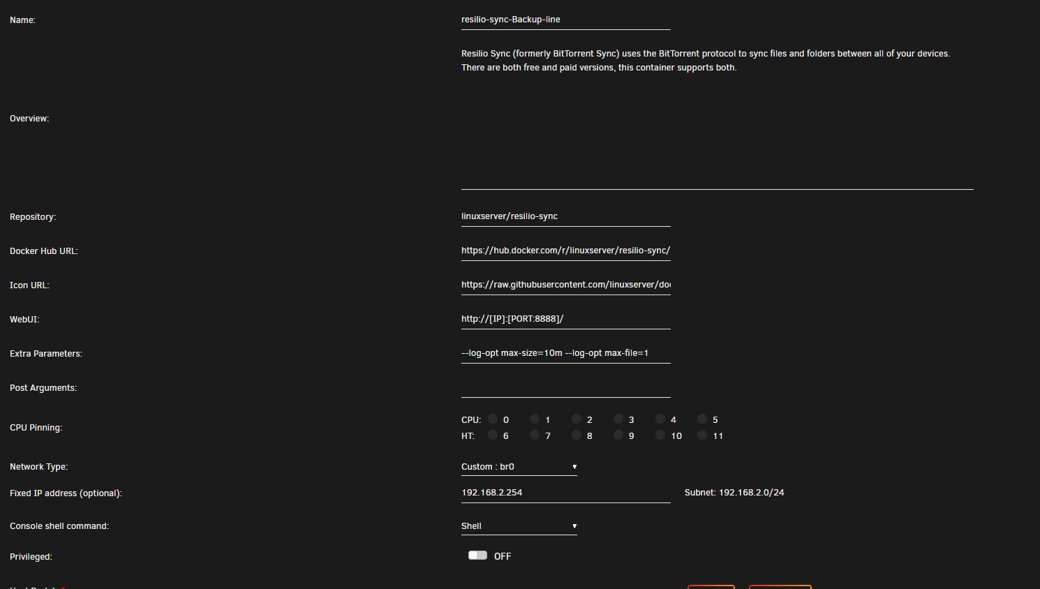

  • I have added this to extra parameters to help control the sprawl of log files "--log-opt max-size=50m --log-opt max-file=1" Sent from my ONEPLUS A5000 using Tapatalk
  • YOU NAILED IT!!!!!!!!!!!  I tried 0777, and that didn't do it.  I then used 0000, and it works!!  You rock!!!  I owe you a cold one or 12!!!!
  • I think im having this exact issue. After a few hours i run out of log and docker space causing all my dockers to disappear. Where exactly did you put these parameters? As a variable in the docker gui

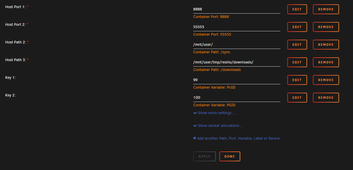

So, I have managed to get eh docker running with Unraid (as a trial) but I cannot seem to find out how to get the Sync to see the folders on my share as I want to sync folders over the internet between 2 servers.
Can someone point me in the right direction please
I set mine up like this. (see attached)
You can always add another host path for more folders.

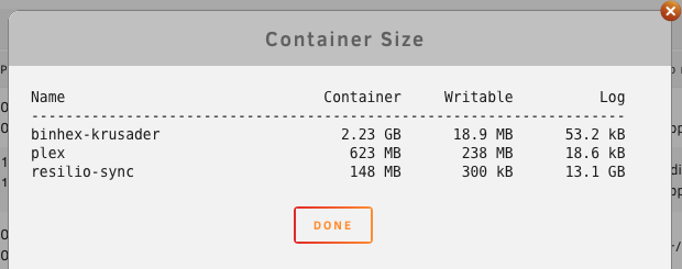

Rebooting the server doesn't clear it, so thinking it's not actually memory, it's data filling the docker container?
Looks like it is the Resilio log? Any idea how to remove the log?

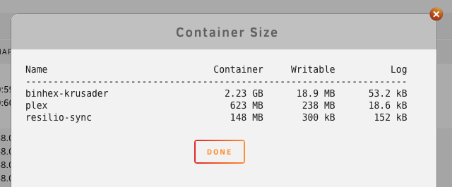

I force updated Resilio and it cleared the log. I've set the Docker log to rotate, but I'm presuming this is a different log which is just for Resilio? Is there a way to keep the Resilio log at a smaller size?????
32 minutes ago, Squid said:
If you did that in Settings - Docker, it actually won't work without a uninstall / reinstall
See this: https://forums.unraid.net/topic/57181-real-docker-faq/#comment-564326
Thanks, I force updated Resilio and it seemed to work.... will keep an eye on it. Do the container sizes in the above screengrab seem small for Resilio, should I and how do i increase it?
