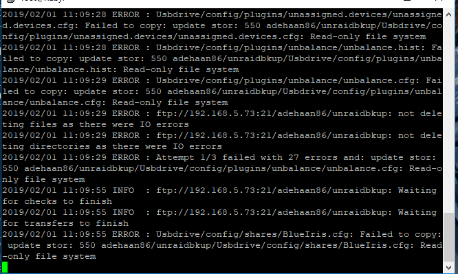

Would anybody be able to help? having IO errors and read-only file system.
I just rebooted server so not sure if related.
I rebooted to add a hard drive.
Script Ran:
rclone sync -v /mnt/user/backups/ NAS:adehaan86/unraidbkup/ --exclude "**/Older video/**" --exclude "/Work/**"
