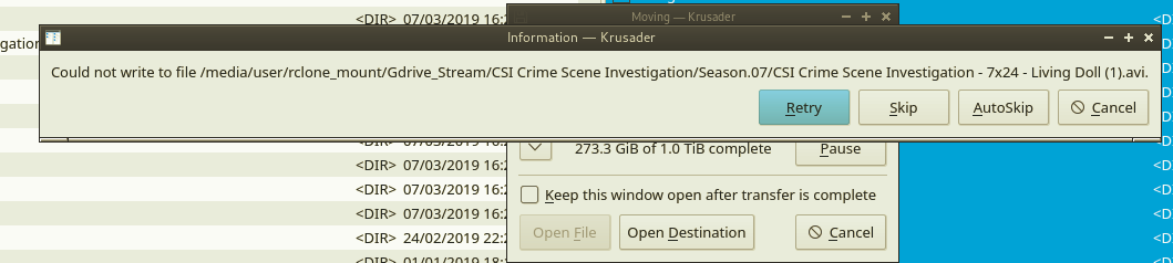

So I have been running Rclone for a couple of weeks after getting some help setting it up and I have a few questions about it.
First, When I am transferring, Every so often I get the following error and if I hit retry it just pops back up however if I wait a while and hit retry it will pick back up. my thought is that my uploads are storing on a cache drive of 750gb on google and I have to wait for some files to move off before I can put more onto it, well atleast thats what it seems because of needing to wait some time before I can put some more to google.
1170953112_ScreenShot2019-03-08at11_55_22AM.thumb.png.ff5ecd07e86fdda8e8e8cb55917caad7.png

The error you get is probably because you maxxed your 750gb daily upload to gdrive. You are writing directly to the Gdrive so your local drives are not hit or bottlenecking you.

Hey, does someone know how to make the mount point writable from a smb share?
I'm monting like this:
rclone mount --allow-other --dir-cache-time 96h --drive-chunk-size 32M --log-level INFO --log-file /var/log/rclone.log --timeout 1h --dir-perms 0777 --file-perms 0777 --umask 002 --rc secure: /mnt/disks/gdrive &
And I've tried these smb settings:
[secure-cloud]
      path = /mnt/disks/gdrive
      comment =
      browseable = yes
      # Public
      public = yes
      writeable = yes
      vfs objects =
[gdrive]
   comment = share
   browseable = yes
   read only = no
   writeable = yes
   create mask = 0771
   directory mask = 0771
   valid users = unraid
And I keep getting no permission error.
Any ideas? I don't plan to upload like this, I'm aware of rclone copy but sometimes I need to edit my files in the cloud.
