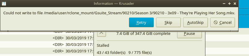

Can someone tell me while this keeps happening. Its random and non consistant. I am making sure I am well under the 750gb per day and if I hit retry 10 or 12 times it will work and move on for a few files before doing it again. its making moving files to gsuite a grueling process
You are writing data to your Google drive account all wrong.....That's why! rclone mounts are HORRIBLE to write to and really should ONLY he used to read data from.
Instead, if you MUST write to you Google Drive, use rclone copy/sync commands via terminal shell
It does the same whether I write to the mount folder or to the Union folder I have tried both and both continue to error.   Also I do not know how to transfer through Terminal shell so Im limited to Krusader
Edited by tmoran000
You need to learn how to use the Terminal Shell.
Again, writing to an rclone mount is NOT reliable. It does not matter if you write to the mount folder directly or via the union folder, it is NOT reliable. STOP EXPECTING IT TO BE.
Instead, if you MUST write to you Google Drive, use rclone copy/sync commands via terminal shell.
You're only limited to krusader because you are unwilling to LEARN. Put in the time, and learn how to use rclone properly. If you are unwilling to learn how to use Terminal Shell rclone commands, then you should just stop using rclone and seek alternatives.
If you Google search, you can even find people who wrote scripts to monitor your union folder and automatically fire off terminal Shell rclone uploads for you. Cloudplow is one of those tools. But you have to be willing to learn how to use it
maybe you should stop coming off as a dick. Never once did I say I was unwilling to learn, I was simply stating what I have done and where I was getting the errors based on the help I have received so far by some very good members of this thread so from here on out I will not need your help. thank you.

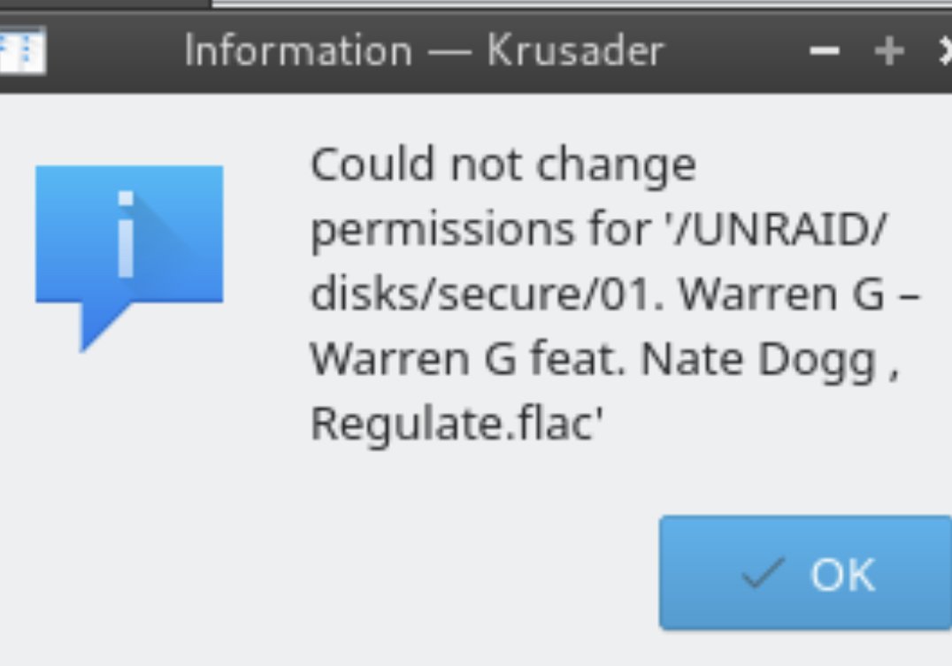

Hello,
i followed step by step space invader youtube video tutorial.
i want to sync my data from unraid to encrypted Google Drive/g suite for plex.
everything seems fine, all tests are good.
but when i want to copy a file via krusader from unraid to encrypted folder g drive i have a permission write error. And no sync. The gdrive is empty...
Maybe i missed something or don’t understand how to sync data from my server to gdrive.
Thanks in advance for your help
