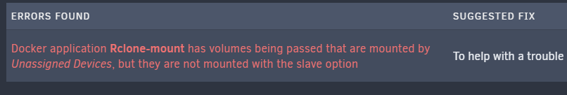

I'm sorry if this has been explain, but I just can't find it:
Any reason why I'm getting this warning in fix common problems:

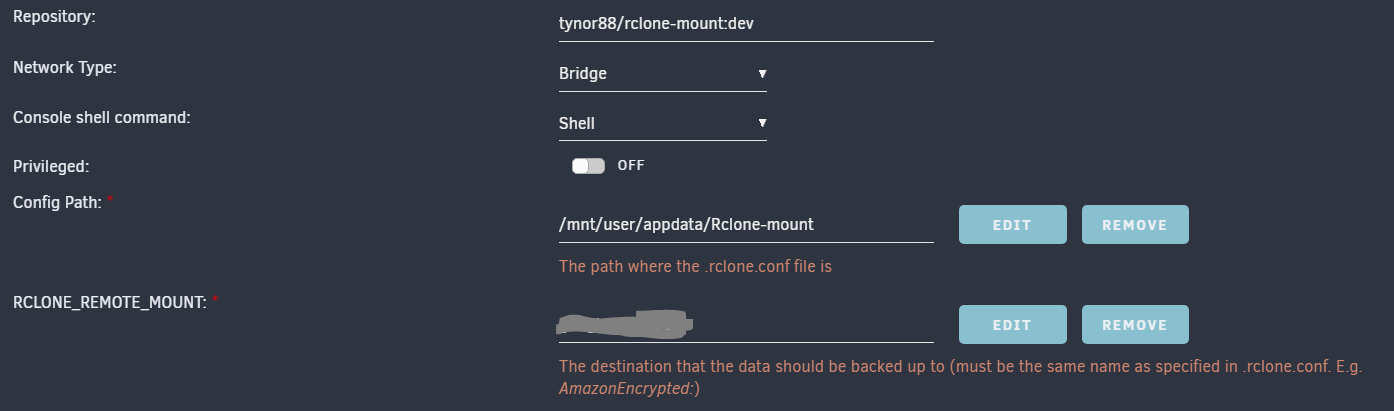

Docker application Rclone-mount has volumes being passed that are mounted by Unassigned Devices, but they are not mounted with the slave option
This is what the docker looks like (see docker-rclone-1.png).
@APD189
This is a thread for the plugin version of rclone. If you're having trouble with the docker version you should probably direct your question to the docker specific thread.

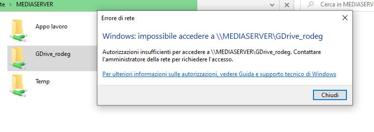

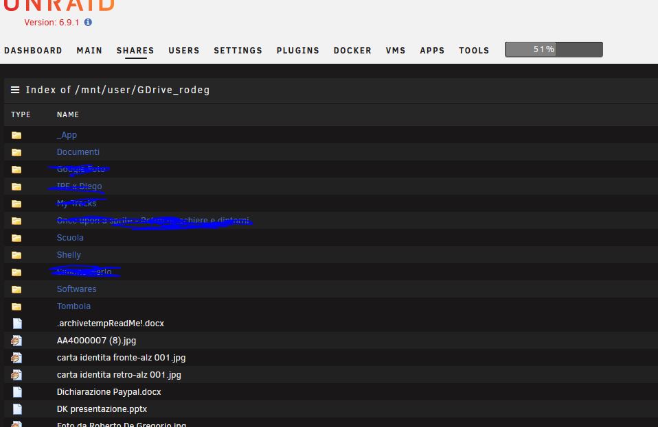

Hi everyone and sorry for my, probably, dumb question:
installed plugin and mapped a folder to reach gdrive folders (prefer to avoid sync on 2 ways because i'm using it on various pc).
Evertything seems to be fine because on unraid i can see content of my gdrive but, when i try to reach it using W10, system gave me an error telling i don't have authorization to enter the folder.
Where i'm in wrong?
Thanks for your help!
[GDrive_rodeg]
type = drive
client_id = xxxxxxxxxxxxxxxxxxxx.apps.googleusercontent.com
client_secret = xxxxxxxxxxxxxxxxx
scope = drive
token = {"access_token":"xxxxxxxxxxxxxxxxxxxxxxxxxx","token_type":"Bearer","refresh_token":"1//xxxx","expiry":"2021-03-29T10:47:02.890763241+02:00"}

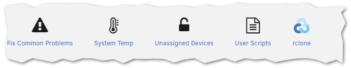

There will be a black icon in the next version 🙈
@Dr.NAS
Could you link me the official source? Can't seem to find it on the rclone github repo.
I agree though the colorful icon is a bit jarring in the new design language of unraid. There is an all black version on the rclone repo i might switch to.
Edit: oh now i remember why I chose the color version, the monochrome won't work on the dark mode theme! Going to leave it as it is.
Edited by Waseh
