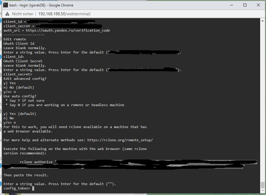

hello everyone, help me with configuring the plugin for yandex disk because I'm configuring via ssh I can't get token
