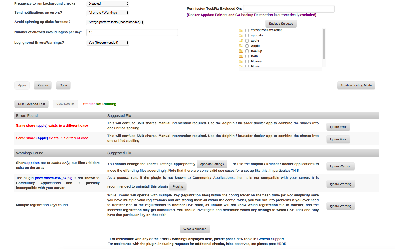

Every so often I get a bug to try an fix my UnRaid Server.  When I went to my PlugIn's and ran Fix Common Problems, I got the following messages (see attached) regarding Apple/apple and various appdata settings etc.

How have you tried to delete them?
Hi Trurl,
Through the normal procedure, but some of the files seem to come back even when deleted.
Unless I'm missing something, I'm not exactly sure what to do.  I've had some success deleting the files within the directories but not the "Share".
The other problem is that I created and Apple AFP per the Wiki but it kept using all of my space so changed to CrashPlan but don't seem to know how to delete the Apple AFP and still see it listed in UnRaid and on my Mac!
Finally I still have both Apple and apple and can't quite see how to combine and or eliminate the bad one though perhaps it would be easier to remove both and start over.  My concern would be the potential loss of anything previously created/set-up.
Dave
Dave
I can think of quite a few "normal procedures" for deleting files, which is why I bothered to ask in the first place. And if they were truly deleted there is no way they would come back, so whatever method you used fooled you.

You can delete the shares from the unRAID webUI when it is empty. Possibly you have hidden files still in them.
You might also try stopping the AFP service.  I suspect that your Apple computers automatically create those files every time you delete them!
Thanks Trurl and Frank1940,
Trurl, you were correct.  I went to Windows (Parallels) and found "hidden" files.  When I changed and removed them, UnRaid allowed me to delete the Share.  Thanks!
