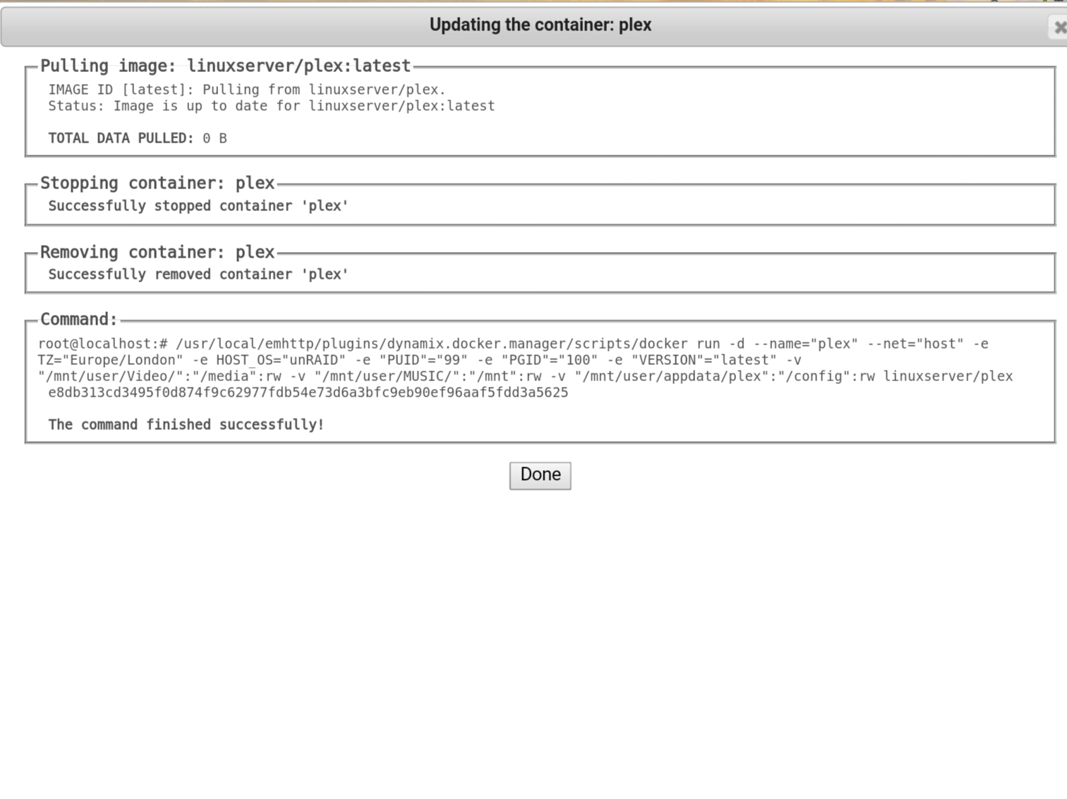

What I wanted was the screenshot of the docker run command, the first screenshot at that link I gave you. Or just give me the screenshot of the Docker page. I am trying to find out your volume mappings.
Attached. Sorry I missed half the images on that  post  that was linked as I was trying to do it on a tablet at the time. It probably would  have helped if you had asked the above as well as posting the link.

It seems odd that you would map your Music share to /mnt within plex while mapping your Video share to /media, but nothing exactly wrong with that.

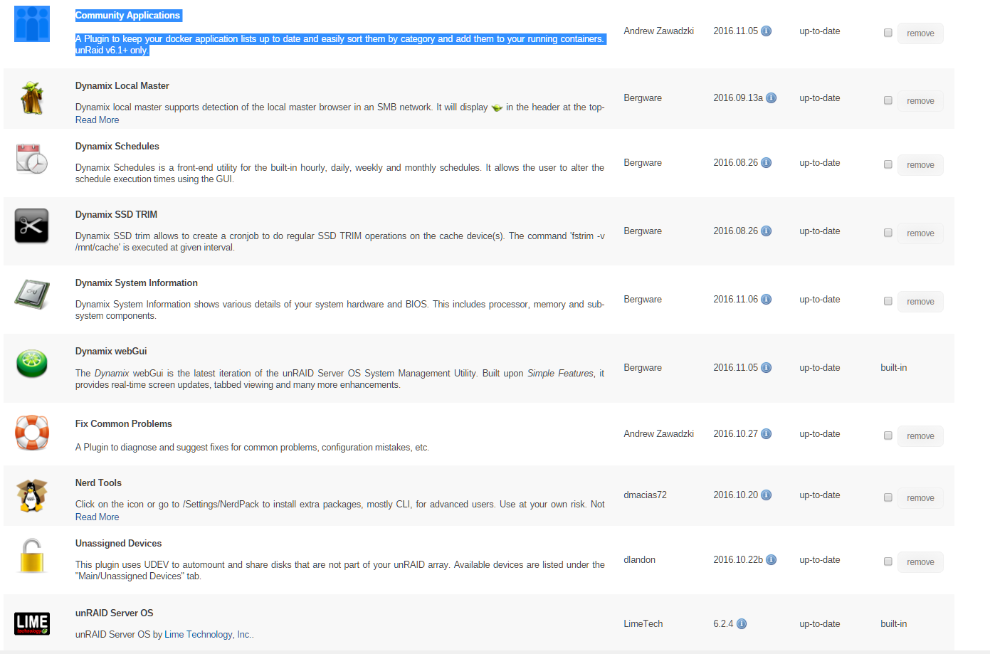

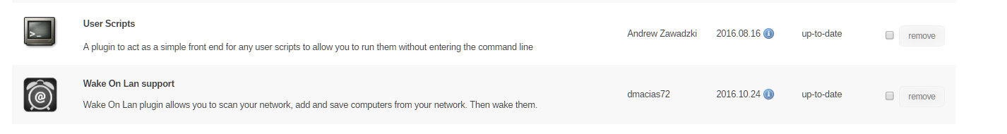

Plugins-
see below
