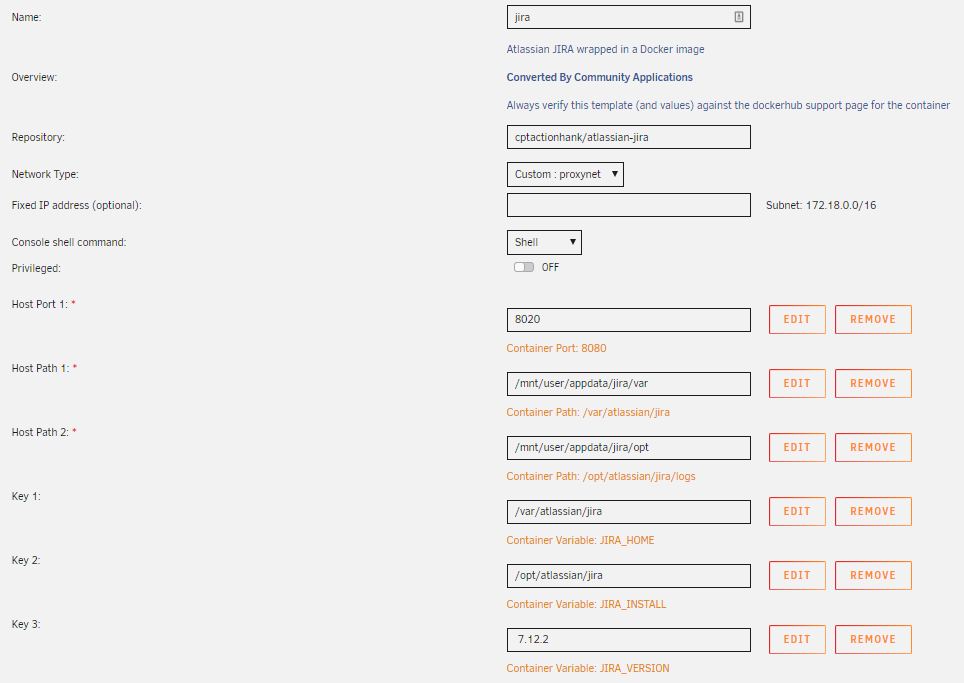

twok Posted September 28, 2018 Share Posted September 28, 2018 hello, I've setup letsencrypt with subdomain for nextcloud successfull, however I don't get how to set it up for not included applications. e.g. I would like to host my own Jira (Atlassian) instance for myself. This is what I did: server { listen 443 ssl; server_name jira.*; include /config/nginx/ssl.conf; client_max_body_size 0; # enable for ldap auth, fill in ldap details in ldap.conf #include /config/nginx/ldap.conf; location / { # enable the next two lines for http auth #auth_basic "Restricted"; #auth_basic_user_file /config/nginx/.htpasswd; # enable the next two lines for ldap auth #auth_request /auth; #error_page 401 =200 /login; include /config/nginx/proxy.conf; resolver 127.0.0.11 valid=30s; set $upstream_jira jira; proxy_pass http://$upstream_jira:8020; } } However when accessing it I get an 502 error. However the certificates are created so I'm sure it's liked to the subdomain file. Maybe someone can help me figure it out. Thanks, Matt Quote Link to comment
aptalca Posted September 28, 2018 Share Posted September 28, 2018 2 hours ago, twok said: hello, I've setup letsencrypt with subdomain for nextcloud successfull, however I don't get how to set it up for not included applications. e.g. I would like to host my own Jira (Atlassian) instance for myself. This is what I did: server { listen 443 ssl; server_name jira.*; include /config/nginx/ssl.conf; client_max_body_size 0; # enable for ldap auth, fill in ldap details in ldap.conf #include /config/nginx/ldap.conf; location / { # enable the next two lines for http auth #auth_basic "Restricted"; #auth_basic_user_file /config/nginx/.htpasswd; # enable the next two lines for ldap auth #auth_request /auth; #error_page 401 =200 /login; include /config/nginx/proxy.conf; resolver 127.0.0.11 valid=30s; set $upstream_jira jira; proxy_pass http://$upstream_jira:8020; } } However when accessing it I get an 502 error. However the certificates are created so I'm sure it's liked to the subdomain file. Maybe someone can help me figure it out. Thanks, Matt Port should be 8080 and make sure both jira and letsencrypt are in the same "user defined bridge" network Quote Link to comment
twok Posted September 28, 2018 Share Posted September 28, 2018 9 minutes ago, aptalca said: Port should be 8080 I've changed the default port to 8020 (sorry should have noted it) - full configuration attached. Proxynet beeing the letsencrypt network. As per spaceinvador1 guide. In Jira I've adjusted the base url to match the config. Previously I got it working using the jwilder letsencrypt nginx proxy. however with that I couldn't get nextcloud to work which is a higher priority to me. thanks. Quote Link to comment

aptalca Posted September 28, 2018 Share Posted September 28, 2018 6 hours ago, twok said: I've changed the default port to 8020 (sorry should have noted it) - full configuration attached. Proxynet beeing the letsencrypt network. As per spaceinvador1 guide. In Jira I've adjusted the base url to match the config. Previously I got it working using the jwilder letsencrypt nginx proxy. however with that I couldn't get nextcloud to work which is a higher priority to me. thanks. You changed the host port. The container port is still 8080. Nginx is connecting directly to the container via docker network, not going through host. Use 8080 in the proxy pass statement. 1 Quote Link to comment

twok Posted October 1, 2018 Share Posted October 1, 2018 On 9/28/2018 at 8:13 PM, aptalca said: You changed the host port. The container port is still 8080. Nginx is connecting directly to the container via docker network, not going through host. Use 8080 in the proxy pass statement. thank you so much! I thought with multiple dockers (jira + jira service desk) using the same port, I would need to go thru the external port. boy was I wrong. such a simple solution. thanks again! Quote Link to comment
