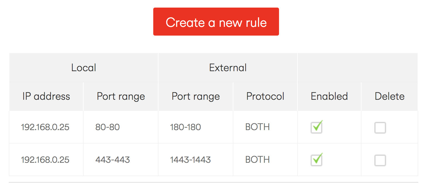

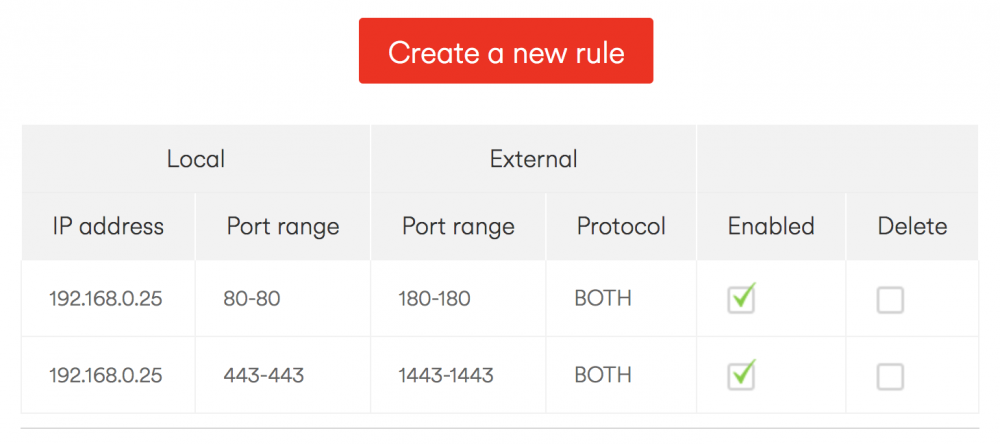

You need to forward port 443 or whatever you choose on your router to your letsencrypt container IP and port. Then set up nginx on the container to use the ssl cert and forward to nextcloud container. there is a example nextcloud config you can use and edit on the letsencrypt container. you just need to copy it to correct location ie /config/nginx/site-confs.

Also, forward the port 443 and then go to https://www.yourcustomsubdomain.duckdns.org and if you see the placeholder page, letsencrypt is working fine. Then you can set up nextcloud reverse proxy

I've started looking into the details you've suggested. I had read the readme and tried those things but had no luck and because I felt like I was just compounding possible solutions I tried to return everything back to default.
Before I post anymore details here I just realised my ISP blocks both ports 443 and 80 on inbound connections. I wonder if this is a fundamental problem or should I still be able to get this to work?
EDIT: I contacted my ISP and had them unblock the ports they were blocking. I can now see the 443 as open using http://canyouseeme.org/ and am getting a certificate exist feedback from https://www.sslshopper.com/ssl-checker.html
There still seems to be some errors so I've got more work to do but progress. Shame I probably wont have much time over the next few days being the holidays and all.

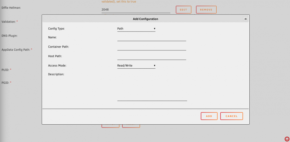

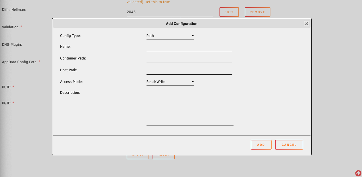

If I want to make changes to /etc/logrotate.d/fail2ban can I map that file to /config so it doesn't get overwritten on restart? I tried to add a volume mapping but I think I messed it up.. :P I also need to create a file in /etc/fail2ban but I think that folder is already mapped to /config so I should be able to just create the file in /config/fail2ban/ right? I've never really made any changes to files that are not mapped in the appdata dir in any containers before so I'm a bit lost here.
Link to comment
Why are you trying to modify the logrotate config file?
Well, I'm creating a jail for repeat offenders and want to have logs for a whole year. So I want to change the rotation to monthly and have it delete any logs older than 13 months. Right now the settings are weekly rotation and I only have logs for 7 weeks.
Any thoughts/ideas regarding this?
Link to comment
For the logrotate, you can map it as a path so container side it will be /etc/logrotate.d/fail2ban and host side would be wherever your custom file is at on your unraid.
For the actions and filters, just put your new configs into the respective folders under /config as they are already made available for user customization.
I used recidive in the past where regular bans were short lived (5mins) but if an ip got banned 3 times in a 10 hr period, they would be banned for a whole week. Never did anything longer than that.
Link to comment
Thanks! I believe I tried this but it didn't work, can't remember what went wrong though. I'll try it again when I have time.

when you say "unraid side" and "container side", do you mean that I need to use the "+ Add another Path, Port..." option in the Advanced settings of the Docker's "Edit" page? (see attached)
And then choose "Path"?
so if I wanted to move the www folder to - say - unRAID/Sites/avpmatrix/, what would the correct settings/syntax be for those input fields?
Link to comment
Start here:

Hi everyone,
I hope someone can provide me with some advice as I’m pulling my hair out over this.
I followed the tutorial posted by spaceinvaderone (linked below) which shows how to setup letsencrypt
https://www.youtube.com/watch?v=I0lhZc25Sro&t=753s
 Unfortunately as soon as I run letsencrypt, I get the error message in the log which states:
Failed authorization procedure. blabla.duckdns.org (http-01): urn:ietf:params:acme:error:connection :: The server could not connect to the client to verify the domain :: Fetching http://blabla.duckdns.org/.well-known/acme-challenge/wL2-Ux5ap6jNeo4TLJ44KY9Rp9OBcYjSqAZVlbBxnwA: Timeout during connect (likely firewall problem)
I’ve made sure with my ISP (Virgin media-UK) that both port 80 and 443 are not blocked. I just can’t seem to get this setup. Can anyone guide me on this? Port forwarding looks to be fine on the router as I’ve looked at three different videos which explain how to do it on that router. Please see picture to below to show how its setup on the router side...
968600845_ScreenShot2018-12-30at02_11_03.thumb.png.4ae3b6e3d932bf4eb41b8c4f1f9579e8.png
Can anyone help? I would really appreciate it
Edited by entourage2111
Link to comment
Assuming you have set up the NGINX docker to listen on 180 and 1443, you need to switch the local and external port ranges. 80 and 443 need to be external.
