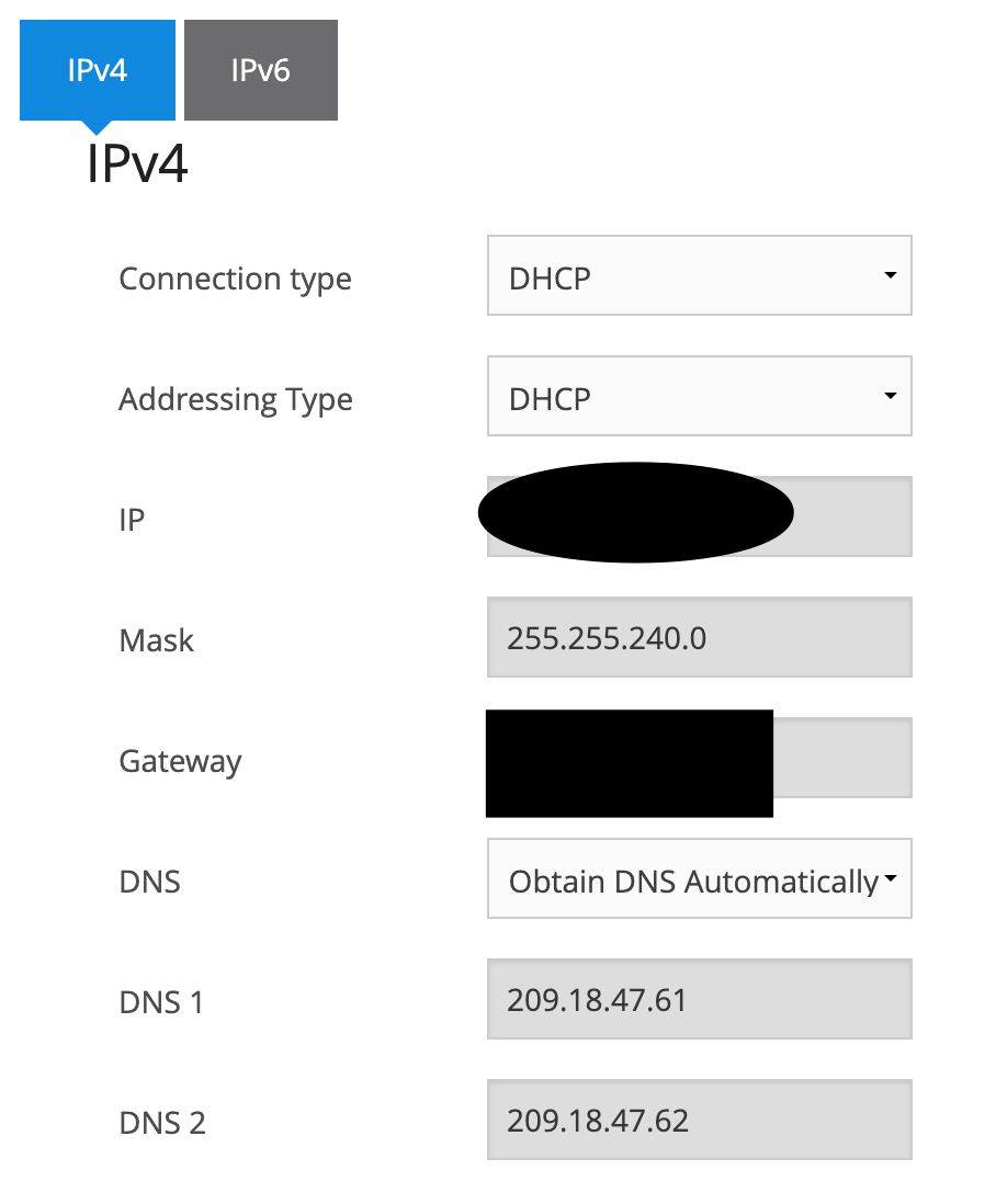

1 minute ago, CHBMB said:
As I keep telling you, the issue is NAT reflection and that link says your router doesn't support it.
Your only solution is to change your hardware.
Sent from my Mi A1 using Tapatalk
I understand. Thank you. I did search for that on google i just didnt use my hardware i just used spectrum. Well now we know that i need to change the wireless router at home. It's actually sitting on my desk. I did type the ip address manually and it takes me to this screen. Then i click on advance to continue and it takes me through https. Crazy. Well @CHBMB Thank you for been patience and for helping me and other here. You are truly amazing.
