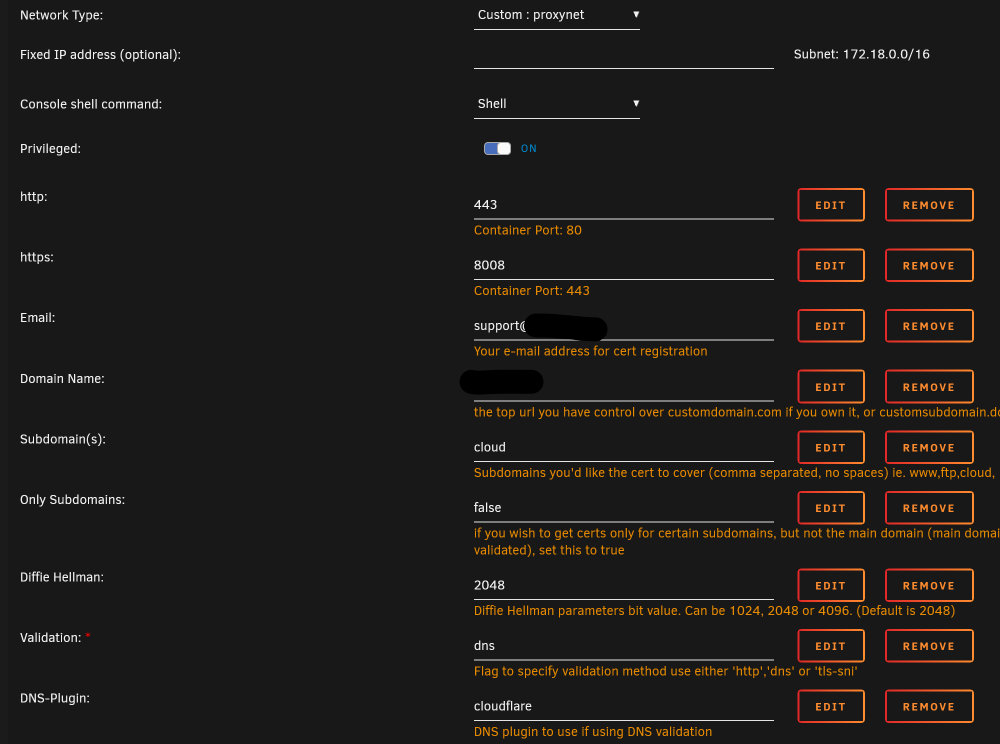

Hello there. Unsure if this is the most appropriate place to ask but I guess it's worth a try.
I keep getting "Challenge failed for domain.." in the initial setup validation and I suspect I'm messing up with the port-forwarding somewhere along my network.
-Following SpaceInvaderOnes' guide on Letsencrypt I have http pointing to 180 and https to 1443.
-I have an "obligatory" modem provided by my ISP (Technicolor TG789vac v2) which does not allow/provide an option to  switch to bridge mode due to some kind of conflict with VoIP. My port settings are visible in image 1.

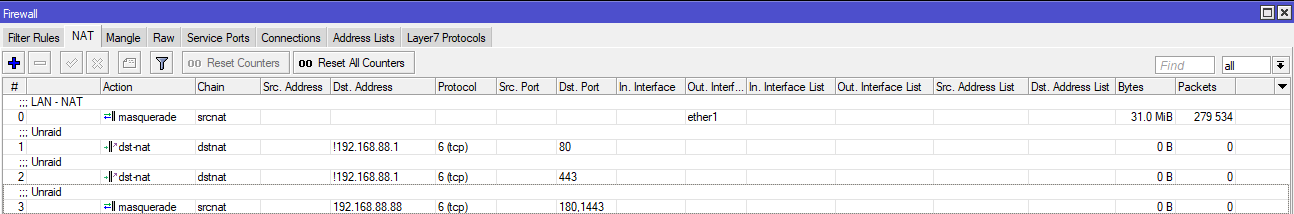

-I have a Mikrotik hEX PoE Routerboard with port settings visible in image 2, or as follows:
/ip firewall nat
add action=dst-nat chain=dstnat comment=Letsencrypt dst-port=80 dst-address=!192.168.88.1 protocol=tcp dst-address-type=local to-addresses=192.168.88.88 to-ports=180
add action=dst-nat chain=dstnat comment=Letsencrypt dst-port=443 dst-address=!192.168.88.1 protocol=tcp dst-address-type=local to-addresses=192.168.88.88 to-ports=1443
/ip firewall nat
add action=masquerade chain=srcnat comment=Letsencrypt dst-port=180,1443 dst-address=192.168.88.88 protocol=tcp
Where 192.168.88.1 points to the Mikrotik router and 192.168.88.88 points to Unraid.
Any ideas on where I might be messing up?
Please ask if additional info might be required. Appreciate your time and effort.

In the mikrotek you should port forward 180 to 180 and 1443 to 1443 as you already port forwarded from 80 to 180 and 443 to 1443 in your isp modem. With the forwarding you set up now, all traffic is lost between the modem and your router.

After following @saarg's advice, use this to confirm: https://blog.linuxserver.io/2019/07/10/troubleshooting-letsencrypt-image-port-mapping-and-forwarding/

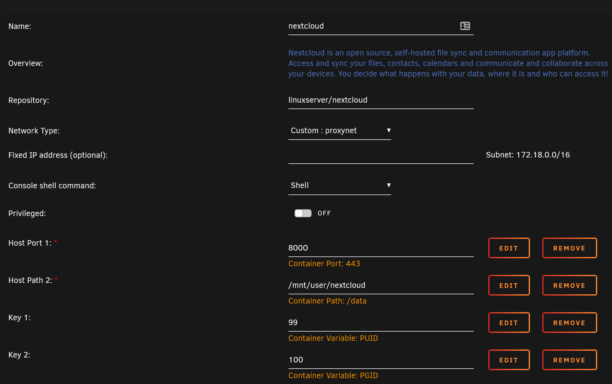

I'm trying to move my Nextcloud setup from a subfolder setup to a dedicated subdomain using a CNAME record pointing to my DNS.
But I'm struggling to get this to work.
Here are the files I adjusted, maybe someone can have a look at this please:

Nextcloud container
config\nginx\site-confs\default
upstream php-handler {
    server 127.0.0.1:9000;
    # server unix:/var/run/php/php7.2-fpm.sock;
server {
    listen 80;
    # listen [::]:80;
    server_name cloud.*;
    # enforce https
    return 301 https://$server_name:443$request_uri;
server {
    listen 443 ssl http2;
    # listen [::]:443 ssl http2;

Hey everyone, I had to change DNS configurations recently due to port 80 being blocked and I'm having a heck of a time since moving to Cloudflare and trying to use DNS authentication. I have tried many things and am getting 522 errors from Cloudflare and am hoping that you can help me.
I most recently started over with the letsencrypt container, here is my configs....
Log file output

Proxy config for nextcloud (also the name in my docker settings:
server {
    listen 443 ssl;
    listen [::]:443 ssl;
    include /config/nginx/ssl.conf;
    client_max_body_size 0;
    location / {
        include /config/nginx/proxy.conf;
        resolver 127.0.0.11 valid=30s;
        set $upstream_nextcloud nextcloud;
        proxy_max_temp_file_size 2048m;
        proxy_pass https://$upstream_nextcloud:8000;
Nextcloud and Letsencrypt Docker configs are attached. Unraid web interface runs on another port so I do actually use 443 for Letsencrypt

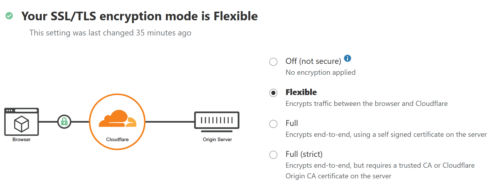

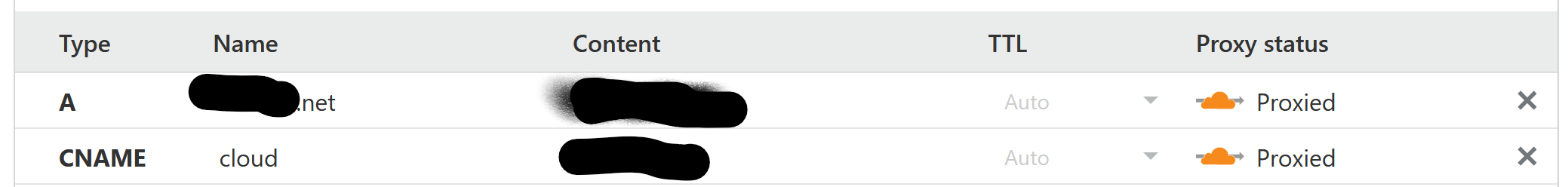

My Cloudflare settings are also attached. I'm not sure if my subdomains should be proxied or not and what my SSL setting should be.
Thanks for any help you can offer!

@Kash76
You do not change the port in the proxy conf when using a custom bridge as letsencryptaand nextcloud are talking internally  and don't use the port forwards.
Change it from 8000 back to 443.
Share this post
Link to post
5 hours ago, saarg said:
@Kash76
Thanks much for the response.  I changed it back to this and am still getting 522 errors on network and 523 off network
server {
    listen 443 ssl;
    location / {
        proxy_pass https://$upstream_nextcloud:443;
Turn off cloudflare proxy (click on the orange cloud)
Thank you! Making progress, did that and am now getting "ERR_SSL_PROTOCOL_ERROR" in Chrome and "SSL_ERROR_RX_RECORD_TOO_LONG" in Firefox. I usually do not have issues like this but am having a hell of a time troubleshooting this.
Nothing in my error log, access log has entries like this...
10.x.x.x - - [27/Nov/2019:12:15:12 -0600] "\x16\x03\x01\x01.\x01\x00\x01*\x04\x03H\xC4z\xDE\x0B(\xF8\x9E-\x88\xD0l0\x8EC\xC9\x14\xBD\xC2\xD0\xFEq{\xE8\x07H\x9EX\xFDs\xF6D\x00\x00\x88\xC00\xC0,\xC0(\xC0$\xC0\x14\xC0" 400 157 "-" "-"
