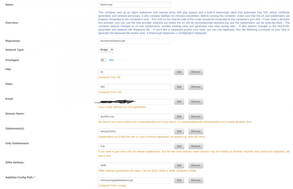

Hoping someone can help me with regards to an ssl certificate problem I seem to have when using this docker to get certified.
I used this docker to generate a ssl certificate for my duckdns address and everything went as planned. Even when I use various ssl certificate checking websites, they all show that the link is secure.
However, when I access my home through VPN using chrome, the green padlock does not show and I'm left with an (information logo inchrome) which shows I may be at risk.
Does anyone know how I can resolve this issue?
FYI, the domain address for me is hamza219421@duckdns.org
Can I also add that when I try to  access unraid locally at home, I don't get a 'green padlock' then either. I figure that doesn't matter since I'm at home locally but would love to have that special 'green padlock' when I try to access from elsewhere.
Thanks a lot for the help :)
Share this post
Link to post
This won't have any affect on the Unraid webui, it's for an externally facing webserver.
Are you sure you're going to https:// not http://
Share this post
Link to post

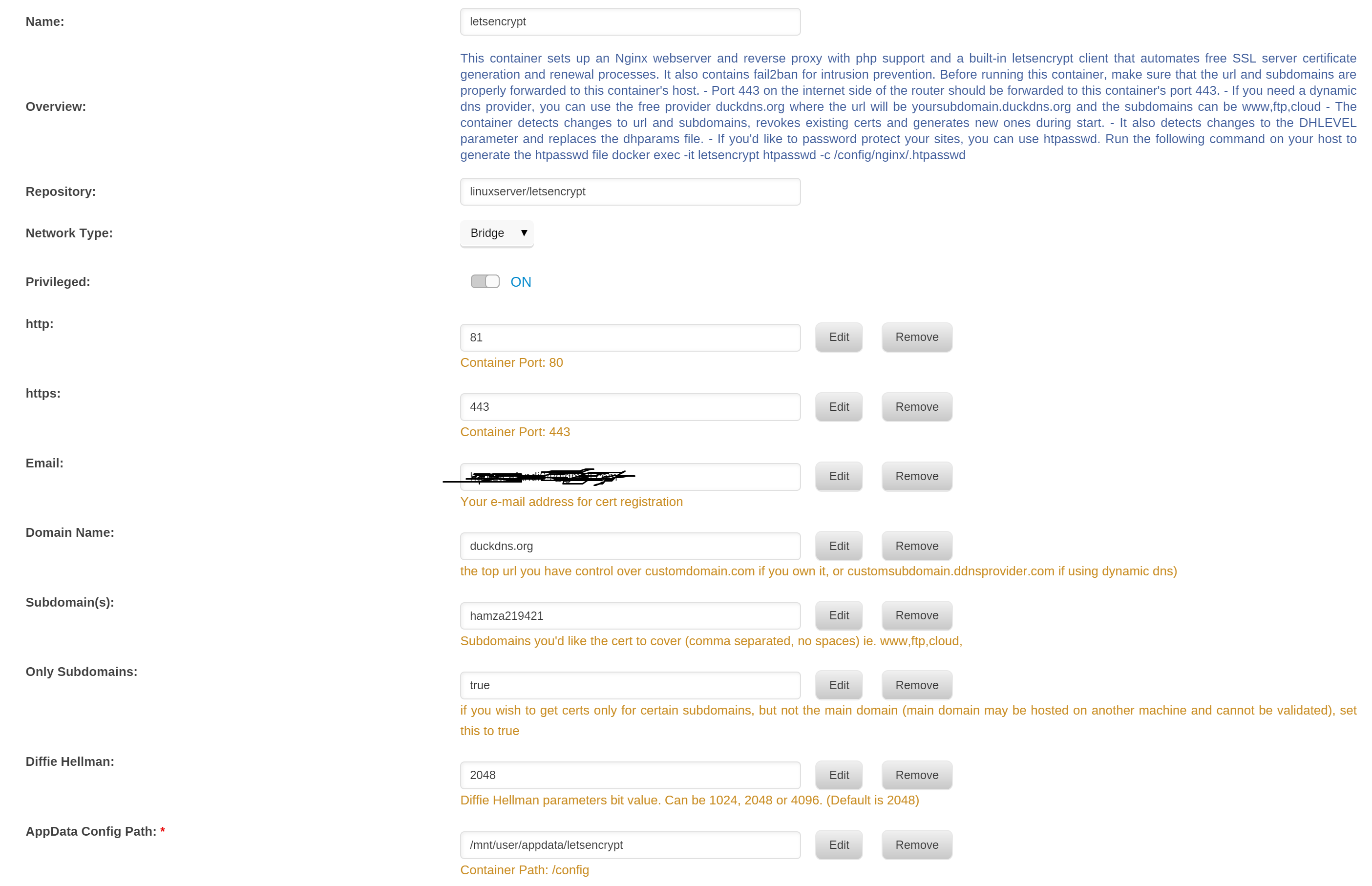

That's the thing. I don't know how to get it to go to https:// on the docker install page of letsencrypt.
I've attached my settings with this post.
Of course, when I try to go to https:\\192. bla bla when connected to the VPN that page doesn't load.
But when I type in just the IP of my server, it goes to it just fine (but at the cost of not being secure)
Share this post
Link to post
I don't think you really understand what this does.  It installs an externally facing nginx webserver with certs from letsencrypt.
It's got nothing to do with local ip addresses like 192.168....
Share this post
Link to post
