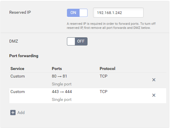

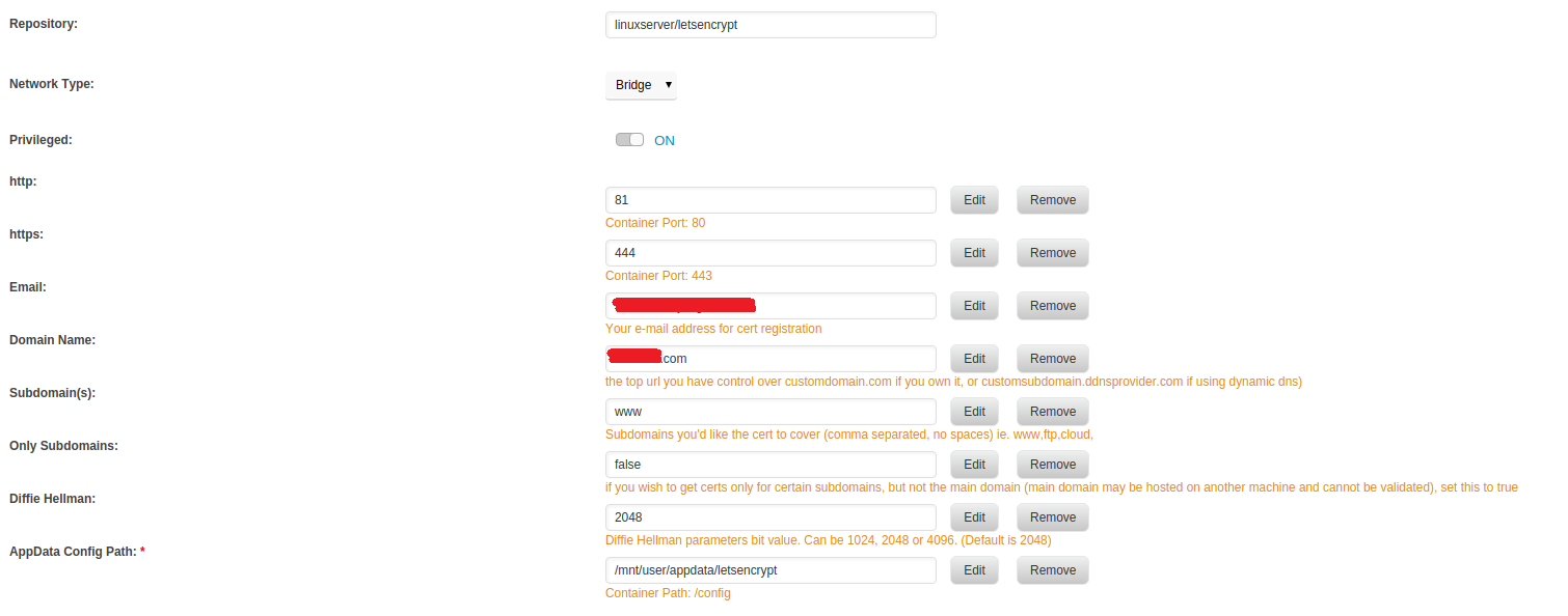

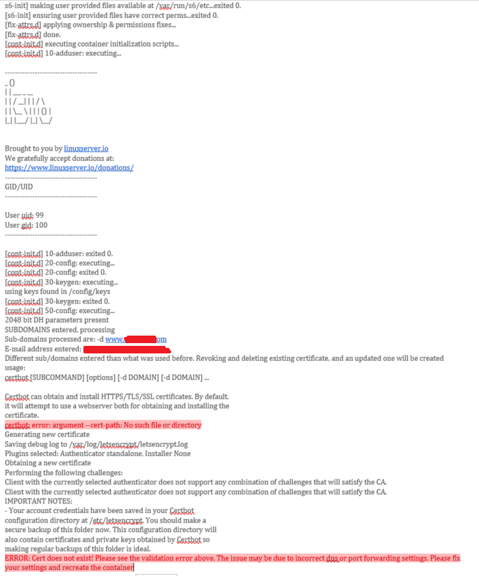

Hi guys, I am having some issues.  Logs, settings, and router settings attached.  Thanks for the help.

@statecowboy  Can you post your docker run command so I can be absolutely sure what is happening,  the template doesn't always show everything.  But it looks like you've got no HTTPVAL variable.
Hi - I'm sorry for wasting your time, but it turned out I did not set http val to "true" in my config.  Doing so fixed the problem.  Everything is working now.
Thank you.

8 hours ago, CHBMB said:
Read my post above yours
So I've made httpval = true.
pointed port 80 to the unraid server.
I tried to change the http setting in the docker panel to 80 but it fails.
It says 80 is already allocated, though I'm not sure to what.
Back to 8088 which was my previous setting.  It starts but no certificate.
I checked previous posts but missed the answer if it is there.

Post the info we asked for and we can tell you where you're going wrong. Unraid webui is running on port 80 for starters.
The github instructions are correct, the issue tends to be people not understanding ports.

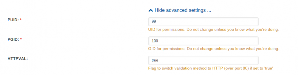

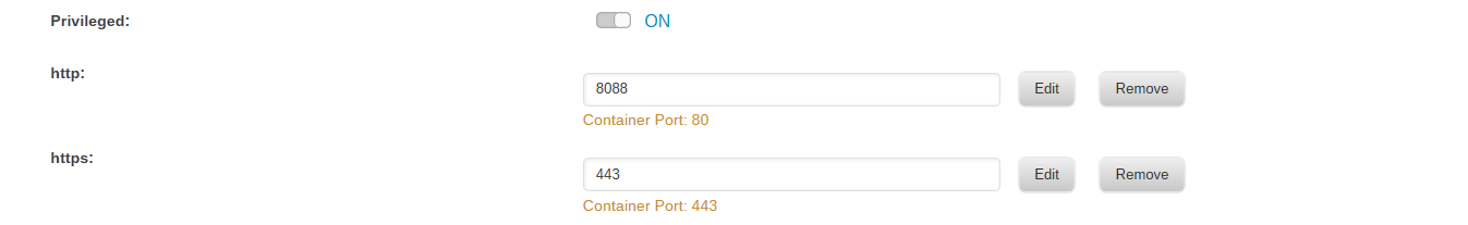

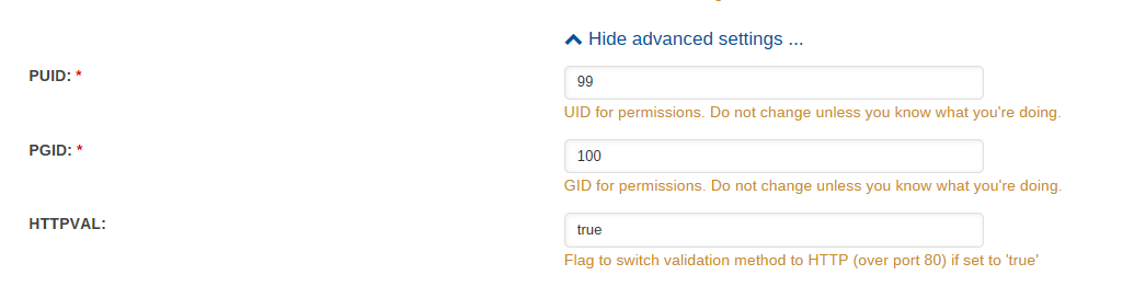

If anyone is interested and had a previously working Letsencrypt docker which stopped:-
Change container port 80 to something that is not 80 on the docker config page.  (I used 8088)
Go to advanced settings on the Docker config page and make HTTPVAL: = true.
In your router, point external port 80 to internal port 8088 (or the internal port of your choice) to the ip address of the unraid server.
All other settings as you had them.
(The rest of it was set up as per CHBMB's Guide)
Restart the Dockers.
Worked for me.
