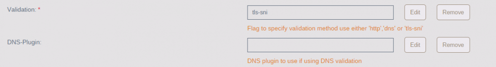

So I am trying to switch the validation from HTTP to TLS-SNI but I am getting an error

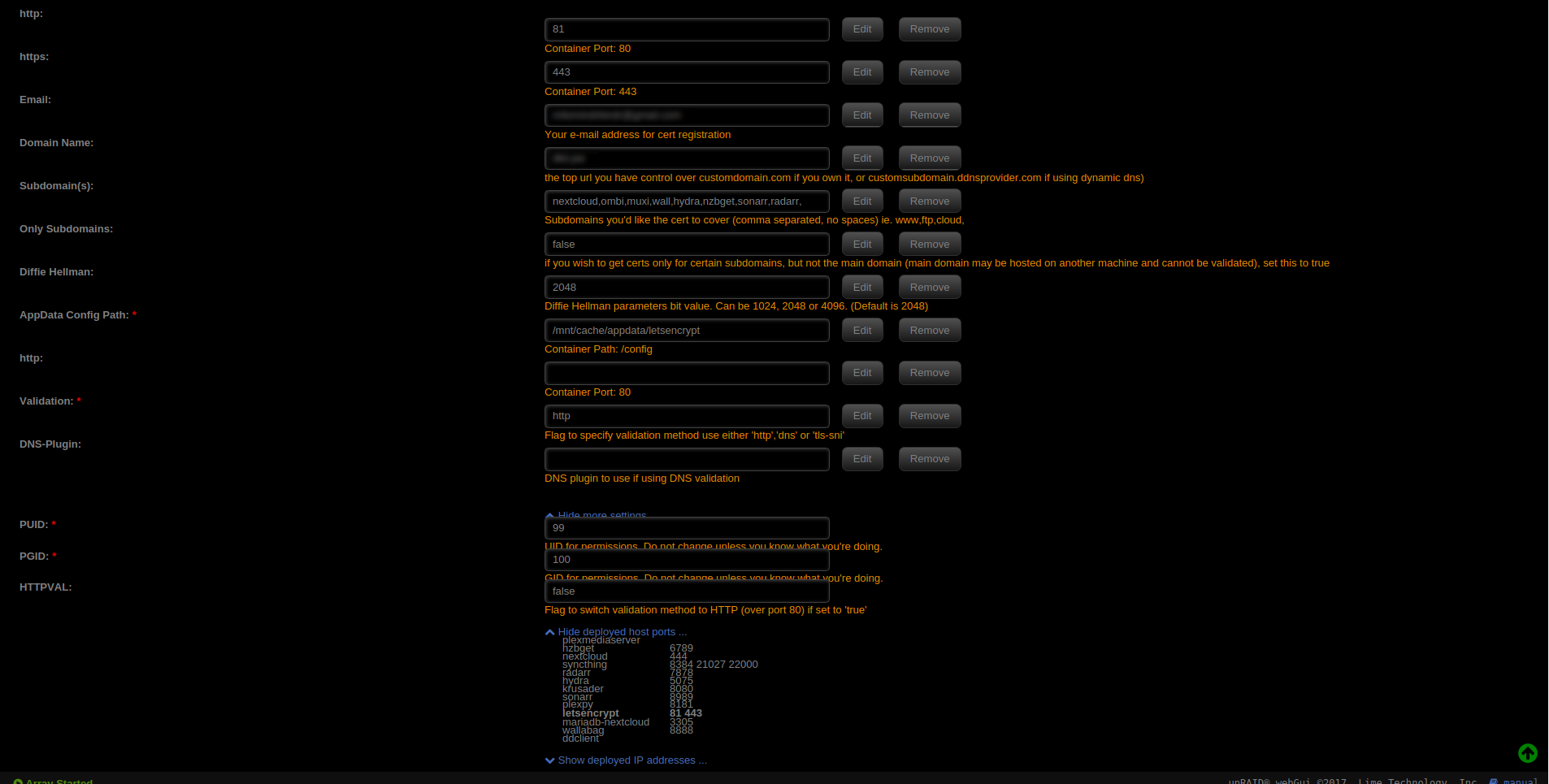

4 hours ago, Invincible said:
The latest update (from last night) seems to have broken something for me.
I haven't changed any of the settings however i noticed there was a new "Validation" option in the docker settings which is set to HTTP.
I also noticed that the HTTPVAL setting was missing from the show more settings tab.
Any ideas what would have broken the config for me?

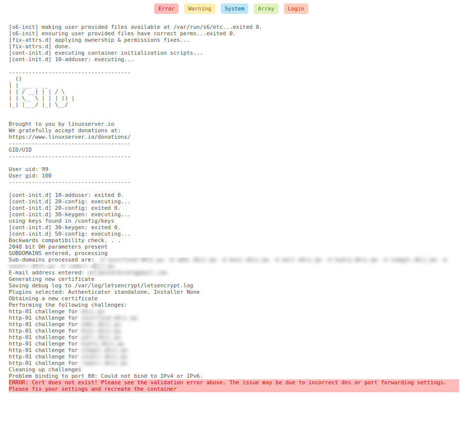

Generating new certificate
Saving debug log to /var/log/letsencrypt/letsencrypt.log
Plugins selected: Authenticator standalone, Installer None
Obtaining a new certificate
Performing the following challenges:
http-01 challenge for ******.duckdns.org
Waiting for verification...
Cleaning up challenges
Failed authorization procedure. ******.duckdns.org (http-01): urn:acme:error:unauthorized :: The client lacks sufficient authorization :: Invalid response from http://******.duckdns.org/.well-known/acme-challenge/MKKaK-NvviGlS4ME6FlQ5uTBojzr8WHznM36sgR8Ujo: "<html>

ERROR: Cert does not exist! Please see the validation error above. The issue may be due to incorrect dns or port forwarding settings. Please fix your settings and recreate the container

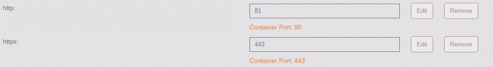

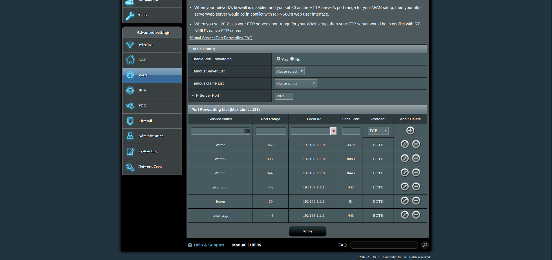

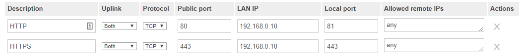

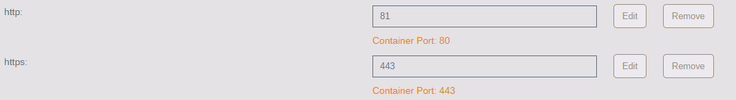

The second screenshot looks like your router is forwarding port 80 to port 80 on unraid for tcp, and port 81 to 81 on unraid for udp. What you need is to forward port 80 to port 81 for tcp. Right now, letsencrypt servers are connecting to your unraid web gui

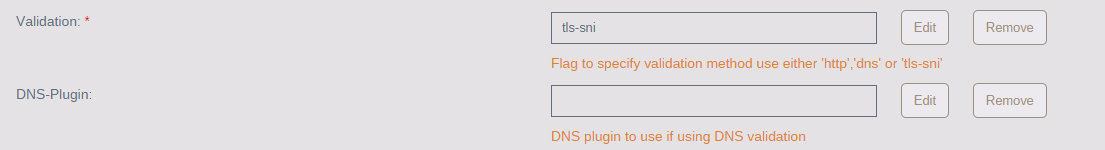

11 hours ago, WannabeMKII said:
Ah ha, adding "tls-sni" = "true" has got me back up and running!
Port 80 is still appearing as closed though?
Now just to get nzbhydra2 actually loading properly.
Superb news though and really appreciate the constant help from everyone, absolutely legendary!
This container does not recognize "tls-sni" = "true", so something else you did must have fixed it.
Looks like there was a separate section on my router to configure this. That seemed to fix it, thanks!
