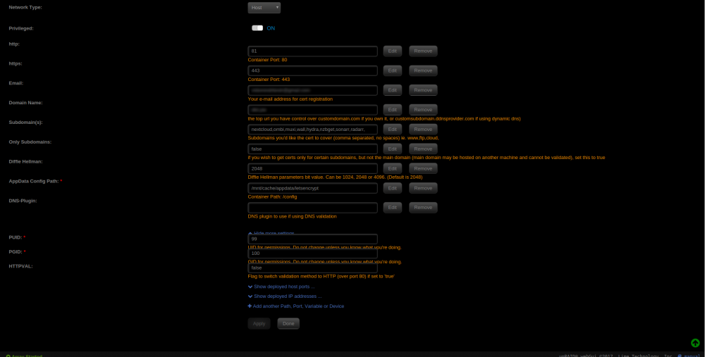

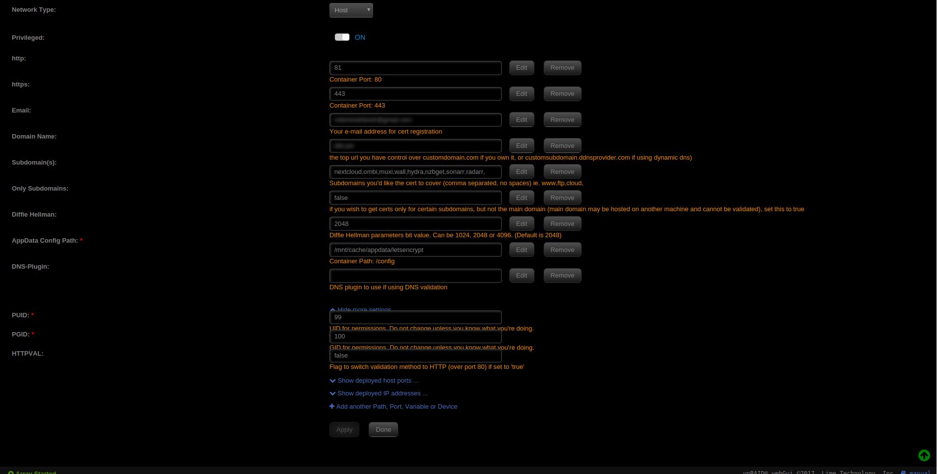

9 hours ago, CHBMB said:
You've got http port defined twice, so remove one, and remove HTTPVAL = FALSE (the whole variable)
Hi CHBMB,
Please could you elaborate on how to remove HTTPVAL = FALSE? I think having it there may be my issue now, but can't see a way to remove that variable? I have removed my "extra" http option like you've recommended to sdoksdlkk but I can't see a way to do so for HTTPVAL?
Link to comment
Hi CHBMB,
Try switching on advanced. Or go to settings docker and turn on authoring mode.
Link to comment

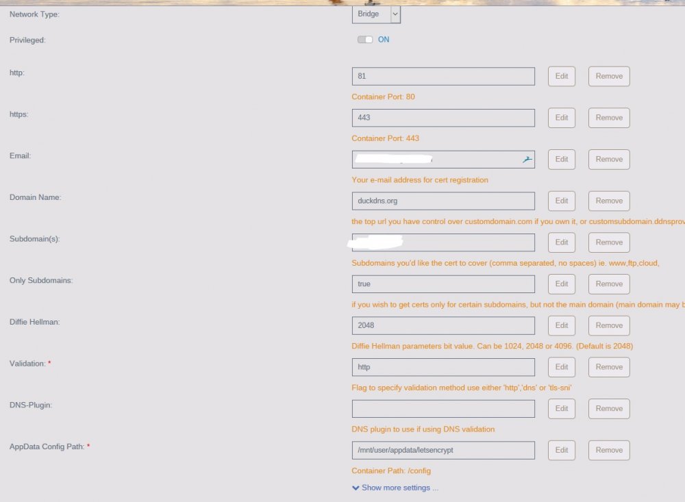

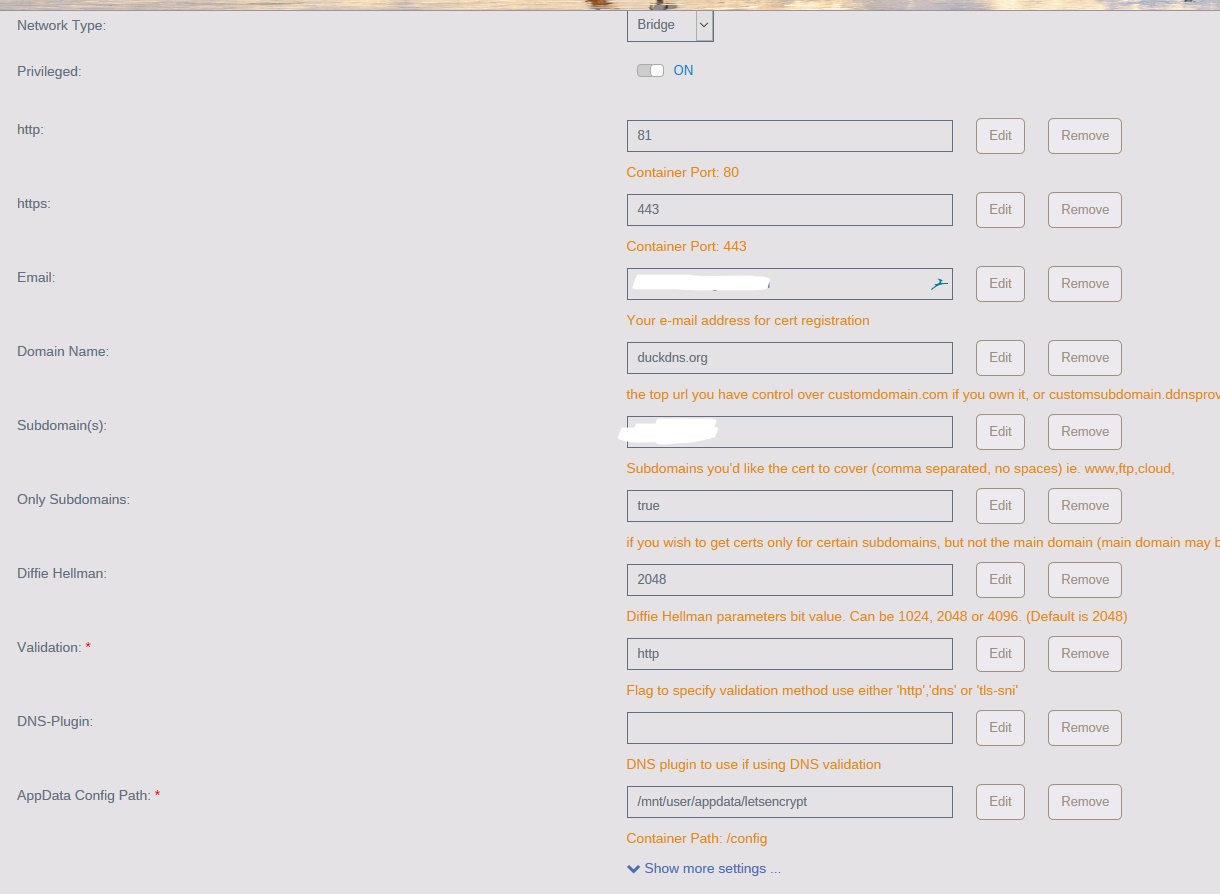

3 hours ago, sdoksdlkk said:
Pretty sure I've done what you suggested and still not working.
Is this correct?
You still have HTTPVAL in there. You need to remove that and add VALIDATION instead and set it to http
You also need to change network mode to bridge instead of host. It is now trying to bind port 80 but unraid is using it

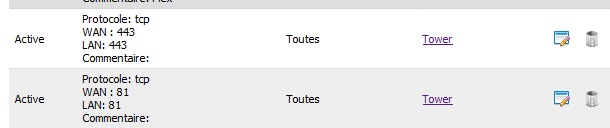

Hi
I need some help to make the LE docker image works.
I created a subdomain on duckdns.org. Dns propagation is fine (tested on https://dnschecker.org)
When I start the docker, everything is fine, the command finished successfully. But in logs I have these errors :
Failed authorization procedure. xxx.duckdns.org (http-01): urn:acme:error:connection :: The server could not connect to the client to verify the domain :: Fetching http://xxx.duckdns.org/.well-known/acme-challenge/Ey1_KaCKpqDnA86-Q46OkTcgUyTxRTGpARr8Aj2ONAE: Timeout
IMPORTANT NOTES:
- The following errors were reported by the server:
Domain: xxx.duckdns.org
Type: connection
Detail: Fetching
Timeout
To fix these errors, please make sure that your domain name was entered correctly and the DNS A/AAAA record(s) for that domain contain(s) the right IP address. Additionally, please check that your computer has a publicly routable IP address and that no firewalls are preventing the server from communicating with the client. If you're using the webroot plugin, you should also verify that you are serving files from the webroot path you provided.
- Your account credentials have been saved in your Certbot configuration directory at /etc/letsencrypt. You should make a secure backup of this folder now. This configuration directory will also contain certificates and private keys obtained by Certbot so making regular backups of this folder is ideal.
ERROR: Cert does not exist! Please see the validation error above. The issue may be due to incorrect dns or port forwarding settings. Please fix your settings and recreate the container
Can someone tell me what I'm doing wrong ?
Thanks !
Here are my docker configuration and my port forwarding.
Link to comment
33 minutes ago, deadnote said:
Hi
IMPORTANT NOTES:
Type: connection
Detail: Fetching
Timeout
Thanks !
Your Wan port forward is wrong for port 80. Change it from 81 to 80.
  • Upvote 1
