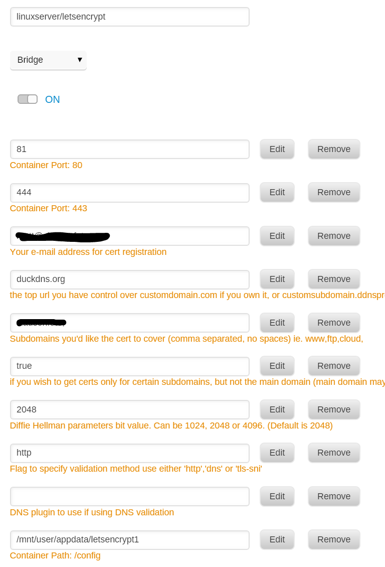

Hello all!
I have set up the letsencrypt docker, but when I try to access it via a web-browser on the local network I get an ERR_CONNECTION_REFUSED.
I am in the process of setting up Nextcloud using this guide.
The guide does not include the setup for letsencrypt, it assumes you have that already, so I am following this guide for a dynamic DNS letsencrypt reverse proxy (I think that's the correct terminology).
It uses DuckDNS to do the dynamic DNS.
If I run the following on the unRAID command line: tail -20 /var/log/nginx/error.log
I get the following:
2018/03/28 22:40:53 [error] 4246#4246: *41724 user "XXXXX" was not found in "/etc/nginx/htpasswd", client: 192.XXX.XXX.XXX, server: , request: "GET /Main HTTP/1.1", host: "192.XXX.XXX.YYY"
I dug around for an htpasswd file to look at, but couldn't find one, even when using Krusader to search all of /mnt.
According to the guide, I should be able to navigate to the letsencrypt installtion via server:81 and should see the following:
Attached is a log for the letsencrypt docker, a this is its run command:
root@localhost:# /usr/local/emhttp/plugins/dynamix.docker.manager/scripts/docker run -d --name='LETSENCRYPT-ReverseProxy-' --net='bridge' --privileged=true -e TZ="America/Los_Angeles" -e HOST_OS="unRAID" -e 'EMAIL'='[email protected]' -e 'URL'='duckdns.org' -e 'SUBDOMAINS'='quillnextcloud' -e 'ONLY_SUBDOMAINS'='true' -e 'DHLEVEL'='2048' -e 'VALIDATION'='http' -e 'DNSPLUGIN'='' -e 'PUID'='99' -e 'PGID'='100' -p '81:80/tcp' -p '444:443/tcp' -v '/mnt/user/appdata/letsencrypt':'/config':'rw' 'linuxserver/letsencrypt'
35d44450e249fec834b7849d1324df5a393bdc2d63e40ce3ee166d541094ed64
Can anyone provide some guidance?
letsencrypt log.txt
Link to comment

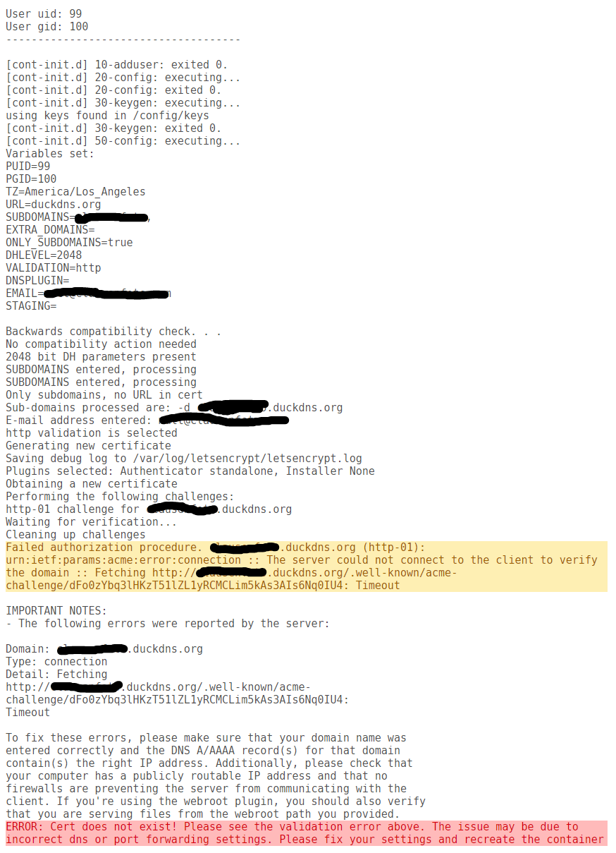

Failed authorization procedure. *****nextcloud.duckdns.org (http-01): urn:ietf:params:acme:error:connection :: The server could not connect to the client to verify the domain :: Fetching http://*****nextcloud.duckdns.org/.well-known/acme-challenge/pBh4tVjEdh2LbJ1O-PTVjE5gCs14g91uSp5JocABmm8: Timeout
IMPORTANT NOTES:
- The following errors were reported by the server:
Domain: *****nextcloud.duckdns.org
Type: connection
Detail: Fetching
Timeout
To fix these errors, please make sure that your domain name was
entered correctly and the DNS A/AAAA record(s) for that domain
contain(s) the right IP address. Additionally, please check that
your computer has a publicly routable IP address and that no
firewalls are preventing the server from communicating with the
client. If you're using the webroot plugin, you should also verify
that you are serving files from the webroot path you provided.
ERROR: Cert does not exist! Please see the validation error above. The issue may be due to incorrect dns or port forwarding settings. Please fix your settings and recreate the container
That's why it's not working.  Sure your router ports are setup correctly?

42 minutes ago, Ruthalas said:
Hello all!
letsencrypt log.txt
"If I run the following on the unRAID command line: tail -20 /var/log/nginx/error.log"
That is not the log of this container's nginx. That is the unraid web interface's log. The container app logs are in your /config folder
"According to the guide, I should be able to navigate to the letsencrypt installtion via server:81 and should see the following:"
You need to visit https://yoursubdomain.duckdns.org to visit the interface since that is the address your cert covers. If your router blocks access to it from your lan due to nat loopback, try it from a cell phone over cellular connection to test.
If you're still confused, you should post in the thread for the external guide.

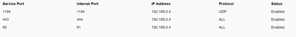

My port forwarding looks like this:
I believe that is appropriate for the docker, as the docker is configured like so:
Does anything seem to be awry there?
Thanks for the clarification!
The docker-specific log is attached to the first post.
When I try from outside the local network I get ERR_CONNECTION_RESET.
I belive the port forwarding is appropriately configured (see above).
I will post in the external help next if you feel that is a better option.
Edited by Ruthalas
Link to comment

3 minutes ago, jonathanm said:
To which web server? Docker or router? Who is your ISP? Are you sure they don't block port 80?
When requesting the page from outside the local network, the prefix 'https://' must be used.
Comcast is my ISP.
It does not appear that they are blocking port 80, as I can now access the base letsencrypt page externally.
Link to comment
Comcast is my ISP.
Your initial logs showed no certificate was generated.  Seems that has been resolved.  It's working fine now, out the box, nginx isn't configured to respond on port 80 (http)
A lot of this could have been avoided by looking at the logs.  Would have helped remove a lot of guesswork, but at least you got it working.
Link to comment

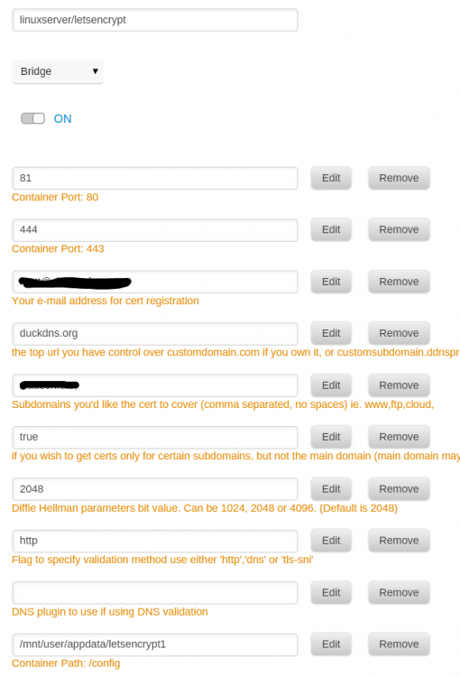

@clause I am having the exact same issue recently. Used to work just fine, now I get that error.
For some reason, sub-domains is activated and stuck upon updating container. I had to completely remove the option, and re-remove it after each update, for cert generation to work.
Edited by d2dyno
Link to comment
What do you mean by sub-domains activated and stuck?
Did you forget to forward port 80 on your router?
