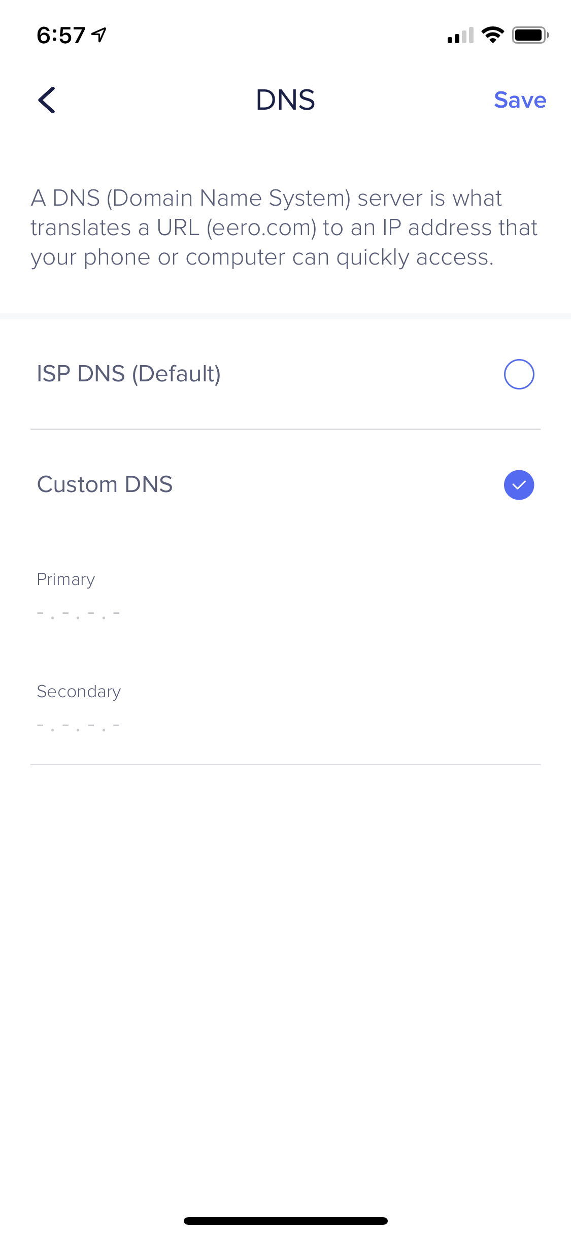

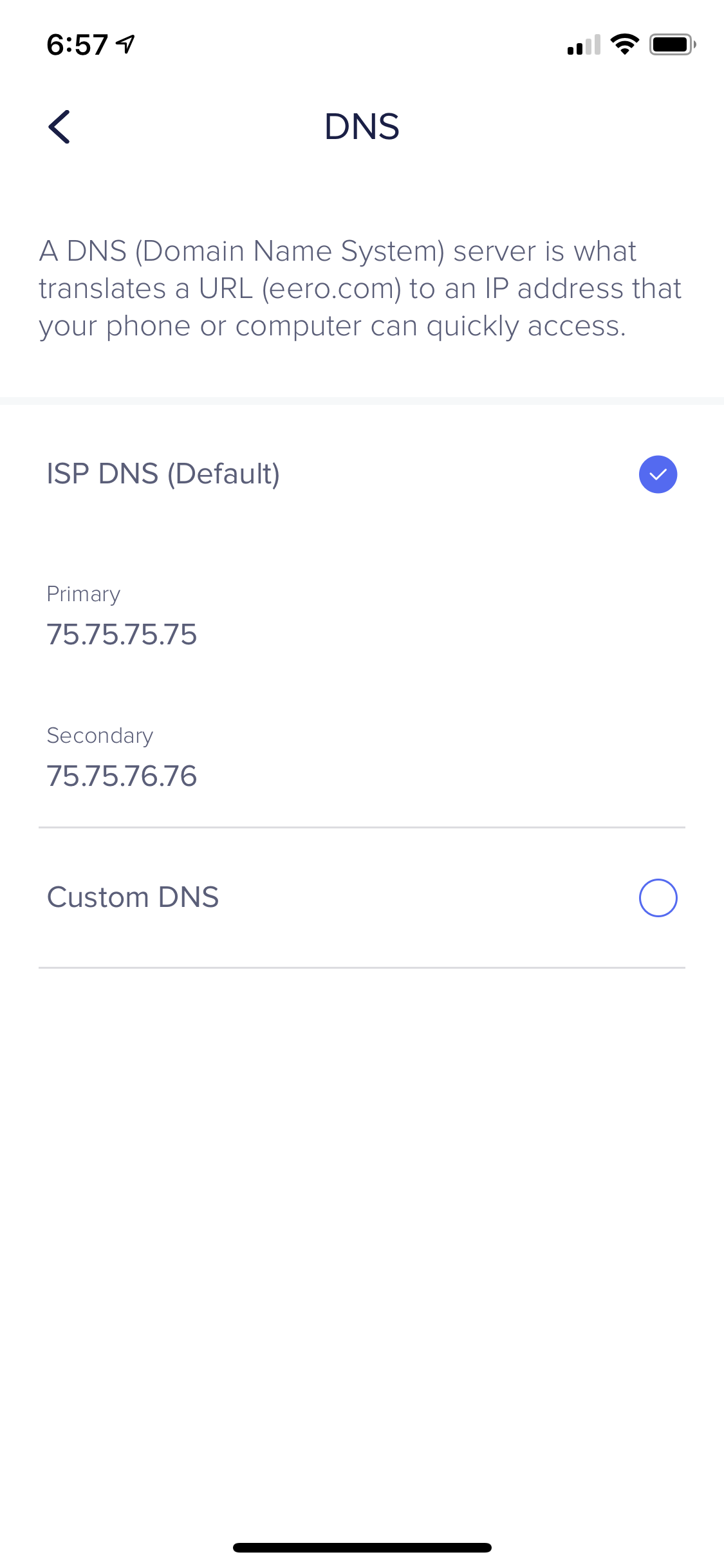

February 12, 20197 yr 10 minutes ago, jonathanm said: Override the DNS entry on your local machines to point the domain to the correct IP. I find it difficult to believe that your router won't let you set a custom DNS entry, but if not, then you can set it in the hosts file on the local machine. I actually just looked at this and it allows me to do a custom DNS entry but sort of confused as the network aspect of things is not my area expertise. If I make the custom DNS change on the router, how would you do this correctly? How would I make this change? Below are screen captures of my route configuration pages for DNS. The first capture is the default directed to the ISP. The second capture is if I click on custom. Edited February 12, 20197 yr by JohnSracic
February 12, 20197 yr 13 minutes ago, JohnSracic said: I actually just looked at this and it allows me to do a custom DNS entry Yeah, that's not the change you need to make. I took a look at eero, and apparently you are not alone in your issues. I don't see any way to do that in your router, it's going to have to be changed in your local machines hosts file. As to why it worked before and now it doesn't, I suspect the eero did an update and broke nat reflection. Some routers have the feature without it being configurable.
February 12, 20197 yr 25 minutes ago, jonathanm said: Yeah, that's not the change you need to make. I took a look at eero, and apparently you are not alone in your issues. I don't see any way to do that in your router, it's going to have to be changed in your local machines hosts file. As to why it worked before and now it doesn't, I suspect the eero did an update and broke nat reflection. Some routers have the feature without it being configurable. I did the initial search last evening once I seen your post and seen what you did. Then looked at it this morning and seen the custom DNS and thought that may work. I’m pretty surprised that eero does not support this since the hardware is $500. From what I have read, it’s been an issue for 2+ years with no timeline or if they are going to include it. Would love to just throw it out and buy something different but the wife would not be happy. The more I get into network changes and the unraid dockers, it appears the eero does not have a lot of the advanced network settings. Regardless, thank you for your help with this. I understand the local machine hosts file. How would you make the change on iPhones and iPads? Edited February 12, 20197 yr by JohnSracic
February 12, 20197 yr 1 hour ago, JohnSracic said: I did the initial search last evening once I seen your post and seen what you did. Then looked at it this morning and seen the custom DNS and thought that may work. I’m pretty surprised that eero does not support this since the hardware is $500. From what I have read, it’s been an issue for 2+ years with no timeline or if they are going to include it. Would love to just throw it out and buy something different but the wife would not be happy. The more I get into network changes and the unraid dockers, it appears the eero does not have a lot of the advanced network settings. Regardless, thank you for your help with this. I understand the local machine hosts file. How would you make the change on iPhones and iPads? Kind of an advanced trick so don't expect any further support from me, but you could potentially use a separate dns server like pi-hole where you would tell eero to use that as a custom dns. Pi-hole is more configurable. It seems this guy did just that: https://discourse.pi-hole.net/t/redirect-dyndns-conditionally-no-nat-loopback-owncloud/2846

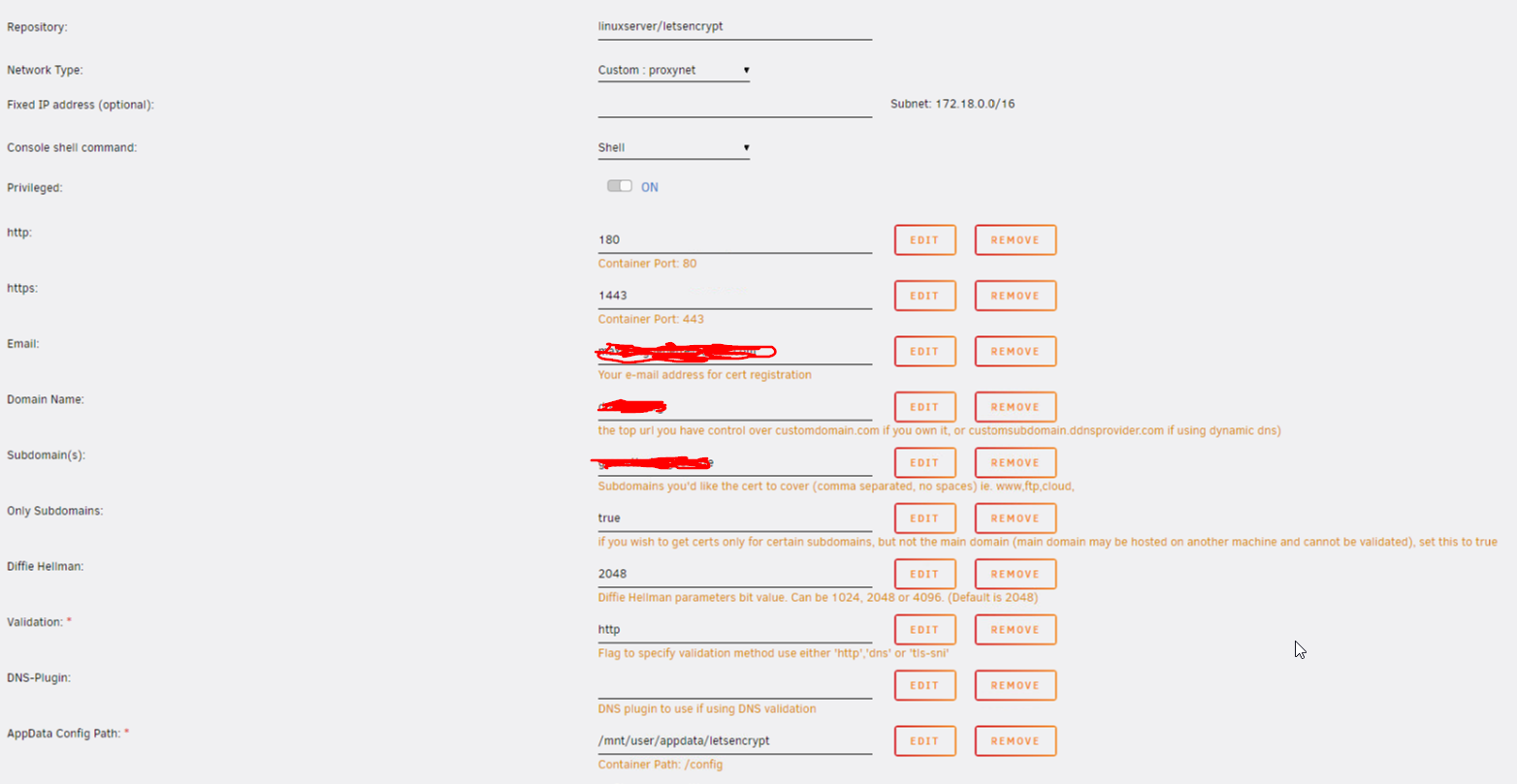

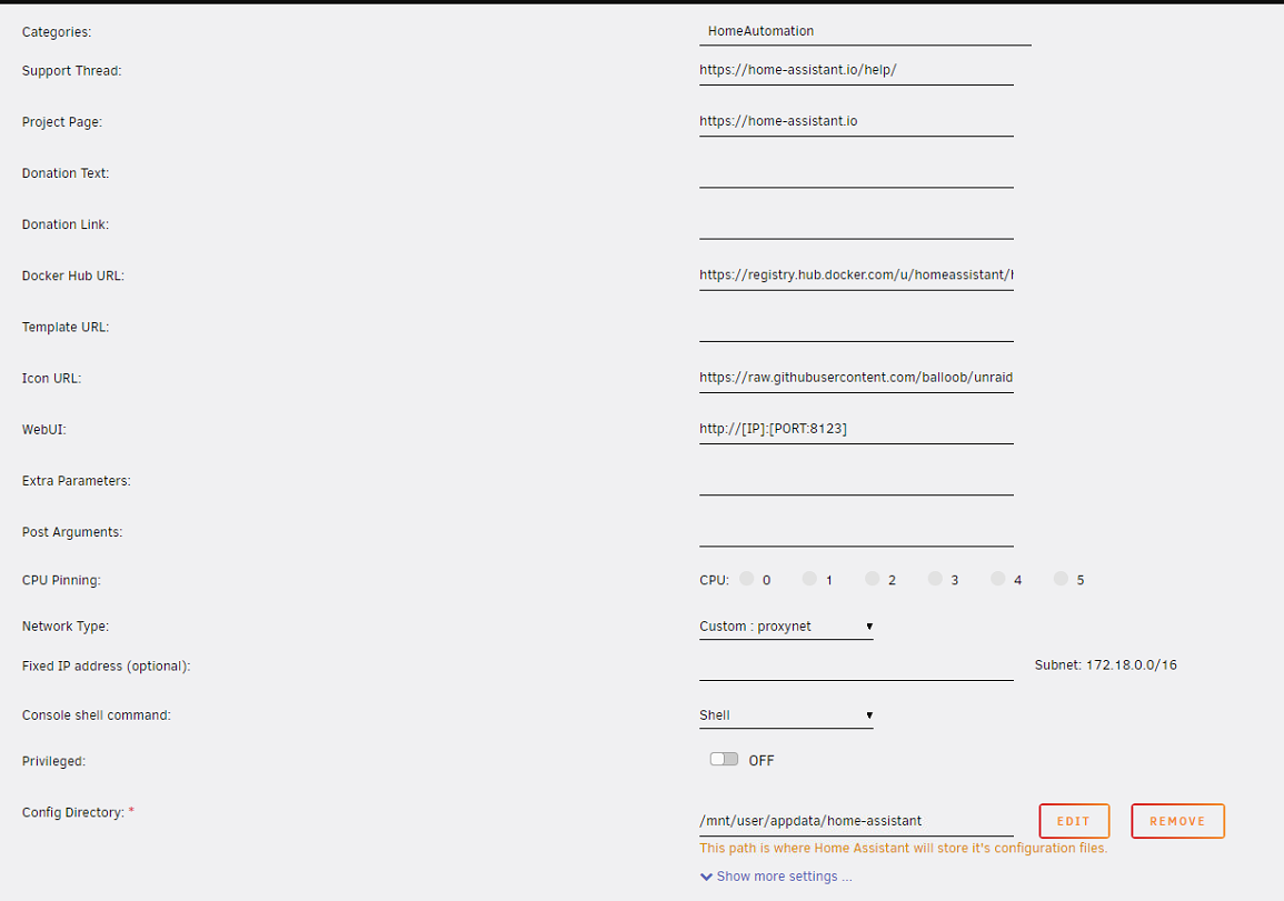

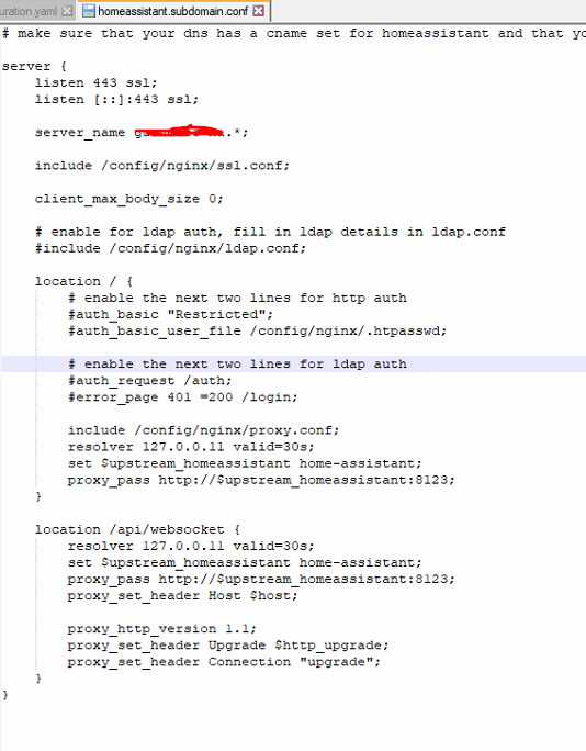

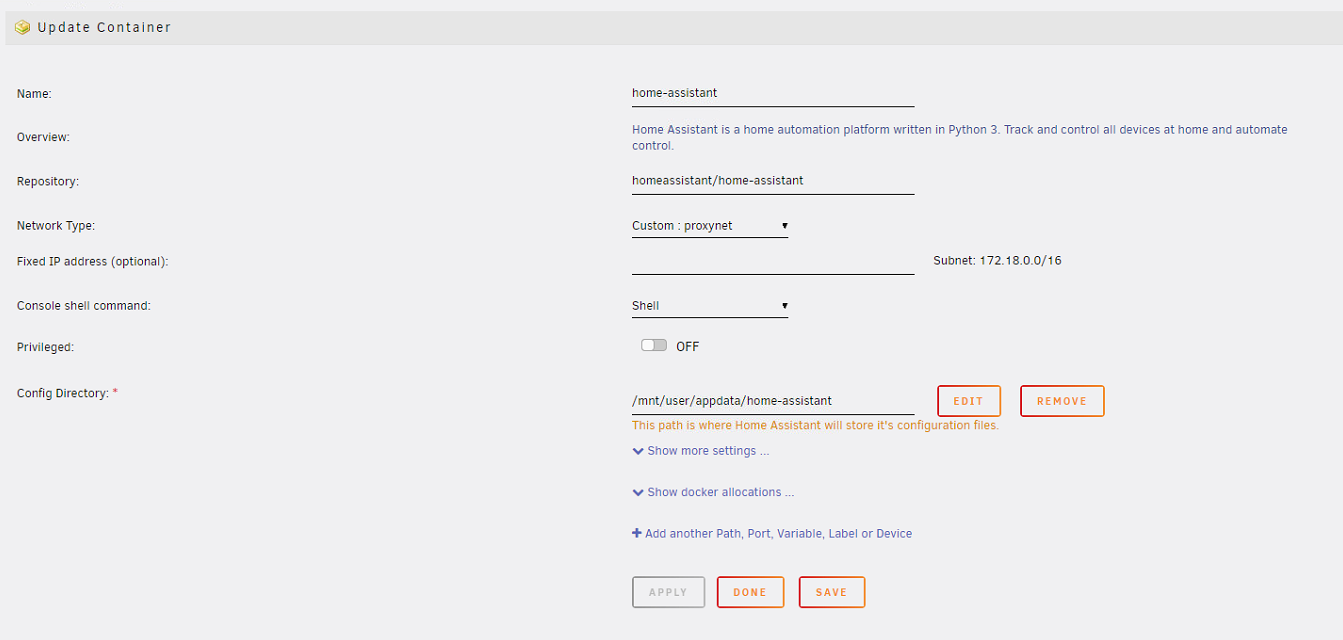

February 14, 20197 yr Hello, I need your help to figure this out. I installed the plugin following Spaceinvader One youtube video. At first, I wanted access to my Home-Assistant (unraid Docker) from the outside. It work!!! When I try to connect using the server IP 192.168.2.XXX:8123 (Home assistant port) it dosent work. (Local Network) I tried to connect NodeRed (unraid Docker) to Home-Assistant container, same issue, no connection. (Local Network) Do you have an idea what the problem? Should I modified / add something in the nginx config file (see attached)? For info, I created a network called Proxynet (like spaceinvader video). Thanks for your help! I'm lost... Max
February 14, 20197 yr Hello, I need your help to figure this out. I installed the plugin following Spaceinvader One youtube video. At first, I wanted access to my Home-Assistant (unraid Docker) from the outside. It work!!! When I try to connect using the server IP 192.168.2.XXX:8123 (Home assistant port) it dosent work. (Local Network) I tried to connect NodeRed (unraid Docker) to Home-Assistant container, same issue, no connection. (Local Network) Do you have an idea what the problem? Should I modified / add something in the nginx config file (see attached)? For info, I created a network called Proxynet (like spaceinvader video). Thanks for your help! I'm lost... MaxHi SpeedmaxFor local access you are not going through nginx. When you use 192.168.*.* the settings you need to look at are your docker container port mapping. Can you share the docker config?Sent from my SM-G930W8 using Tapatalk
February 14, 20197 yr 17 minutes ago, speedmax1979 said: I took a picture with advance view on. It looks like you are not exposing any ports to the outside. It works for nginx because the traffic goes through proxynet, the custom network interface. In HomeAutomation, add a port mapping with the + at the bottom of the container settings. Map 8123 to 8123. You are telling the docker to let requests that hit your unraid server on port 8123 to let that through the HomeAutomation container on port 8123.
February 14, 20197 yr 9 minutes ago, Gog said: It looks like you are not exposing any ports to the outside. It works for nginx because the traffic goes through proxynet, the custom network interface. In HomeAutomation, add a port mapping with the + at the bottom of the container settings. Map 8123 to 8123. You are telling the docker to let requests that hit your unraid server on port 8123 to let that through the HomeAutomation container on port 8123. May you show me a config for example? Not sure how to do this... I'm pretty new with docker stuff. But.. I like this!!!
