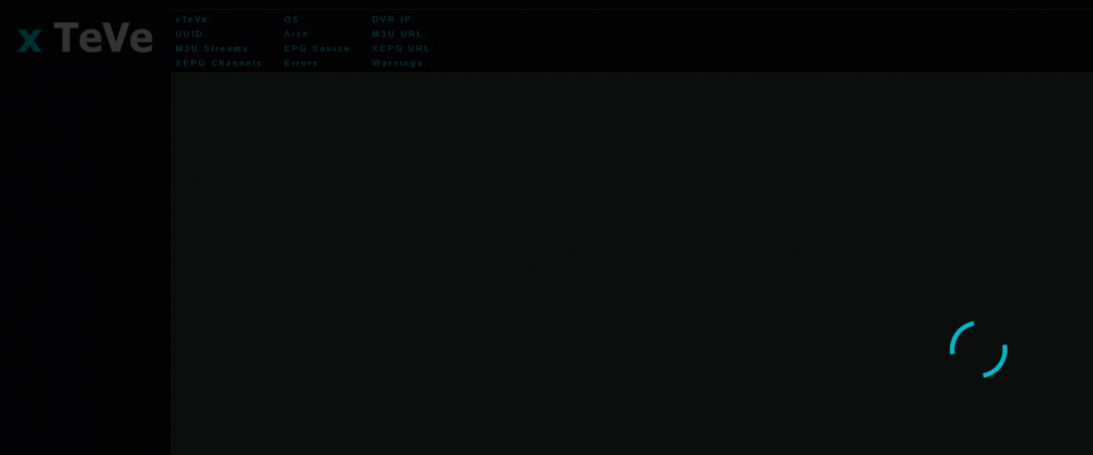

Hi, may someone has a hint how to get the xteve site working behind reverse proxy
when i curl the sitenames (local 192.168...../web or my.domain/web) the result is exactly the same, so there are no differences.
the symptom when using the external domain is an endless loading spinner on the site
here a respond from curl in case that could help

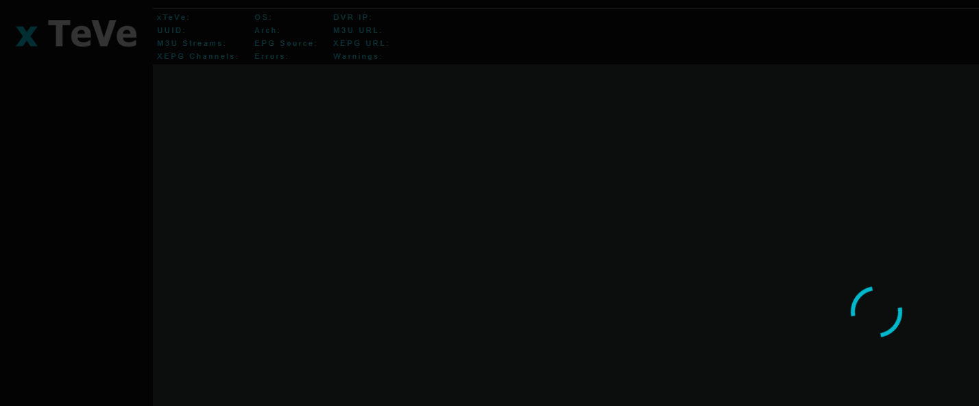

screenshot from spinner (site started loading but doesnt go further)
and here the reverse proxy conf part yet (it was simpler, but i tried adding all kinda things i readed across the web.

in case someone has a idea, thanks ahead ;)
