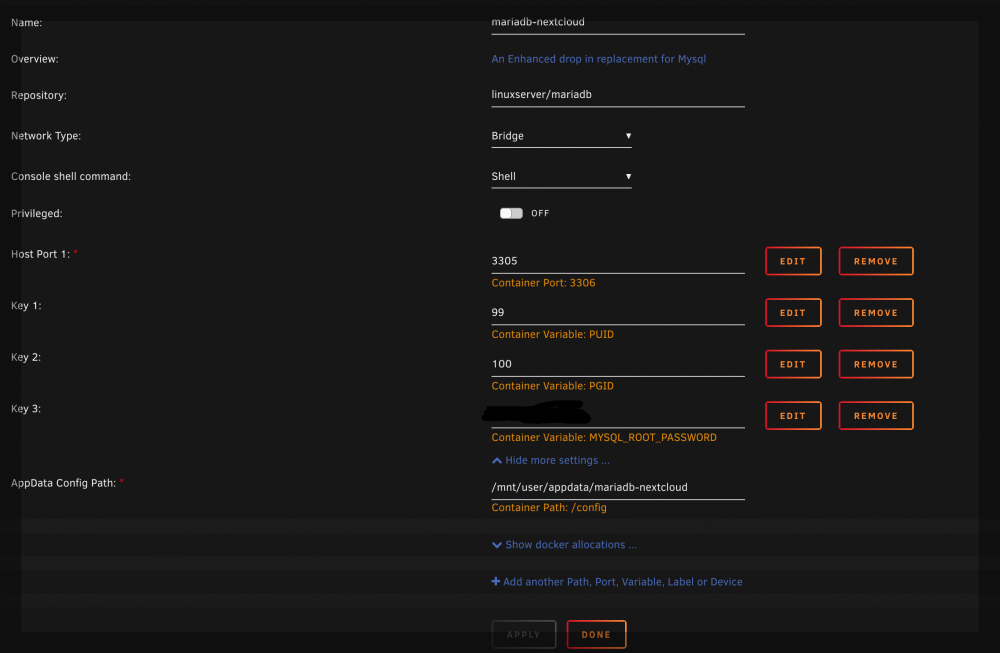

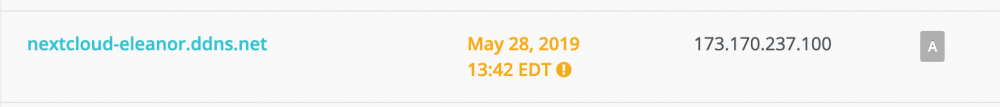

Hey Guys,
I need some help. I am getting this on the logs for letsencrypt. Two errors. I have followed Spaceinvader and Techcoreduo and i cant get it to work outside my network.

Hey Guys,

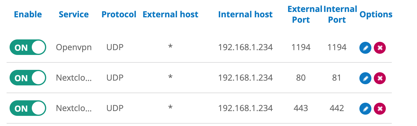

Yeah he should use tcp for 80 and 443 and is the reason for the issues.
@Tucubanito07
The errors you have is harmless as said on the last couple of pages. Change your port forwards to use tcp as Tupac says above, and you should be closer to get it working.
Link to post
@Tucubanito07

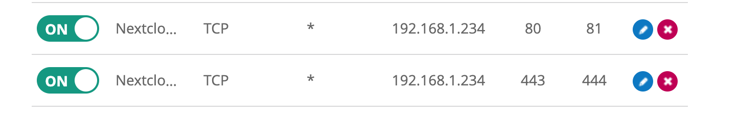

So change my router to port forward to 80 and 443 ?
Link to post
Probably be a good place to start. May have to reference back through SpaceInvaders videos, he shows how to set it up and you can figure our where yours is broke.

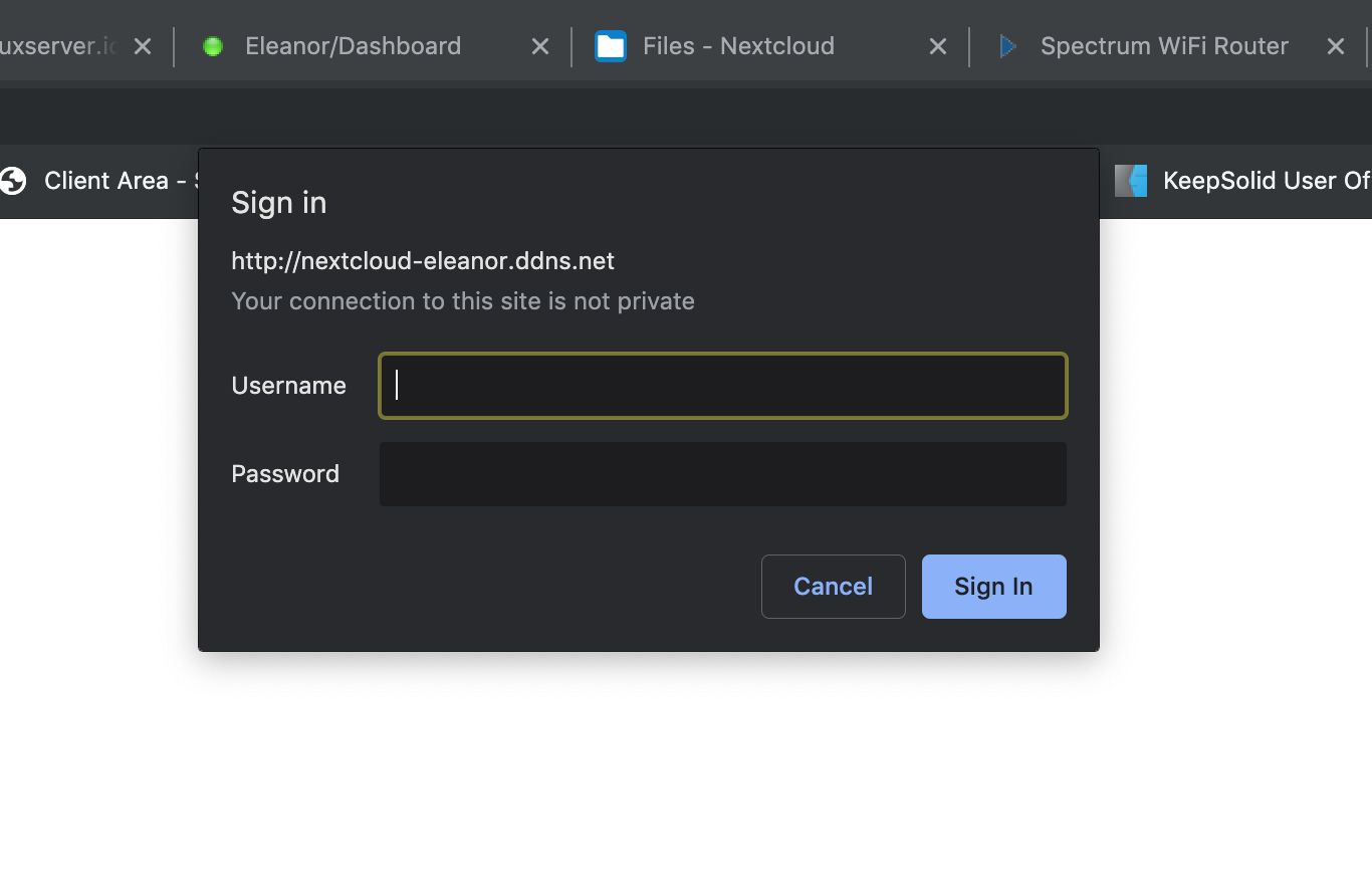

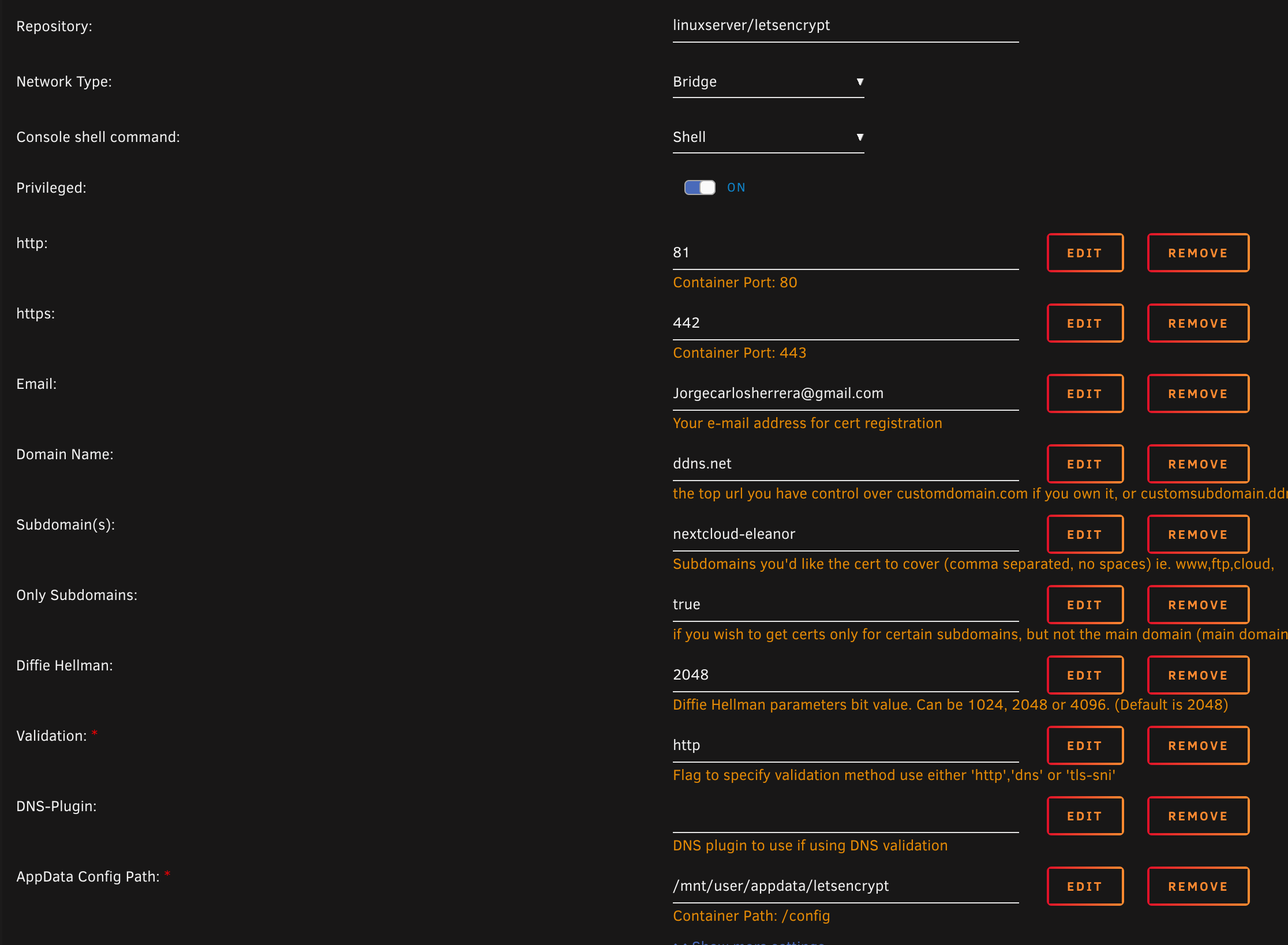

after i port forwarded to tcp 80 and 443 i get this screen. I have input the password and it does not go in.
Link to post
1167296982_ScreenShot2019-05-29at12_13_14PM.thumb.png.680d693992c801c6c7bde84da41d5d41.png
I think that's forwarding to your unraid server directly?
Sent from my Pixel 2 XL using Tapatalk
Link to post

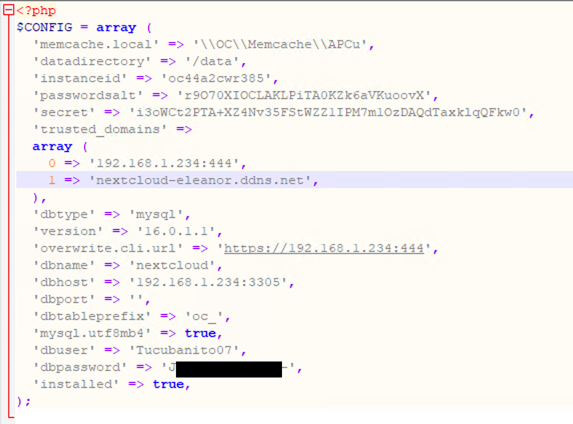

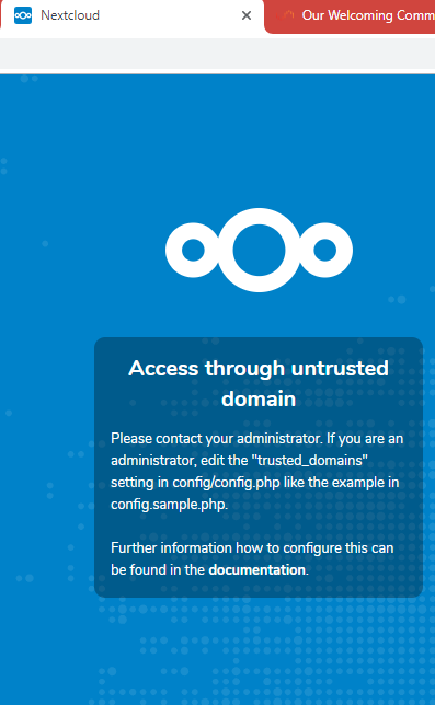

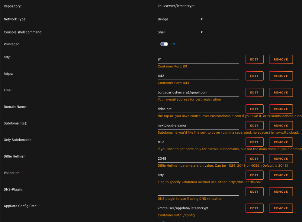

I believe that is what it is. So i change it to this and this is what i get now.
851086489_ScreenShot2019-05-29at12_21_42PM.thumb.png.18ee0110236dcdf70306b7bcba63e3d2.png
280283802_ScreenShot2019-05-29at12_21_32PM.thumb.png.5304eda2bdf2f66406914889fc9b9b04.png
Cool. So we are im busines now. Look at the link you have.
It's https but then going to port 80. Is wrong

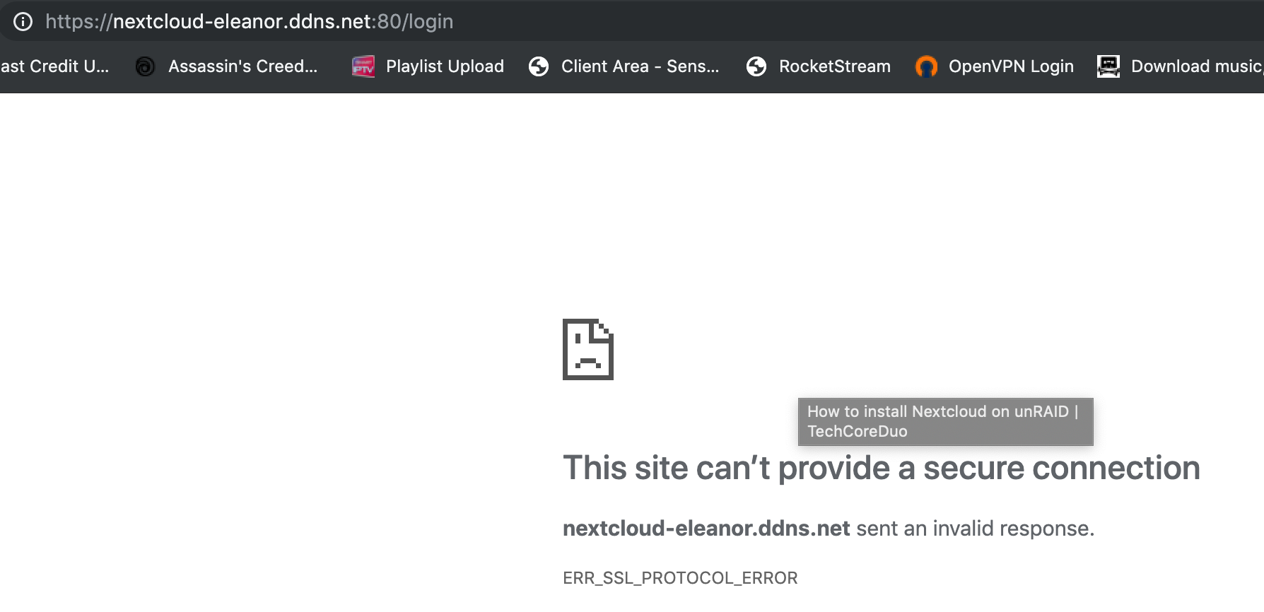

Where do I need to look or change for this specific error? Thank you guys for the help. Really appreciated a lot.
Link to post
Honestly,
Check both config files. Because it's redirecting somewhere else. If I go to the website it redirects me to https://nextcloud-eleanor.ddns.net:80/login
But If I type your public IP address in the browser. (Which I'm not going to type for security)
I get this
I think you gotta fix some security issues in your router, my friend.
That should be hitting the nginx webserver built in let's encrypt not straight to your nextcloud.
Please someone correct me if I'm wrong. I might be mistaken

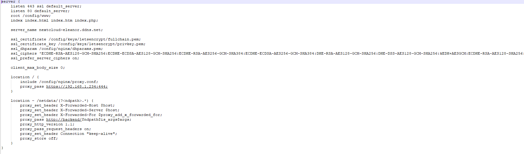

31 minutes ago, gacpac said:
Honestly,
I get this

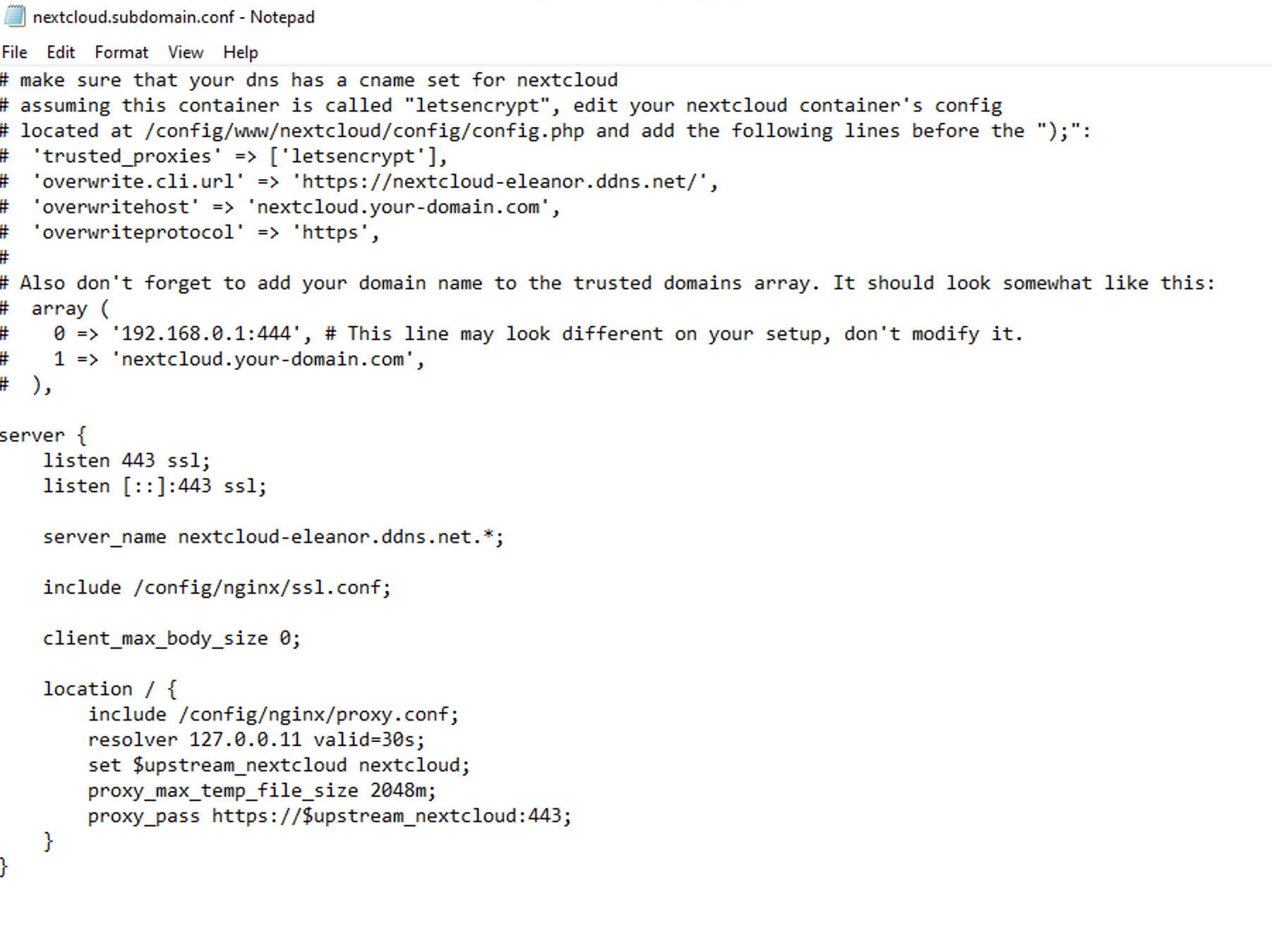

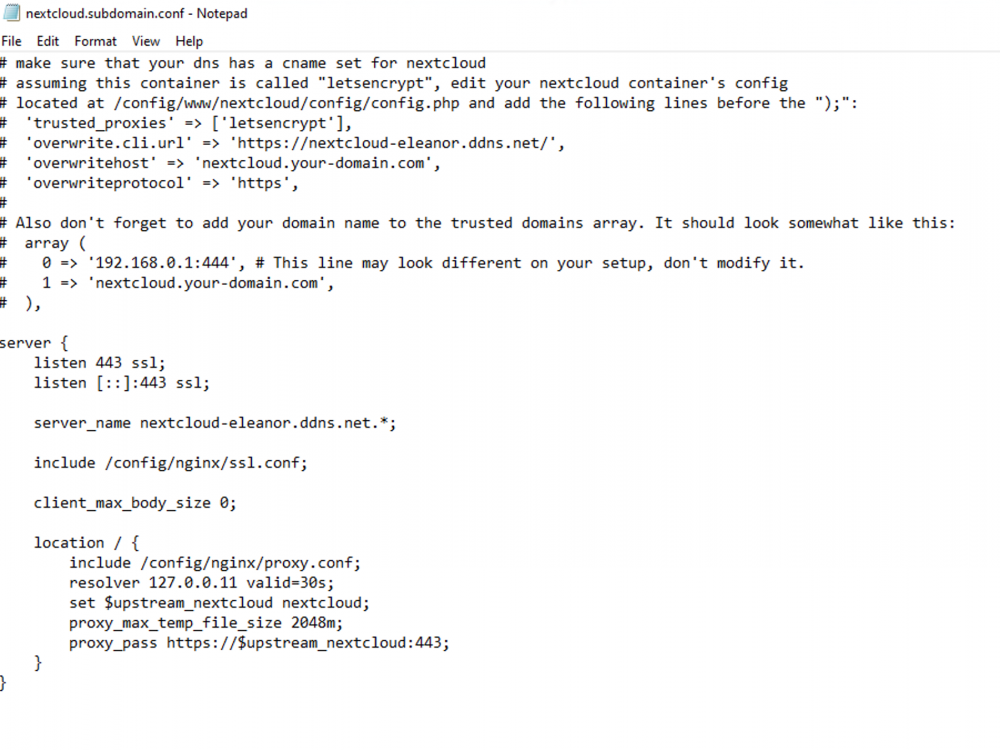

This is how it looks.
