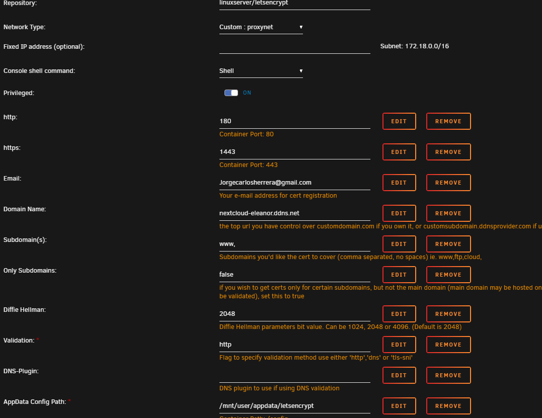

@Tucubanito07 Here's what happens
1.  You open the relevant ports on your router - you now have that correct
2.  You start the LetsEncrypt container and it tries to grab certs
3.  If certs are grabbed successfully Nginx starts up
4.  Then you can setup Nextcloud and the reverse proxy side of things
5.  Then once that's setup it should all work.
Problem is you're failing at step 1 and 2 and keep looking to step 5 to see if it's working.
I'll be leaving this to the captain. Going to bed here, and I'm one hour ahead of the captain!
Just now, CHBMB said:
@Tucubanito07
Where's the docker run command as I requested that's the log only.
@CHBMB
I dont know what you mean by this? I am sorry.
@saarg Thank you so much for all your help. I really appreciated.
URL=ddns.net
SUBDOMAINS=nextcloud-eleanor
EXTRA_DOMAINS=
ONLY_SUBDOMAINS=true
This is how it should be configured.
You don't own the www.ddns.net url so you can't grab a cert for it.
The captain posted  a link to the docker run command! Read what we post carefully and do not skim through it.
Actually ignore me.
It should be:
URL=nextcloud-eleanor.ddns.net
SUBDOMAINS=
EXTRA_DOMAINS=
ONLY_SUBDOMAINS=false
Edited by CHBMB
2 minutes ago, CHBMB said:
Actually ignore me.
It should be:
SUBDOMAINS=
EXTRA_DOMAINS=
I get this.

Here is the run commands.
Stopping container: letsencrypt
Successfully stopped container 'letsencrypt'
Removing container: letsencrypt
Successfully removed container 'letsencrypt'
Command:root@localhost:# /usr/local/emhttp/plugins/dynamix.docker.manager/scripts/docker run -d --name='letsencrypt' --net='proxynet' --privileged=true -e TZ="America/Los_Angeles" -e HOST_OS="Unraid" -e 'EMAIL'='[email protected]' -e 'URL'='nextcloud-eleanor.ddns.net' -e 'SUBDOMAINS'='www,' -e 'ONLY_SUBDOMAINS'='false' -e 'DHLEVEL'='2048' -e 'VALIDATION'='http' -e 'DNSPLUGIN'='' -e 'PUID'='99' -e 'PGID'='100' -p '180:80/tcp' -p '1443:443/tcp' -v '/mnt/user/appdata/letsencrypt':'/config':'rw' 'linuxserver/letsencrypt'
cb65e171d30113fc7312b3241d0581262f56262d4b9d7d63544f3b78bec704e5
The command finished successfully!
Would help if you actually did what I asked.....
From your logs:
SUBDOMAINS=www,
EXTRA_DOMAINS=
And shown on your screenshot.  Look, I'm not being funny here, but it would help if you actually read things properly.  STOP POSTING screenshots

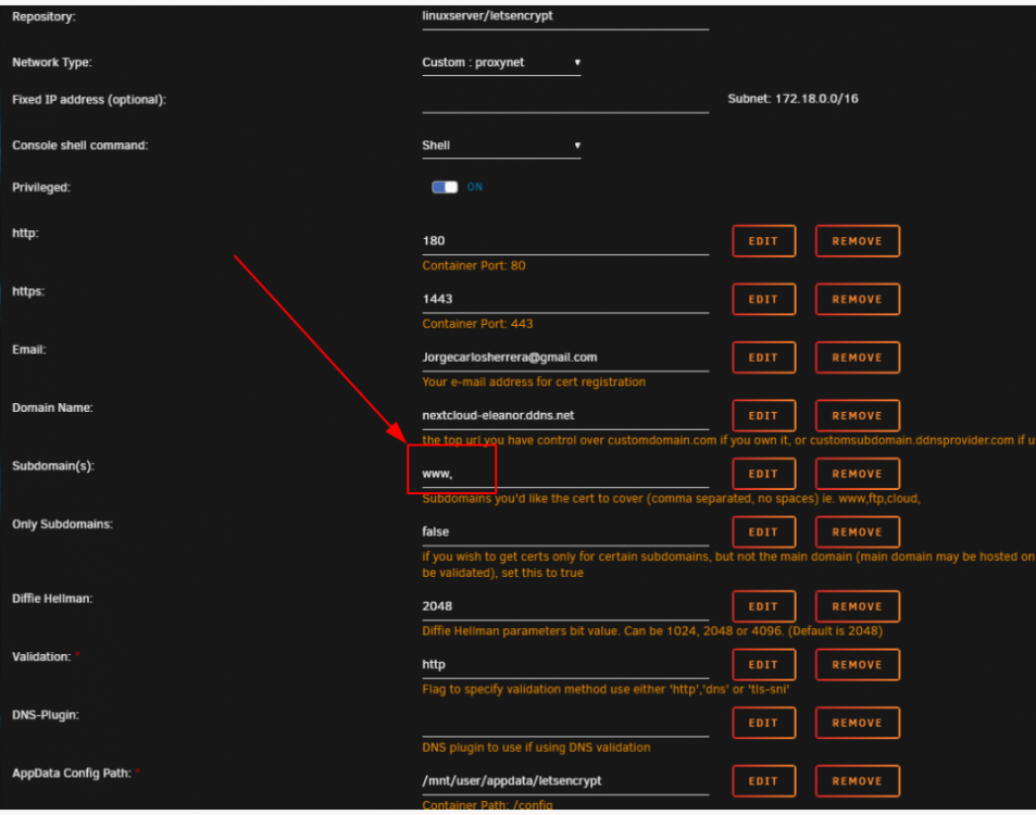

The issue is that the docker command being run (repeatedly) is wrong and they're trying to grab a cert for www.
@Tucubanito07
Maybe pics will work better.  Delete this....
@Tucubanito07
I have deleted that. It comes back on.

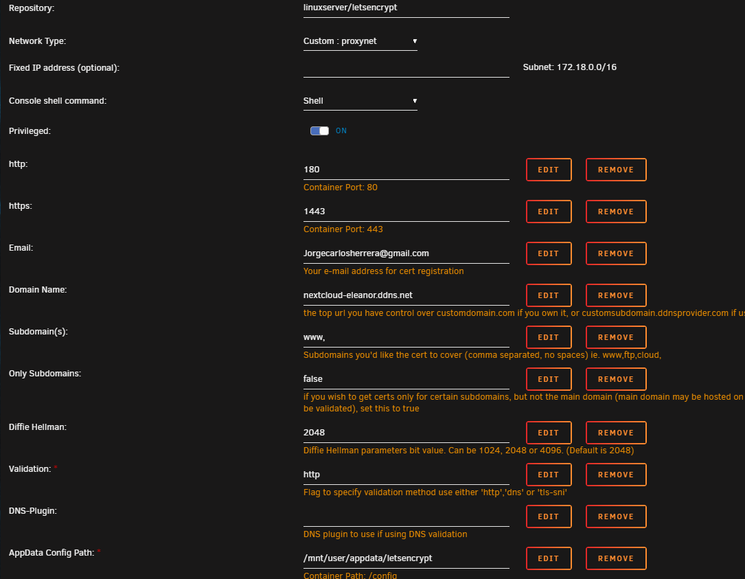

here is the run command.
e5081d19dbc0afdbd47d1c43b71d2b216bdebf6a994012df2685ffa8c53a2b28

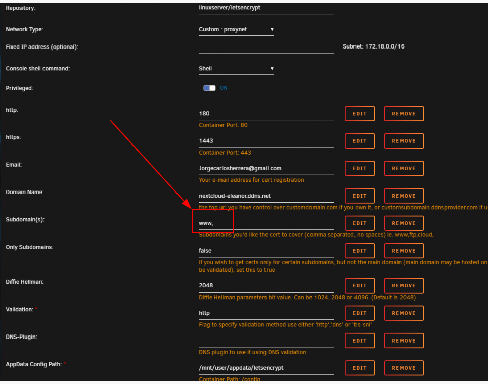

[mention=78975]Tucubanito07[/mention]
Sorry, again, but yeah makes sense sir. (I just followed SIOs YT guide & changed a few things I needed different/specific; not sure how this has been worked into such a conundrum LOL). Thank your elaboration with me [emoji106] I'll just watch and learn [emoji16][emoji106]
Sent from my SM-G975U using Tapatalk
Wouldn't it be on a config file on letsencrypt that is adding the www, you are telling me to delete. Which i have it just keeps coming back. @CHBMB

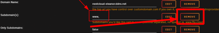

@Tucubanito07
See the box named REMOVE, click it.  The one next to the Subdomain line
I did that and now i am getting this.
nginx: [emerg] PEM_read_bio_DHparams("/config/nginx/dhparams.pem") failed (SSL: error:0909006C:PEM routines:get_name:no start line:Expecting: DH PARAMETERS)
Here is the run command.
Command:root@localhost:# /usr/local/emhttp/plugins/dynamix.docker.manager/scripts/docker run -d --name='letsencrypt' --net='proxynet' --privileged=true -e TZ="America/Los_Angeles" -e HOST_OS="Unraid" -e 'EMAIL'='[email protected]' -e 'URL'='nextcloud-eleanor.ddns.net' -e 'ONLY_SUBDOMAINS'='false' -e 'DHLEVEL'='2048' -e 'VALIDATION'='http' -e 'DNSPLUGIN'='' -e 'PUID'='99' -e 'PGID'='100' -p '180:80/tcp' -p '1443:443/tcp' -v '/mnt/user/appdata/letsencrypt':'/config':'rw' 'linuxserver/letsencrypt'
761c925c49e1f090e6f5d58214d586fb40ff1df29b4c88d8ecbd8fc6b8e668b6
