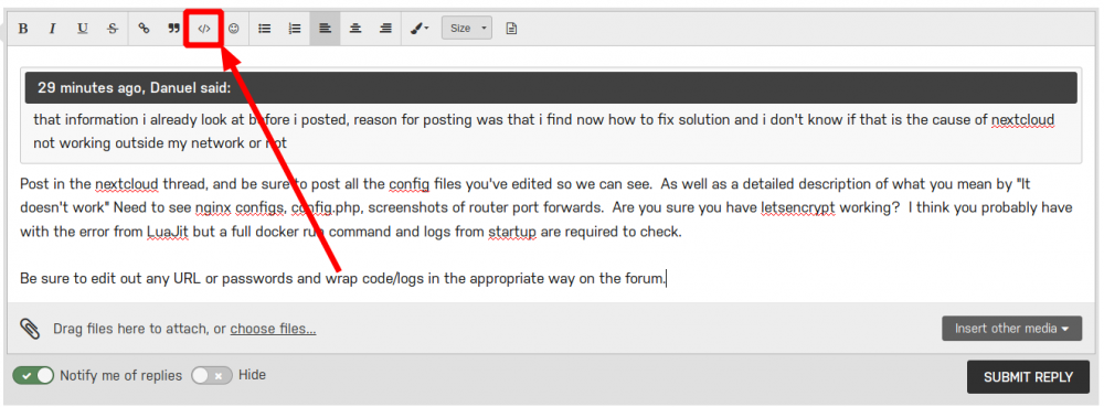

Post in the nextcloud thread, and be sure to post all the config files you've edited so we can see.  As well as a detailed description of what you mean by "It doesn't work" Need to see nginx configs, config.php, screenshots of router port forwards.  Are you sure you have letsencrypt working?  I think you probably have with the error from LuaJit but a full docker run command and logs from startup are required to check.
Be sure to edit out any URL or passwords and wrap code/logs in the appropriate way on the forum.2019-06-02_15-16.thumb.png.c2b056989012233b2ac0f5b88c9c265d.png

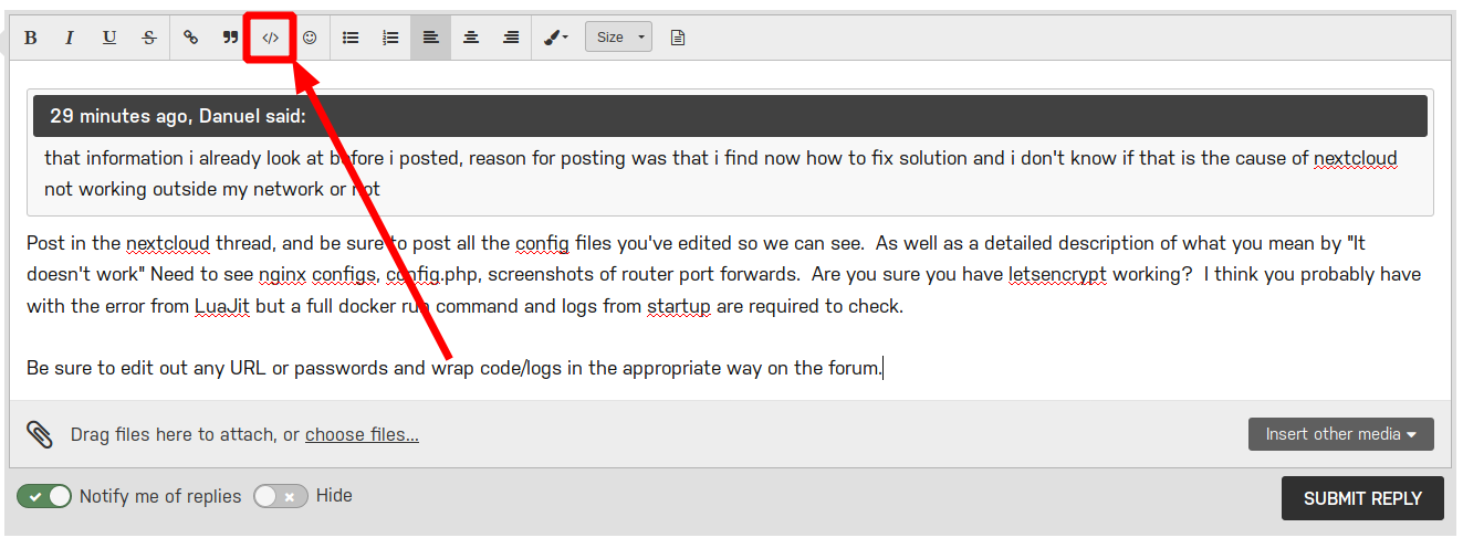

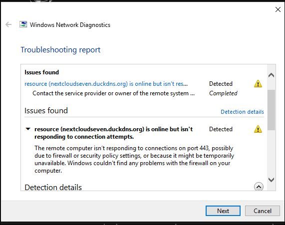

so, what i found was that i was able to acess outside my network using my mobile phone on 4G or using VPN, but not from my local network (using the domain name), i am getting this, is this normal ? i can access nextcloud using local IP because i did not set 'overwritehost' => 'my domain' so i can use local ip, so why i can't access from my LAN using 'my domain' ?
NAT reflection or Loopback NAT, same problem @Tucubanito07 has on the last page or two.
I want to let you guys know i got it working. I bought the Netgear Nighthawk X65 AC4000 Model #R8000P and it works like a charm. I am able to see nextcloud from my WAN and also on my LAN. Sucks i had to buy a new router but i needed one anyways so kind of workout. Thanks again @CHBMB
