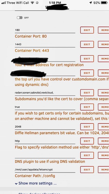

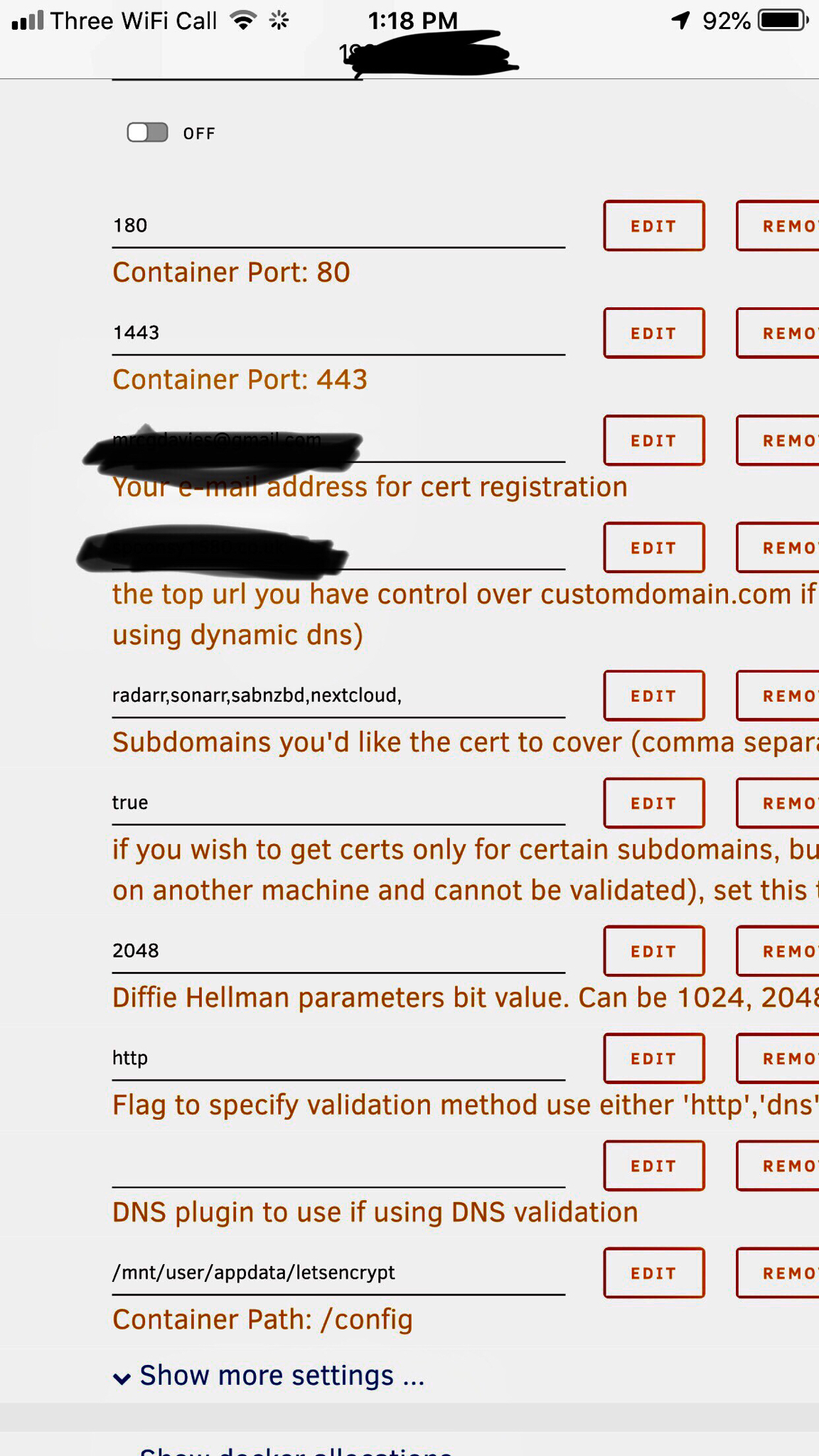

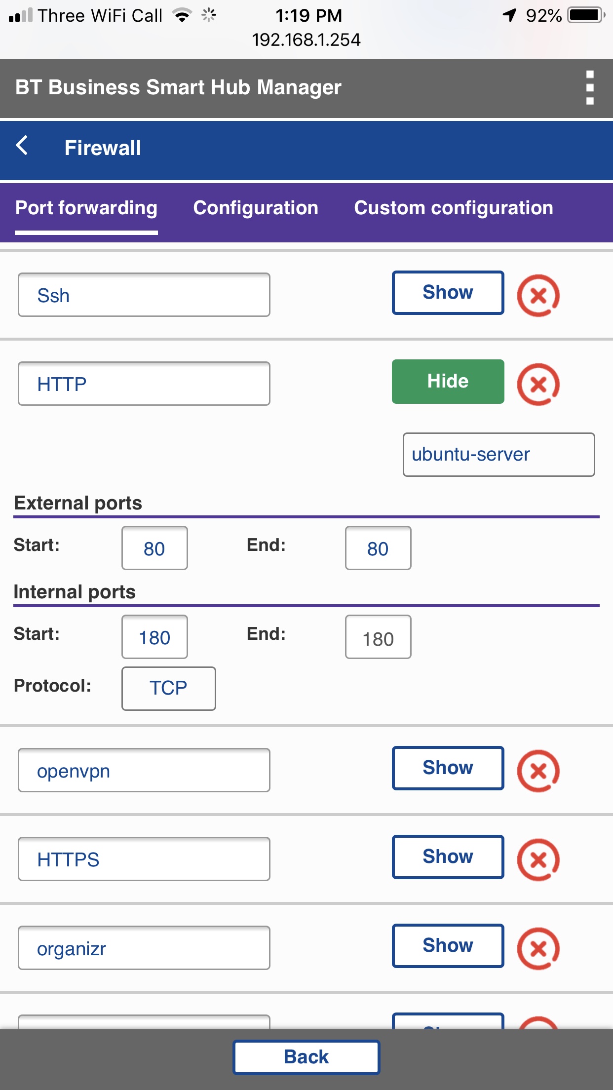

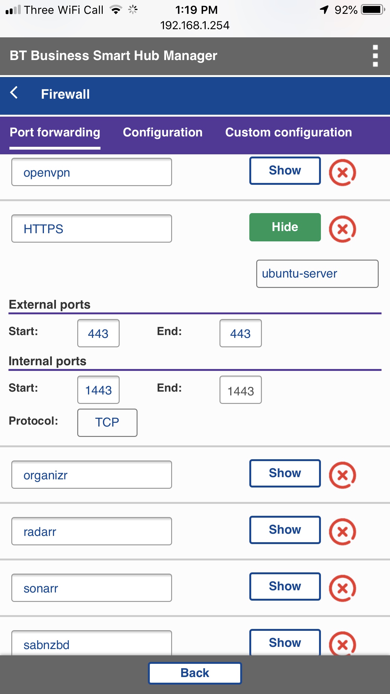

Help please - my cert won't renew.  It's been so long since I've had problems with LE I can't work out how to fix:
Brought to you by linuxserver.io
We gratefully accept donations at:
https://www.linuxserver.io/donate/
GID/UID
User uid: 99
User gid: 100
[cont-init.d] 10-adduser: exited 0.
[cont-init.d] 20-config: executing...
[cont-init.d] 20-config: exited 0.
[cont-init.d] 30-keygen: executing...
using keys found in /config/keys
[cont-init.d] 30-keygen: exited 0.
[cont-init.d] 50-config: executing...
Variables set:
PUID=99
PGID=100
TZ=Europe/London
URL=MyDOMAIN.com
SUBDOMAINS=www,unifi,ha,nextcloud,office,home,heimdall
EXTRA_DOMAINS=
ONLY_SUBDOMAINS=false
DHLEVEL=2048
VALIDATION=http
DNSPLUGIN=
[email protected]
STAGING=
2048 bit DH parameters present
SUBDOMAINS entered, processing
Sub-domains processed are: -d www.MyDOMAIN.com -d unifi.MyDOMAIN.com -d ha.MyDOMAIN.com -d nextcloud.MyDOMAIN.com -d office.MyDOMAIN.com -d home.MyDOMAIN.com -d heimdall.MyDOMAIN.com
E-mail address entered: [email protected]
