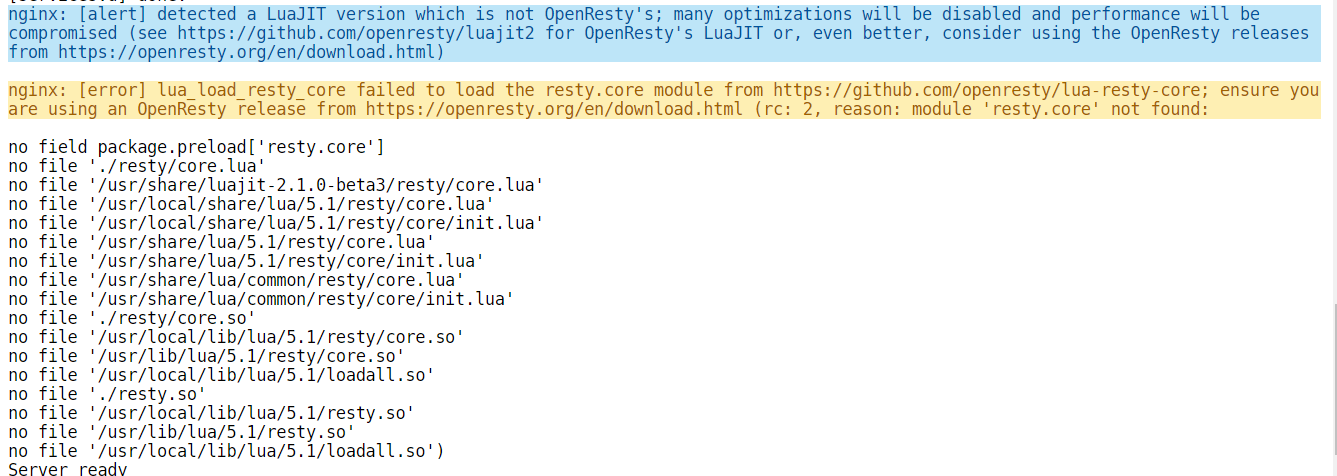

http-01 challenge for nowshowing.mydomain.com
http-01 challenge for sonarr.mydomain.com
http-01 challenge for tautulli.mydomain.com
Waiting for verification...
Cleaning up challenges
IMPORTANT NOTES:
- Congratulations! Your certificate and chain have been saved at:
/etc/letsencrypt/live/tautulli.mydomain.com/fullchain.pem
Your key file has been saved at:
/etc/letsencrypt/live/tautulli.mydomain.com/privkey.pem
Your cert will expire on 2019-09-17. To obtain a new or tweaked
version of this certificate in the future, simply run certbot
again. To non-interactively renew *all* of your certificates, run
"certbot renew"
- Your account credentials have been saved in your Certbot
configuration directory at /etc/letsencrypt. You should make a
secure backup of this folder now. This configuration directory will
also contain certificates and private keys obtained by Certbot so
making regular backups of this folder is ideal.
- If you like Certbot, please consider supporting our work by:
Donating to ISRG / Let's Encrypt: https://letsencrypt.org/donate
Donating to EFF: https://eff.org/donate-le
New certificate generated; starting nginx
[cont-init.d] 50-config: exited 0.
[cont-init.d] 99-custom-files: executing...
[custom-init] no custom files found exiting...
[cont-init.d] 99-custom-files: exited 0.
[cont-init.d] done.
[services.d] done.
nginx: [alert] detected a LuaJIT version which is not OpenResty's; many optimizations will be disabled and performance will be compromised (see https://github.com/openresty/luajit2 for OpenResty's LuaJIT or, even better, consider using the OpenResty releases from https://openresty.org/en/download.html)
nginx: [error] lua_load_resty_core failed to load the resty.core module from https://github.com/openresty/lua-resty-core; ensure you are using an OpenResty release from https://openresty.org/en/download.html (rc: 2, reason: module 'resty.core' not found:
no field package.preload['resty.core']
no file './resty/core.lua'
no file '/usr/share/luajit-2.1.0-beta3/resty/core.lua'
no file '/usr/local/share/lua/5.1/resty/core.lua'
no file '/usr/local/share/lua/5.1/resty/core/init.lua'
no file '/usr/share/lua/5.1/resty/core.lua'
no file '/usr/share/lua/5.1/resty/core/init.lua'
no file '/usr/share/lua/common/resty/core.lua'
no file '/usr/share/lua/common/resty/core/init.lua'
no file './resty/core.so'
no file '/usr/local/lib/lua/5.1/resty/core.so'
no file '/usr/lib/lua/5.1/resty/core.so'
no file '/usr/local/lib/lua/5.1/loadall.so'
no file './resty.so'
no file '/usr/local/lib/lua/5.1/resty.so'
no file '/usr/lib/lua/5.1/resty.so'
no file '/usr/local/lib/lua/5.1/loadall.so')
Server ready
Hopefully, this helps to expose what I am doing incorrectly. I am going through the guide in the link posted above to see if I can glean anything that could help fix this.
