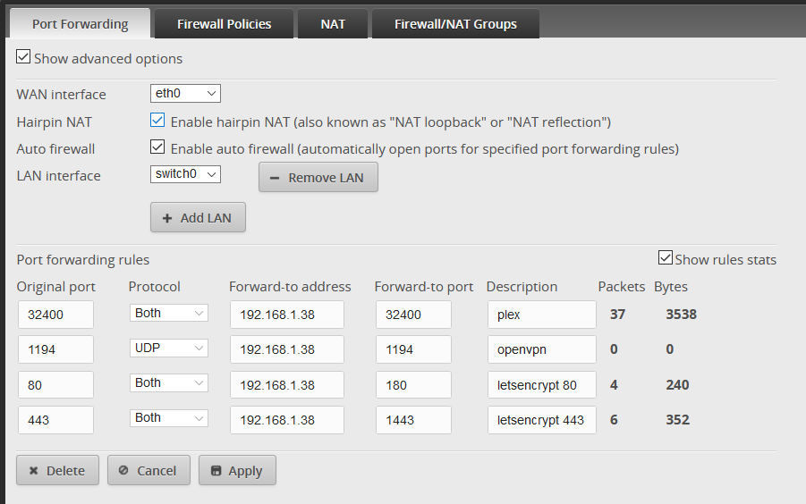

Solved my problem with regard to accessing nextcloud (and other letsencrypt'd containers) from within the same LAN on a ubiquiti edgerouter setup.  Posting here in case it might be of any use to others, including @kelmino
I'm pretty sure that the issue was the "LAN interface" setting under Port Forwarding options in EdgeOS.  This setting needs to be "switch0" and nothing else on an edgerouter.  Both myself and kelmino had several LAN interfaces set to various ethernet ports here, which seems to make sense at first and doesn't cause any issues with port forwarding when dealing with incoming connections from the outside internet.  After reading ubiquiti's edgerouter port forwarding documentation and especially this ubiquiti forum post linked therewithin, I now realize that was incorrect.  Having "LAN interface" set incorrectly prevents the hairpin NAT feature from working with the auto firewall rules, preventing local access.
For transparency, I'm guilty of changing too many variables at once here and it is entirely possible that the fix was actually starting from a fresh config on edgeos v2.0.3 rather than using an old config migrated from v1.10.5.  I doubt that is the case though, as the only functional differences between my current config and a backup of the old config is the LAN interface options.  While troubleshooting this I updated my firmware to v2.0.3.  After that I reverted to the default config, ran the basic setup wizard, then manually re-created my small amount of port forwarding rules exactly as they were aside from the above mentioned change to the LAN interface list.
If any ubiquiti users are still having issues with this specific issue (external access works, local access doesn't) after making this change, @ me and I'll try to help (even though I'm far from an expert)
See below for a screenshot of the port forwarding screen from my now-functioning setup:
Thanks for this, I'll try it when I get home tonight!
 I didn't want to try this while I was at work and it knock out my internet and the ability to remote in and have my server down all day.  I'll let you know if it works.
