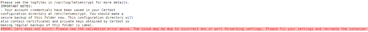

9 hours ago, C_James said:
so what do you recommend? like ive tried to everything ive read online, contacted ISP and they say they are not blocking any ports so im totally stumped
Did you follow the steps in the link I posted for you? You didn't even post a full log. You keep saying it doesn't work. I don't know how you expect us to help you more.

Hi my certificates seem to have expired and arent renewing properly. Everything shows an insecure connection error.
I managed to find a command that forces a renewal but it failed also.
Please Help.
root@f95960ea16c1:/# certbot renew --force-renewal
Saving debug log to /var/log/letsencrypt/letsencrypt.log
Processing /etc/letsencrypt/renewal/12312.duckdns.org.conf
Plugins selected: Authenticator standalone, Installer None
Renewing an existing certificate
Performing the following challenges:
http-01 challenge for 12312.duckdns.org
http-01 challenge for 12312books.duckdns.org
http-01 challenge for 12312cloud.duckdns.org
http-01 challenge for 12312collab.duckdns.org
http-01 challenge for 12312eb.duckdns.org
http-01 challenge for 12312sonic.duckdns.org
Waiting for verification...
Challenge failed for domain 12312.duckdns.org
Challenge failed for domain 12312books.duckdns.org
Challenge failed for domain 12312cloud.duckdns.org
Challenge failed for domain 12312collab.duckdns.org
Challenge failed for domain 12312eb.duckdns.org
Challenge failed for domain 12312sonic.duckdns.org
Cleaning up challenges
Attempting to renew cert (12312eb.duckdns.org) from /etc/letsencrypt/renewal/12312.duckdns.org.conf produced an unexpected error: Some challenges have failed.. Skipping.
All renewal attempts failed. The following certs could not be renewed:
  /etc/letsencrypt/live/12312.duckdns.org/fullchain.pem (failure)
1 renew failure(s), 0 parse failure(s)
IMPORTANT NOTES:
 - The following errors were reported by the server:
   Domain: 12312.duckdns.org
   Type:   connection
   Detail: Fetching
   http://12312.duckdns.org/.well-known/acme-challenge/xOfjgjZ_gAKLszpRvZqKf8pgHx5lcTPNgeEe3qYeE6A:
   Timeout during connect (likely firewall problem)
   Domain: 12312books.duckdns.org
   Type:   connection
   Detail: Fetching
   http://12312.duckdns.org/.well-known/acme-challenge/jGgGqvMpMyzbwla7Dud0wKkcEiGSNRPsgVezc-CSi1s:
   Domain: 12312cloud.duckdns.org
   Type:   connection
   Detail: Fetching
   http://12312cloud.duckdns.org/.well-known/acme-challenge/mWozEdw7z4qzkVItZn6UaIVKtwF83JLL3CHBymGU28I:
   Domain: 12312collab.duckdns.org
   Type:   connection
   Detail: Fetching
   http://12312collab.duckdns.org/.well-known/acme-challenge/gFj5JsqKpK2GVqsDeSUtTn2Maydv9zlu0gkKMF6uYtE:
   Domain: 12312eb.duckdns.org
   Type:   connection
   Detail: Fetching
   http://12312eb.duckdns.org/.well-known/acme-challenge/SKDzPo7Aj6iZpQ4fsTRrckvesdBbX3RiuaNpStuGDsg:
   Domain: 12312sonic.duckdns.org
   Type:   connection
   Detail: Fetching
   http://12312sonic.duckdns.org/.well-known/acme-challenge/LmUoiGYpTLHX1Co87bfKyC3yveZwjMneQXxf0jbebxI:
   To fix these errors, please make sure that your domain name was
   entered correctly and the DNS A/AAAA record(s) for that domain
   contain(s) the right IP address. Additionally, please check that
   your computer has a publicly routable IP address and that no
   firewalls are preventing the server from communicating with the
   client. If you're using the webroot plugin, you should also verify
   that you are serving files from the webroot path you provided.
