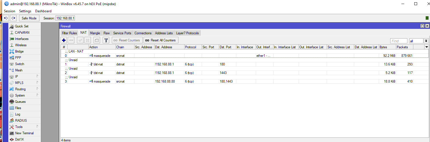

On 11/23/2019 at 2:47 PM, aptalca said:
Changed settings as shown in the image and followed the linked guide, letsencrypt still comes up with:
Challenge failed for domain .myserver.com
Type: Unauthorized
"To fix these errors, please make sure that your domain name was
entered correctly and the DNS A/AAAA record(s) for that domain
contain(s) the right IP address." Checked.
When trying to access nginx from outside the network according to the guide (i.e. nextcloud.myserver.com) a page comes up along the lines of "this page is under construction".
Also, when attempting to port check ports 80, 180, 443, 1443, the connection is refused on 80/443 and timed out on 180/1443.
Thoughts?

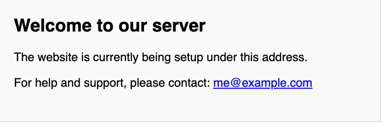

14 minutes ago, Tucubanito07 said:
Hey Guys. I googled "letsencrypt welcome to our server page edit" and i dont see anything about modifying the Welcome to our server. Can we modify this to something else? Thank you.
It's a webserver, so you can do whatever you want with the landing page.
Link to comment
I did some changes and saved it using nano and when I refresh the docker it did not update with everything I changed on that file. That’s why I asked. Thank you @aptalca when I change anything in there so I have to do anything else to make sure it comes up with the updates I made on the confit file? What is the location of the file? I want to make sure I am making changes to the right configure file.
Edited by Tucubanito07
Link to comment
The default folder for www is /config/www or appdata folder of letsemcrypt/www.
You probably have to restart the container for the changes to be active.
