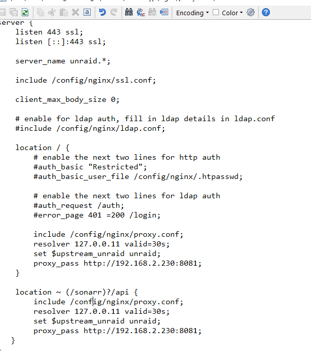

February 10, 20206 yr I have a question, Im currently running this docker, succesfully made subdomain redirects (by using the templates). I want my top domain (****.nl) to redirect to my Wordpress docker and i want (unraid.****.nl to redirect to my unraid server. How do i set this up? all of my configs are defautl except i removed .sample from the proxy-confs folder for the services i use Edited February 10, 20206 yr by Mirano
February 10, 20206 yr 3 hours ago, Mirano said: I have a question, Im currently running this docker, succesfully made subdomain redirects (by using the templates). I want my top domain (****.nl) to redirect to my Wordpress docker and i want (unraid.****.nl to redirect to my unraid server. How do i set this up? all of my configs are defautl except i removed .sample from the proxy-confs folder for the services i use Edit the default site config and modify the location block for "/" For unraid, you can copy and modify an existing proxy conf with unraid values

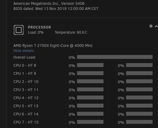

February 11, 20206 yr 17 hours ago, aptalca said: Edit the default site config and modify the location block for "/" For unraid, you can copy and modify an existing proxy conf with unraid values Perfect thank you, Regarding this. The website loads but upon opening the Shell or looking at processor graph. it doesn't seem to work, did i do something wrong?

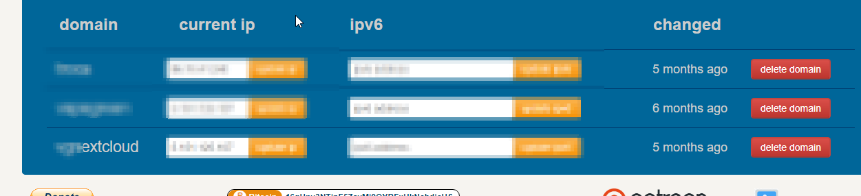

February 11, 20206 yr 3 minutes ago, TechMed said: sorry, should have been from this point in the video... If the setup of DuckDNS (the actual DuckDNS container on your server) does not know "subdomain2" exists, it will not resolve and in turn throw a DNS error. Thank you, there shouldn't be a problem there as it looks correct in the duckdns docker and it is updating the IP correctly. I have also confirmed it in on the Duckdns.org website. I can also connect to my wekan docker if i just add a :5555 at the end of that subdomain as well I will take a little break tonight and start with a fresh mind tomorrow morning, thanks for your help and time spent trying to figure this our with me
