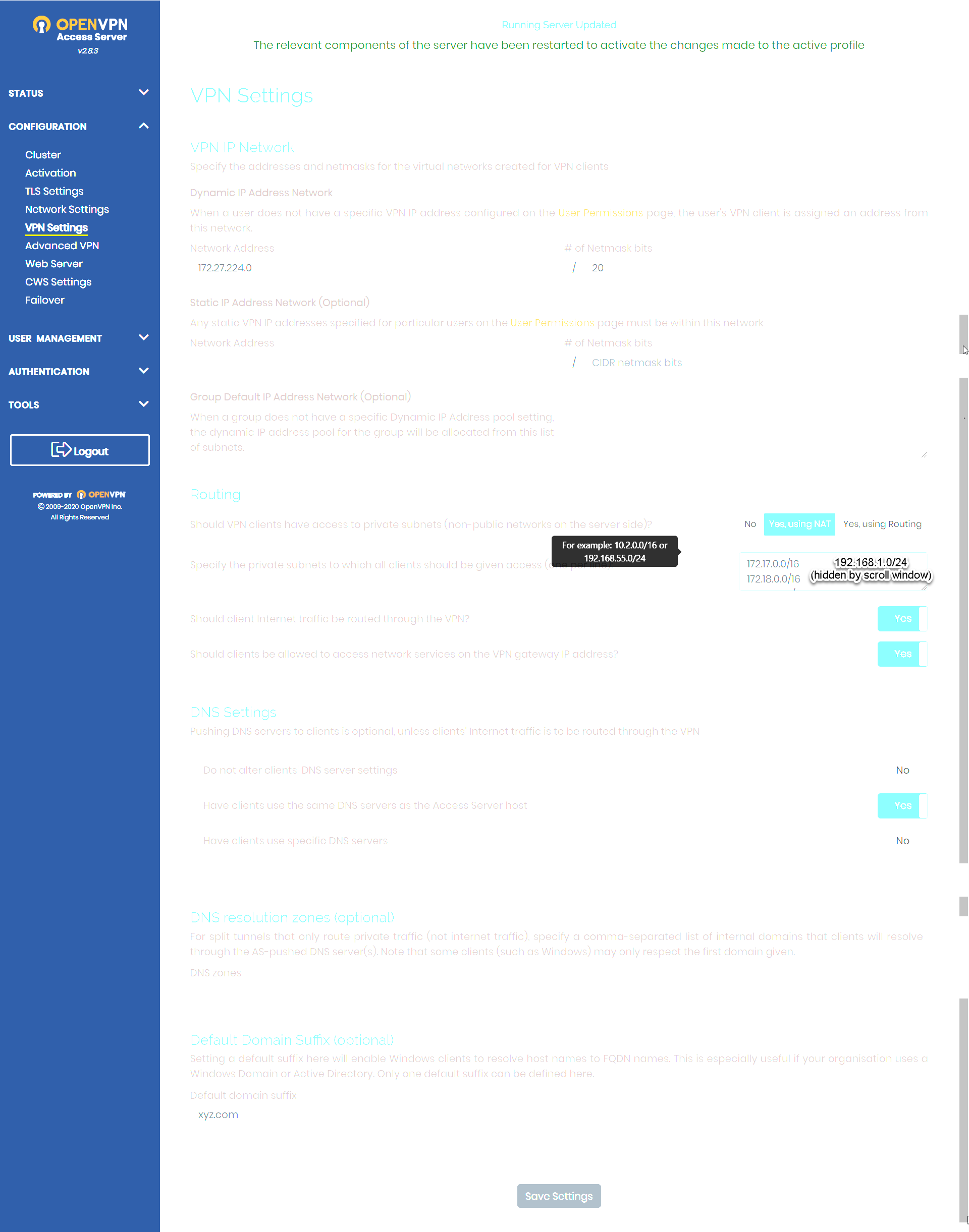

I'm trying to configure my linuxserver/letsencrypt reverse proxy to do source-IP-based access control and authentication for various applications. I'm using sonarr as my test application (with its own authentication disabled). My intended restrictions are shown, below. It works for Private LAN, Guest Wi-Fi and Elsewhere. OpenVPN clients, however are being denied (403 Forbidden) even though they should be allowed. I'm using an iPad (Safari) as my test device since it is easy to disconnect from the LAN/Wi-Fi and reconnect via the VPN over LTE. I wonder/suspect that OpenVPN's use of NAT might be causing the problem. I also wonder if caching on the iPad/Safari is causing some unexpected results as certain inconsistencies seem to be happening over repeated test cycles. OpenVPN access is being provided by linuxserver/openvpn-as. Configs are all provided, below. Is it logical that NAT would cause problems? If so, is there a fix that can be done without changing the OpenVPN AS configuration? If the answer is to reconfigure the OpenVPN AS for routing instead of NAT, guidance on specifics are appreciated as I previously tried reconfiguring for Routing, but couldn't get it working (Changed OpenVPN's VPN config to use routing, added route in my internet access router such that Next Hop for 172.27.224.0/20 was the IP of the Unraid Server...Wasn't sure how to add a route in Unraid pointing 172.27.224.0/20 to the OpenVPN AS container, though....for now I've reverted back to NAT config).
My goal is as follows:
# Intended Access Restrictions and Authentication Requirements:
#   Private LAN (192.168.1.0/24): Access Allowed; No Authentication
#   OpenVPN Clients (172.27.224.0/20): Access Allowed; No Authentication
#   Guest Wi-Fi (192.168.2.0/24): Access Allowed; Authentication Required
#   Elsewhere (incl. Public Internet): Denied
Here's my docker run command for letsencrypt:
root@localhost:# /usr/local/emhttp/plugins/dynamix.docker.manager/scripts/docker run -d --name='letsencrypt' --net='proxynet' --privileged=true -e TZ="America/Los_Angeles" -e HOST_OS="Unraid" -e 'EMAIL'='someone@xyz.com' -e 'URL'='xyz.com' -e 'SUBDOMAINS'='bazarr,calibre,ds-one,ds-two,jackett,jdownloader,mail,nzbget,ombi,qbittorrent,radarr,sonarr,speedtest,tautulli,unifi,unraid,webdav,www,nextcloud,onlyoffice,openvpn' -e 'ONLY_SUBDOMAINS'='true' -e 'DHLEVEL'='2048' -e 'VALIDATION'='http' -e 'DNSPLUGIN'='' -e 'PUID'='99' -e 'PGID'='100' -p '80:80/tcp' -p '443:443/tcp' -v '/mnt/user/appdata/letsencrypt':'/config':'rw' 'linuxserver/letsencrypt'
c9d6dd6d8b23f11c7532f2a47582d1acaff3ee958a5aa1xxxxxde0c9e1d1f2e7
The command finished successfully!

My openvpn-as docker run command:
root@localhost:# /usr/local/emhttp/plugins/dynamix.docker.manager/scripts/docker run -d --name='openvpn-as' --net='bridge' -e TZ="America/Los_Angeles" -e HOST_OS="Unraid" -e 'PGID'='100' -e 'PUID'='99' -p '943:943/tcp' -p '9443:9443/tcp' -p '1194:1194/udp' -v '/mnt/user/appdata/openvpn-as':'/config':'rw' --cap-add=NET_ADMIN 'linuxserver/openvpn-as'
f346af968420c62654e0ee992debd831a24b313eb0e71xxxxxfafd28641111
My OpenVPN AS VPN Config:
Check the nginx logs to see what ip is listed as the source when you connect over vpn. I suspect it will look like the openvpn container ip as everything is nat'ed through that
Link to comment

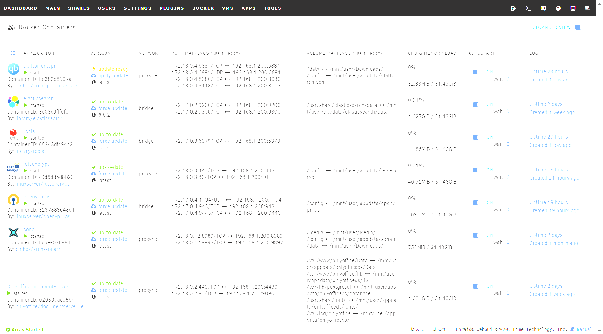

Aptalca, thanks for your help!
On the iPad test client, the IP address shown in the OpenVPN Connect app shows 172.27.224.16 (as expected). Unexpectedly, the nginx access log shows the request from 172.18.0.1 which is on my proxynet bridge. My OpenVPN container is on the default bridge (172.17.0.0). My LetsEncrypt container is on the proxynet bridge (172.18.0.0). Below are: access.log snippet, container info, docker network info.
/mnt/user/appdata/letsencrypt/log/nginx/access.log entry:
172.18.0.1 - - [20/May/2020:11:12:56 -0700] "GET / HTTP/2.0" 403 114 "-" "Mozilla/5.0 (iPad; CPU OS 13_4_1 like Mac OS X) AppleWebKit/605.1.15 (KHTML, like Gecko) Version/13.1 Mobile/15E148 Safari/604.1"
Container info (partial):
Docker network info:
root@Unraid:~# docker network ls
NETWORK ID          NAME                DRIVER              SCOPE
149dad2b001d        br0                 macvlan             local
437fa80d49a7        bridge              bridge              local
313e86ebe6bd        host                host                local
affa87359514        none                null                local
5ae677f41049        proxynet            bridge              local
root@Unraid:~# docker network inspect proxynet
        "Name": "proxynet",
        "Id": "5ae677f41049b95bfa835bac27ed63d6d464c722ab4255eda0028f5e9c998e00",
        "Created": "2020-04-18T17:03:47.028748092-07:00",
        "Scope": "local",
        "Driver": "bridge",
        "EnableIPv6": false,
        "IPAM": {
            "Driver": "default",
            "Options": {},
            "Config": [
                    "Subnet": "172.18.0.0/16",
                    "Gateway": "172.18.0.1"
        "Internal": false,
        "Attachable": false,
        "Ingress": false,
        "ConfigFrom": {
            "Network": ""
        "ConfigOnly": false,
        "Containers": {
            "02050bac056c89c8b47cae9eda4efa6ffe3c69782b886bb00ae6006e20539a25": {
                "Name": "OnlyOfficeDocumentServer",
                "EndpointID": "679e1b80e980b59336fe67ba50d1f223a53d17ffe73ab442dd815a8a13a608d6",
                "MacAddress": "02:42:ac:12:00:02",
                "IPv4Address": "172.18.0.2/16",
                "IPv6Address": ""
            "1dbdd858a0d4dd5e3426e1c26d26ba9e32f8b086bd23e19a7efdca2e7dd936f6": {
                "Name": "ombi",
                "EndpointID": "4fd43f7fea67613418c38cf0bc72a1685d2c928635d45a991b60b9caaaf6f18a",
                "MacAddress": "02:42:ac:12:00:0a",
                "IPv4Address": "172.18.0.10/16",
                "IPv6Address": ""
            "2620cff940e83d7c276f9bde5f7d8fff46a813b1a8bdbd99b6f71c22901faf57": {
                "Name": "tautulli",
                "EndpointID": "90eea69636fc7846eb575eb2fbe585e4f39c5daeb86f8dfb901cbfc68dfae343",
                "MacAddress": "02:42:ac:12:00:0e",
                "IPv4Address": "172.18.0.14/16",
                "IPv6Address": ""
            "6eb5aea45d378db636b8b9c744f5f1634d6a5d3673ff86bd0233f2e9aafbe3ed": {
                "Name": "jdownloader2",
                "EndpointID": "cad9e26a7d197d99fba67523a182c80b5d4b482303437dc9cc61ce3785ae7b4c",
                "MacAddress": "02:42:ac:12:00:06",
                "IPv4Address": "172.18.0.6/16",
                "IPv6Address": ""
            "705a5e1ac3222aea179316986fe818977fcb23a346a0134c69f12d1b5e73fbc9": {
                "Name": "bazarr",
                "EndpointID": "1450dcd8f398b91639519ba2c751828dc6cf43e05a58a9abe378ab07c8e1da8d",
                "MacAddress": "02:42:ac:12:00:09",
                "IPv4Address": "172.18.0.9/16",
                "IPv6Address": ""
            "758dbc99154c4a025ae06659f1bd7bdac17a83444085d032d50ba0cdf30246d6": {
                "Name": "nzbget",
                "EndpointID": "3a340a9f4885df99031b9a5f2214a4c5817bcb42c5d370657a56ce2a904ab903",
                "MacAddress": "02:42:ac:12:00:07",
                "IPv4Address": "172.18.0.7/16",
                "IPv6Address": ""
            "90f2c7c3aa2e0ad89617ac94f691bd9ab175869d33e032d7f2c51ff60470dc27": {
                "Name": "jackett",
                "EndpointID": "60e2cbc4b13cca79749f460dd553bf85b8f69d5efb65c9fbe4c9c580230fe9e0",
                "MacAddress": "02:42:ac:12:00:08",
                "IPv4Address": "172.18.0.8/16",
                "IPv6Address": ""
            "bcbee02b8813c0bf5cc9b2bccfd0bc80ef29541e1eceecffb251b16baf143aaf": {
                "Name": "sonarr",
                "EndpointID": "2daa793d8b9614f2e5b56d107e59552ae8fd55bea774392972106a7c739bcb5c",
                "MacAddress": "02:42:ac:12:00:0c",
                "IPv4Address": "172.18.0.12/16",
                "IPv6Address": ""
            "bd382d8507a1c149c4a226adc357c53037a8842da7dfeedacd8e5dae880936d8": {
                "Name": "qbittorrentvpn",
                "EndpointID": "41c3c4f0e2e9aaa44df261ab81848f7faeee09fa1addd81adf9e742121997610",
                "MacAddress": "02:42:ac:12:00:04",
                "IPv4Address": "172.18.0.4/16",
                "IPv6Address": ""
            "c62348028dc05ee1e8566d24f5a8054cf76a66a4ff29407ef40cbfe09e2afc3f": {
                "Name": "nextcloud",
                "EndpointID": "c75c006b4da635a445cffcadac6c1e848728a6c9af4e7068acabdcb68db5bb0b",
                "MacAddress": "02:42:ac:12:00:05",
                "IPv4Address": "172.18.0.5/16",
                "IPv6Address": ""
            "c9d6dd6d8b23f11c7532f2a47582d1acaff3ee958a5aa125701de0c9e1d1f2e7": {
                "Name": "letsencrypt",
                "EndpointID": "862f45a2a60abaf62fee635c7007a87aa5933ee0981820198558bf9cedc2ab4a",
                "MacAddress": "02:42:ac:12:00:03",
                "IPv4Address": "172.18.0.3/16",
                "IPv6Address": ""
            "e8b128855c0a5348a0fe6ab166b0c455606807883d97242fe66f2edb311795be": {
                "Name": "speedtest",
                "EndpointID": "72383d32bd5850e3d37b2ffad45ff8692d1ba9780032ca16bdfac494f9034de1",
                "MacAddress": "02:42:ac:12:00:0d",
                "IPv4Address": "172.18.0.13/16",
                "IPv6Address": ""
            "e963268e039e7cd6d528aa421754eb13eee0fe9df4b918896b6ff1c152c0e135": {
                "Name": "radarr",
                "EndpointID": "23e892d51e30e0f78eeaf221c491941756980a61a9e17bcba3bb141c127bfee0",
                "MacAddress": "02:42:ac:12:00:0b",
                "IPv4Address": "172.18.0.11/16",
                "IPv6Address": ""
        "Options": {},
        "Labels": {}
root@Unraid:~#
root@Unraid:~# docker network inspect bridge
        "Name": "bridge",
        "Id": "437fa80d49a7831da11f2445567a2de643864b51a34af81c8b915a65481df4d5",
        "Created": "2020-05-17T10:06:03.195877445-07:00",
        "Scope": "local",
        "Driver": "bridge",
        "IPAM": {
            "Options": null,
            "Config": [
                    "Subnet": "172.17.0.0/16",
                    "Gateway": "172.17.0.1"
        "Internal": false,
        "Ingress": false,
        "ConfigFrom": {
            "Network": ""
        "Containers": {
            "3e08c9fff6fc580cd1835ec96c9b1c98ecdf1c4232e12ff288ece8d023d013e4": {
                "Name": "elasticsearch",
                "EndpointID": "b25e13dff119e76964caef6fe722fd813f88880583d0dd60fc752e7822b956eb",
                "MacAddress": "02:42:ac:11:00:02",
                "IPv4Address": "172.17.0.2/16",
                "IPv6Address": ""
            "439e932ed823ea325d099a5767fa8867cf486377f8f96685bea6a46a0490b0e7": {
                "Name": "lidarr",
                "EndpointID": "0da41c47467a9415acba4aa72c094f000b330a891bb3635108ffecc0daa5fb3a",
                "MacAddress": "02:42:ac:11:00:07",
                "IPv4Address": "172.17.0.7/16",
                "IPv6Address": ""
            "5237888648d1fcd0d9792193dd54e2432cde243d6ef20a77e377be43a3553cb1": {
                "Name": "openvpn-as",
                "EndpointID": "16431efb9ea54d2bda33c3713f98cd535d3d00c71f42811f63314d10c7489057",
                "MacAddress": "02:42:ac:11:00:04",
                "IPv4Address": "172.17.0.4/16",
                "IPv6Address": ""
            "65248dfc94c25a7485882a3dbd48c4da8ac58179fa4f4c4803114d44b3dac873": {
                "Name": "redis",
                "EndpointID": "dd9ec7030c30e47874c5679f06c36d3689045cc53816c448e452e83ede0e567f",
                "MacAddress": "02:42:ac:11:00:03",
                "IPv4Address": "172.17.0.3/16",
                "IPv6Address": ""
            "aa062c0fa4041c2a9676202c72da919df48592a309ff9c6a13ac1c640e1c1607": {
                "Name": "organizr",
                "EndpointID": "9126ef981eddc21b8ef8d43efa2c6d6cf31c992b61c660cc98a54ae8f5909c19",
                "MacAddress": "02:42:ac:11:00:08",
                "IPv4Address": "172.17.0.8/16",
                "IPv6Address": ""
            "c24e58e44b01beb2536dfe7c2ecb4f869d5d047f503012d2971012c663b2ebdc": {
                "Name": "mariadb",
                "EndpointID": "eff2c3185176af3031737da4d79aff7c71f79d0728dbb51956bd646be846f983",
                "MacAddress": "02:42:ac:11:00:05",
                "IPv4Address": "172.17.0.5/16",
                "IPv6Address": ""
            "d325c927cc9194be5312f9fa4881cc36c46a8a38003e44aa6fc2bf5ffdd6a6d0": {
                "Name": "krusader",
                "EndpointID": "0b616363699fb5763aed7e9e20f72623b2855b952b852197f9055316b5e9bbe9",
                "MacAddress": "02:42:ac:11:00:06",
                "IPv4Address": "172.17.0.6/16",
                "IPv6Address": ""
            "f6c06ab541d3c95ec5600a243bb02a6cf46449e576c6dd146afcb726e32ffa79": {
                "Name": "tdarr",
                "EndpointID": "d49379cd418dcd2b23a74d07e6a8ad41f827736f219942595d36b5a637054dcb",
                "MacAddress": "02:42:ac:11:00:09",
                "IPv4Address": "172.17.0.9/16",
                "IPv6Address": ""
        "Options": {
            "com.docker.network.bridge.default_bridge": "true",
            "com.docker.network.bridge.enable_icc": "true",
            "com.docker.network.bridge.enable_ip_masquerade": "true",
            "com.docker.network.bridge.host_binding_ipv4": "0.0.0.0",
            "com.docker.network.bridge.name": "docker0",
            "com.docker.network.driver.mtu": "9000"
        "Labels": {}
root@Unraid:~#
