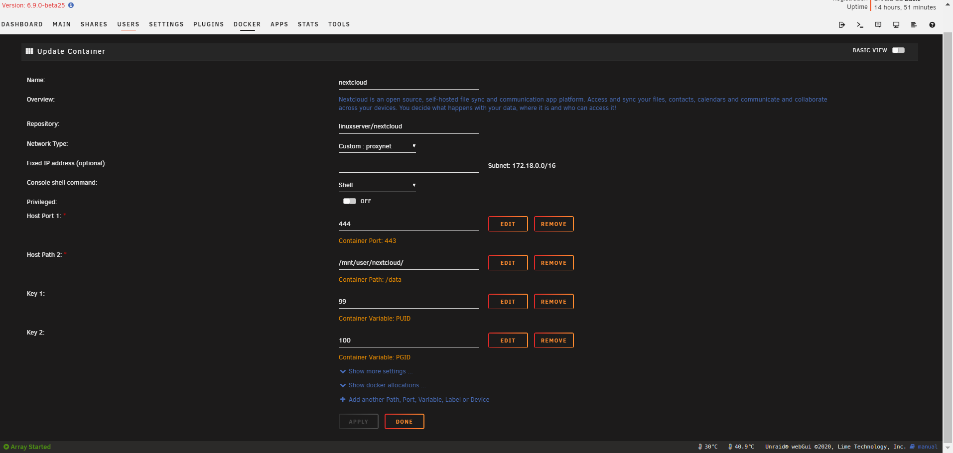

Alright, let break it down. I have register my own domain name (protech.my). The video I followed are link below from SpaceinvaderOne. Let's Encrypt's log said server is ready. Lets' Encrypt port is 80 -> 180 and 443 -> 1443. Port forwarding is done on my router as I able to see the Let's Encrypt WebUi. I attached the log for reference. I am sure nextcloud is working as I have manage to access it locally and set up admin account with Mariadb. For the record, my nextcloud container port is 444. I have used cloudflareddns docker by onzu to track my public IP. I have setup a CNAME nextcloud.protech.my where is point to my public IP. I have setup the nextcloud.subdomain.conf and conf.php I asssume is done correctly already I hope. Let me know if I make any mistake. I attached the file below. I restarted the dockers and still stuck at Let's Encypt Web UI. If anything is not clear, please let me know. I have been stuck with in for a month. It would be if anyone could solve this. I dont mind if I can't get reverse proxy working but if there any method to get onlyoffice working, that would work for me. Thanks.
Extra information:
(to be very sure my nextcloud is working, I port forwarded 443->444 which is my nextcloud container. I am able to access it from outside my home wifi but when I port forward to 443->1443 and back to stuck in Let'sEncrypt Web UI)
 and

On 8/16/2020 at 10:02 PM, saarg said:
Post the docker run command for both containers.
What is a run command? Sorry I am still a newbie. Do you mean the setting page of the container as shown below?
Edited by Wong

@saarg
This is from letsencrypt. You said do it with both container. I use the same command line for nextcloud container as well? Yes, I am trying to run https://protech.my CNAME is nextcloud
[email protected]:/# ping nextcloud
PING nextcloud (172.18.0.4): 56 data bytes
64 bytes from 172.18.0.4: seq=0 ttl=64 time=0.055 ms

15 minutes ago, aptalca said:
Your nextcloud subdomain is showing the default landing page, which likely means that your nextcloud proxy conf is not activated properly. Is it named "nextcloud.subdomain.conf" and resides at "/config/nginx/proxy-confs"?
OHHH MYYY GODDDD, it worked. So the problem is because when I saved the nextcloud.subdomain.conf, notepad++ save it as text file. I edited the save type into all type. Then it worked. It feel good to get things working. Thanks you for the awesome unraid community support.
In windows, make sure you enable the setting for displaying file extensions even if known
