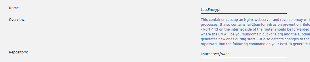

1 hour ago, ElectricBadger said:
Do we need to change anything in our unRAID configs in order to continue getting updates to this container, if it's being renamed? Or will the rename get picked up automatically?
I would assume that there will be a new container to swap to, as swag is in a different git repo than the lets encrypt image. There is currently not released one on the community application plugin in unraid, so i would assume they will release it when they have time.
For now you can just edit the docker to point the repository from linuxserver/letsencrypt to linuxserver/swag and it seems to work fine for me so far.

Is this container now depricated or not because this message apperas now:
* This image has been deprecated *
* Use the new image at *
* linuxserver/swag *
* https://hub.docker.com/r/linuxserver/swag *
* https://github.com/linuxserver/docker-swag *
Will it get updates or do I have to setup swag instead?
Also what are the differences, can I just point my existing Let's Encrypt folder to swag and it will work OOB and will there be a official template for swag?
Share this post
Link to post
Very good chance I’m wrong but I’d swore someone said at one point that eventually going from Letsencrypt container to SWAG would require some interaction on our part...
Share this post
Link to post
1 minute ago, blaine07 said:
Very good chance I’m wrong but I’d swore someone said at one point that eventually going from Letsencrypt container to SWAG would require some interaction on our part... emoji848.png
Works OOB in my case, just changed the repo from /letsencrypt to /swag
Share this post
Link to post
At this point, the SWAG and letsencrypt images are 100% compatible and we plan to keep SWAG backwards compatible as long as we can. The main change is to the docker image name, which was linuxserver/letsencrypt for the old image and is linuxserver/swag for the new.
