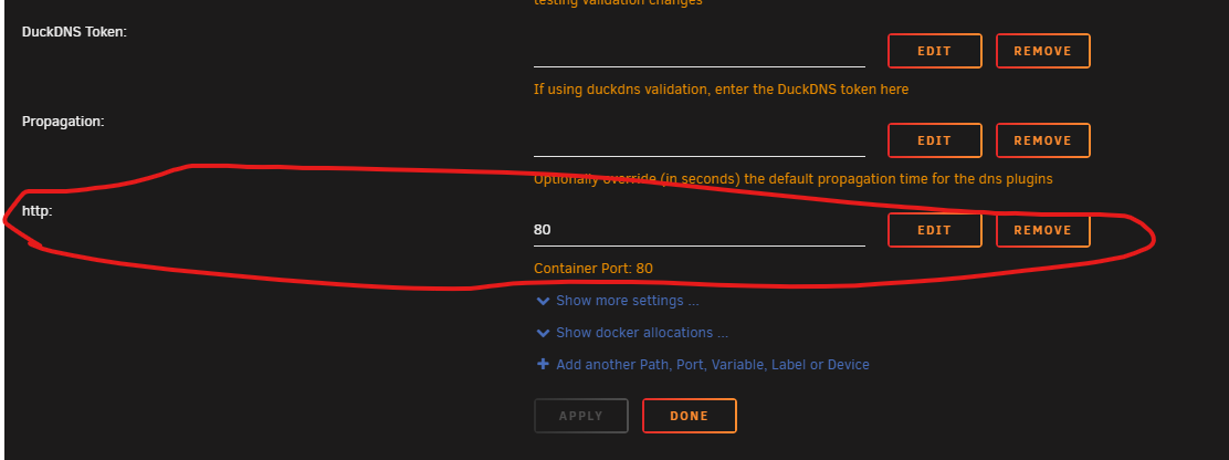

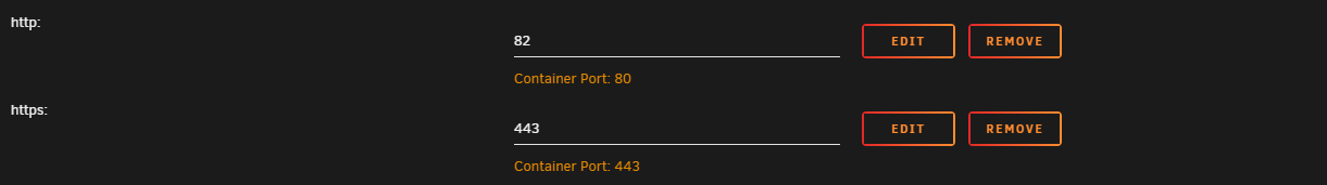

5 hours ago, mattgob86 said:
I came here for this as well.  I have the Port 80 already in my template at the top.  Every time I update the docker, it adds another variable for port 80 and filled in as port 80 at the bottom and the conflict makes the docker die and it won't start until i remove the added variable.  No matter how many times I remove it, it adds it back.
I don't know if this is because I just changed the repo when it was switched to swag and left the existing template alone.
If port 80 is taken, then simply use another port. That's what port mapping is for.

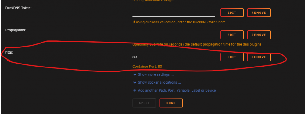

So why if this is at the top, after a docker update does it add automatically another
I have seen this before and it hasn't been a problem with the exception of the last 2-3 weeks of updates not letting the docker start after update until that new http: variable is removed.
Link to post

When I go to test the fail2ban (by going onto my cell network) and attempting to connect to the reverse proxy emby or bitwarden with incorrect login past the "maxretry"    It does not activate...   HOWEVER... When I go to reset the SWAG container,  then the blocking occurs.. (Confirmed by using the terminal tools  "docker exec -it swag fail2ban-client status"   and   "docker exec -it swag fail2ban-client status <jail name>"      While doing the testing    the Jails are all shown as active...  .  any thoughts on why this is ?
Link to post
17 hours ago, saarg said:
Why have you changed the port? There is nothing mentioned about it in the instructions. Leave it as it originally was.
Post the docker run commands for both nextcloud and and swag.
I changed the ports because I was getting an error with certbot about the port already being in use (80/443), so I switched to 1880/18443 to be out of range of "commonly used ports".
Also, I know what a docker run command is when using the terminal, but I've never seen the docker run command myself from unraid. How do I go about getting the docker run command?
Link to post
Hey guys quick question.  I have a few things setup with Swag.  Radarr, Sonarr, BitwardenRS, and Nextcloud.   I moved Bitwarden back to them hosting it instead of me but i still have the docker on Unraid.  Sometimes when i try to use Nextcloud, it says server is not available.   To fix this, i fire up the Bitwarden docker and then Nextcloud works again.  Anything i can look at?   want to delete Bitwarden but for some strange reason, it is tied to Nextcloud.
Link to post
Check the docker faq.
Link to post
Here's the docker run (it would have been faster to just say "edit the config & it'll give the run command")
SWAG:
root@localhost:# /usr/local/emhttp/plugins/dynamix.docker.manager/scripts/docker run -d --name='swag' --net='bridge' -e TZ="America/Chicago" -e HOST_OS="Unraid" -e 'EMAIL'='snreloaded@snreloaded.stream' -e 'URL'='snreloaded.stream' -e 'SUBDOMAINS'='home,' -e 'ONLY_SUBDOMAINS'='true' -e 'VALIDATION'='http' -e 'DNSPLUGIN'='' -e 'EXTRA_DOMAINS'='' -e 'STAGING'='false' -e 'DUCKDNSTOKEN'='' -e 'PROPAGATION'='' -e 'PUID'='99' -e 'PGID'='100' -p '1880:80/tcp' -p '18443:443/tcp' -v '/mnt/user/appdata/swag':'/config':'rw' --cap-add=NET_ADMIN 'linuxserver/swag'
1eb3775caaf9f7ab02460256f1579bb3ce6e34d1174f318cfcee9dd775e67091
Nextcloud:
root@localhost:# /usr/local/emhttp/plugins/dynamix.docker.manager/scripts/docker run -d --name='nextcloud' --net='bridge' -e TZ="America/Chicago" -e HOST_OS="Unraid" -e 'PUID'='99' -e 'PGID'='100' -p '444:443/tcp' -v '/mnt/user/nextcloud/':'/data':'rw' -v '/mnt/user/appdata/nextcloud':'/config':'rw' 'linuxserver/nextcloud'
22e325a33923bd38a0e9e96159c43bbb20351efa7bcd948abdc4337ccce2d5fa
Link to post
The FAQ has answers to many more questions, it's good to browse through and see if your issue is already addressed.
