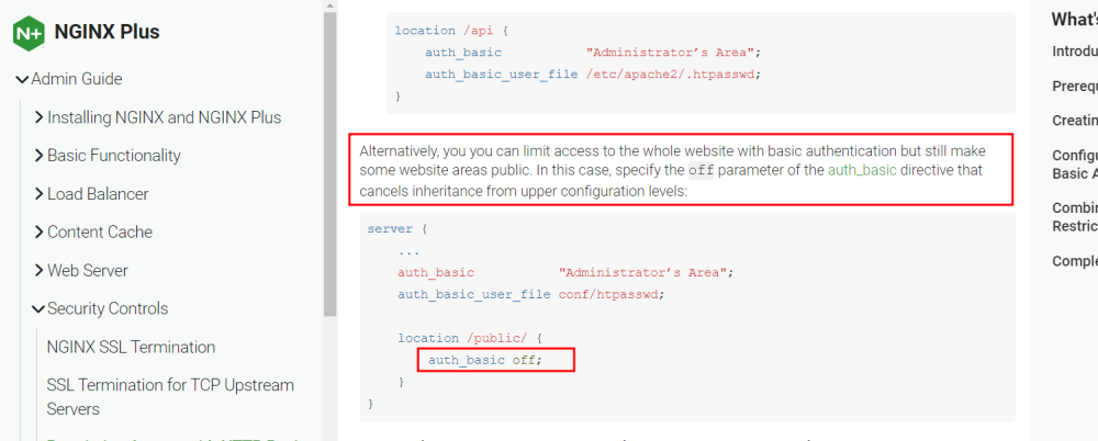

9 minutes ago, vurt said:
Does that suggest /opds doesn't need password? The / above has:

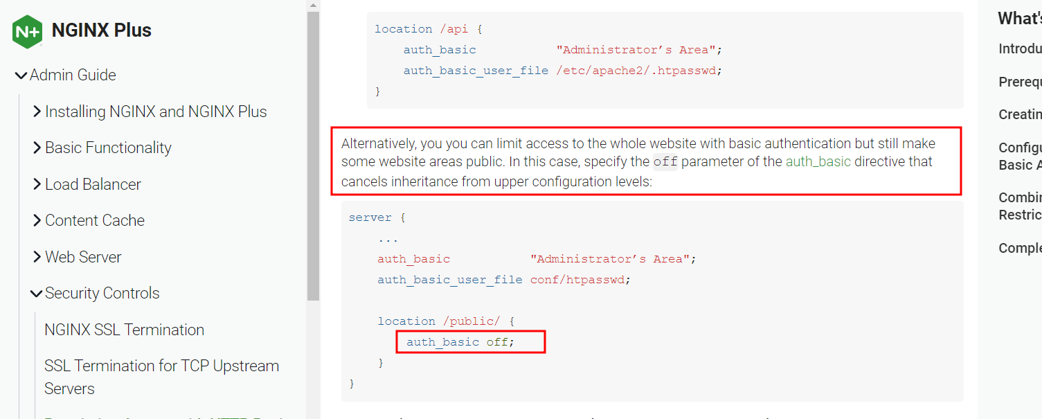

sadly looks like you didnt read the link i posted ... so i do the copy / paste now instead ...
I did, and modified the conf like this but it didn't work, still asked for password:
	# OPDS feed for eBook reader apps
	# Even if you use Authelia, the OPDS feed requires a password to be set for
	# the user directly in Calibre-Web, as eBook reader apps don't support
	# form-based logins, only HTTP Basic auth.
    location /opds/ {
        auth_basic off;
        include /config/nginx/proxy.conf;
        include /config/nginx/resolver.conf;
        set $upstream_app calibre-web;
        set $upstream_port 8083;
        set $upstream_proto http;
        proxy_pass $upstream_proto://$upstream_app:$upstream_port;
        proxy_set_header X-Scheme $scheme;
EDIT: Turned out it wasn't a reverse proxy issue for a change. Was on KOReader's end.

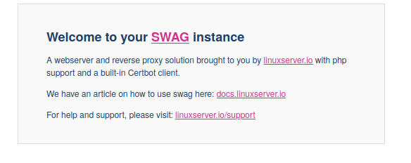

but still coming to the swag default page
what I did  wrong?

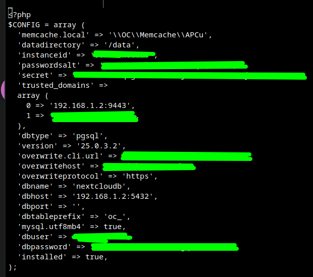

nextcloud/config/config.php
<?php
$CONFIG = array (
  'htaccess.RewriteBase' => '/',
  'memcache.local' => '\\OC\\Memcache\\APCu',
  'apps_paths' =>
  array (
    0 =>
    array (
      'path' => '/var/www/html/apps',
      'url' => '/apps',
      'writable' => false,
    1 =>
    array (
      'path' => '/var/www/html/custom_apps',
      'url' => '/custom_apps',
      'writable' => true,
  'instanceid' => 'oxpbb9w',
  'passwordsalt' => 'pw',
  'secret' => 'password',
  'trusted_domains' =>
  array (
    0 => '192.168.1.2:8666', ## Nextcloud
    1 => 'https://nextcloud.de', ## Domain
    2 => '192.168.1.2:1443',  ## SWAG Container
  'datadirectory' => '/var/www/html/data',
  'dbtype' => 'mysql',
  'version' => '25.0.3.2',
  'overwrite.cli.url' => 'https://nextcloud.de',
  'dbname' => 'database',
  'dbhost' => '192.168.1.2:3306',
  'dbport' => '',
  'dbtableprefix' => 'oc_',
  'mysql.utf8mb4' => true,
  'dbuser' => 'user',
  'dbpassword' => 'password',
  'installed' => true,
  'filesystem_check_changes' => 1,

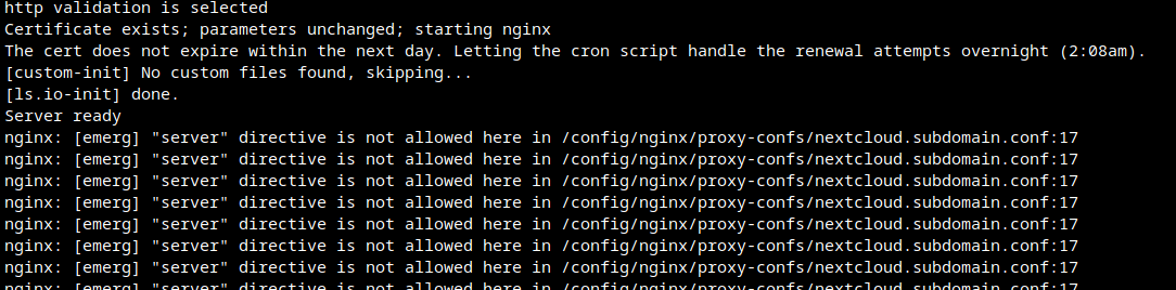

weird, I get error on nextcloud.subdomain.conf
I remove the sample. In the default file I include *.subdomain.conf to get all of the data. Only nextcloud.subdomain.conf is activated.

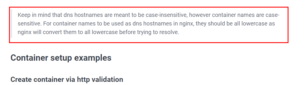

I only change nextcloud to Nextcloud (container name)'
the port to 8666.
Thank you
the port to 8666.

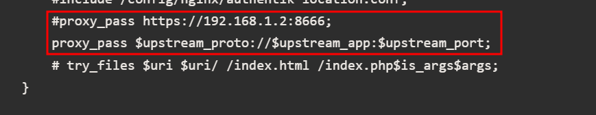

site-confs/default.conf
actually this is not true ... you added at least this
which doesnt belong there ...
now im coming back to ...
23 hours ago, alturismo said:
so from what i see i would suggest read the manuals howto, also useful for further proxy's you may want to add to understand how swag is working.
sample why
so, you made changes in the deafult like trying to point somewhere directly (which will result in conflicts with the loaded *.subdomain.conf ...) and you didnt read the manual as sample about hostnames and case sensitive behaviour, also how the port usage then would be inside the bridge ... this is what i see quickly here, so i would suggest, start from scratch and read the manual's cause it looks like we may cant resolve this anymore as i dont know what you also may "didnt change" ;)

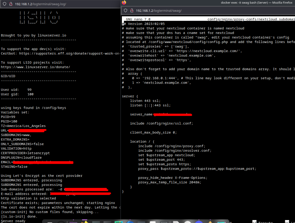

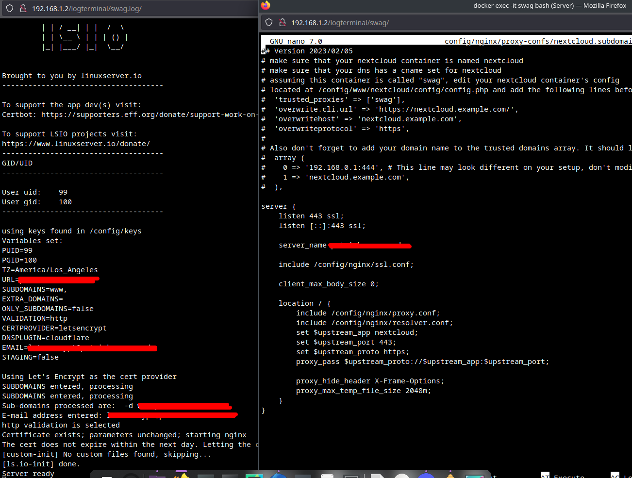

Thanks, I read the handbook again. Reinstalled everything. In this case my docker named on 'nextcloud' with port 9443
swag is on port 1443 and 180 (forwarding in router 443:1443, 180:80)
didn't touch the default in site-confs/
just
$: mv nextcloud.subdomain.conf.sample nextcloud.subdomain.conf

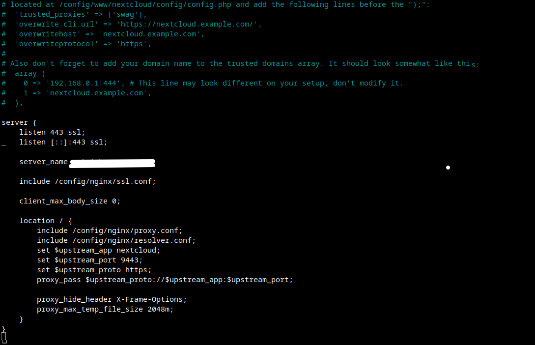

in the next way I change the config in this way: (look at the picture, changed server_name and port.
changed the config in the nextcloud. (look at the picture)
after a restart, I got error 502 when I want going to my website.

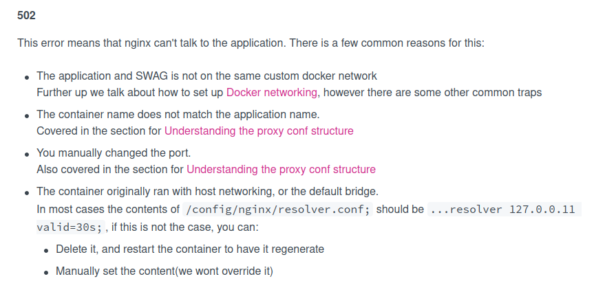

In the tutorial we get help for this:
The dockernetwork is in the same network.
the container has the same name.
I changed the port from 443 to 9443 ( changed the config also )
resolver should be 127.0.0.11, but why? default is by me 1.1.1.1 both do errors.
what you changed is the port mapping to access NC "outside", like from another bridge, from LAN, ...
consider this mapping more like a "router mapping", when you change the WAN port to access something ...
so, in result you change your subdomain config port back to 443 where NC inside the bridge is listening on.

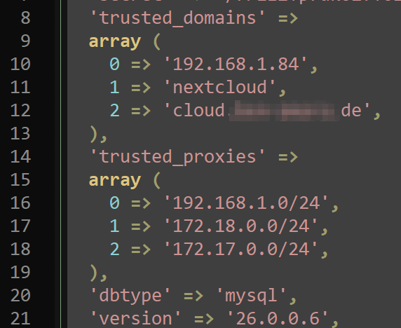

then, how you come to the point adding ports in the trusted sections of config.php ?
here a sample from mine ...
i call my nc locally either by ip .84, by name nextcloud or by its domain name (also externally)
trusted proxies are my LAN 192.... or the docker bridge LAN 172.... (im normally using custom:br0 where all running on 192...)
as you see, only masks, no ports ... manual ... ;)
also, may test if you can access your NC Installation locally in LAN on port 9443 when ist fired up (after correcting both trusted sections as described)
Thank you!
I change it back to 443. Locally is everything fine, but not in swag. I get 502 Error,
but my log and the config.php looks fine.
I added nextcloud in the trusted domain.

At this point, swag is driving me crazy ...
After each update, I get this error message:
nginx: [emerg] "stream" directive is not allowed here in /etc/nginx/conf.d/stream.conf:3
So I move the file like this:
mv -v /etc/nginx/conf.d/stream.conf /etc/nginx/stream.d/
and restart the docker, all is fine.
Next update, same procedure - and I don't get it, how come this file always ends up where supposedly it's not supposed to be?
I checked all the config files that were outdated, but none were related to stream.conf, most were just newer templates, I transitioned but keep getting the same problem.

I am not getting 502 errors for a lot of my subdomains?  A few work but most are getting this error?  I have taken the sample file and tried to modify it to work but I am not having much luck.
I have a problem that I have had for 1-2 weeks now, every morning I cannot access my stuff that is behind SWAG.
I'm not sure if this is a unraid or a SWAG problem but after a simple restart of SWAG I can access all my stuff again.
In which logs shall I begin the troubleshooting?
same
