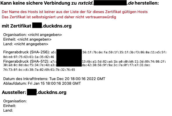

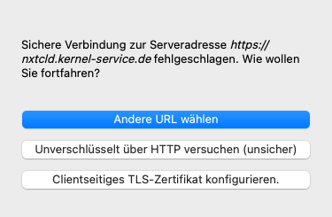

Hi there,
I realy hope this is the right place to ask as I'm not sure my problem is related to Swag. Might be a Nextcloud or even macOS problem as well.
I'm running a Nextcloud and Swag container as shown in spaceinvaders tutorial. Everything works well so far until I recently bought myself a new Mac mini. When setting up the Nextcloud app I get an error message telling me the certificate is self signed and cannot be trusted. As one can see the URL used is https://nxtcld.my-domain.de. For this subdomain I have a CNAME configures pointing to my DuckDNS domain mynextcloud.duckdns.org. Sorry, German system so German error message. But I guess one can see the issue here.
Swag is configured for the subdomain nxtcld.my-domain.de (as well as for a Bitwarden subdomain) and not the DuckDNS URL. Why is DuckDNS even mentioned here? I do not have this issue with my iOS devices nor my WIndows computers. I renewed the certificate manually with no no change in this behavior. Setting the checkbos to trust the certificate anyway does not solve this. I tried and got the options to use another URL, try an unsecure connection or to configure a client side certificate. For the last option I have no idea what to do here. Using the unsecure http option doesn't work too beside the fact I wouldn't like to use an unsecure connection. Finaly I get the error message the server has answered "400 Bad request".
That's were I'm currently stucked. Any idea what can be the problem here?
Regards
petjek
as it looks like your https connection to NCis fine (other clients working) i would suggest to look for the mac NC forums.
may also look in your config.php about overwrite url, trusted proxy and trusted domain(s)
note, your real domain is in the last pic ...

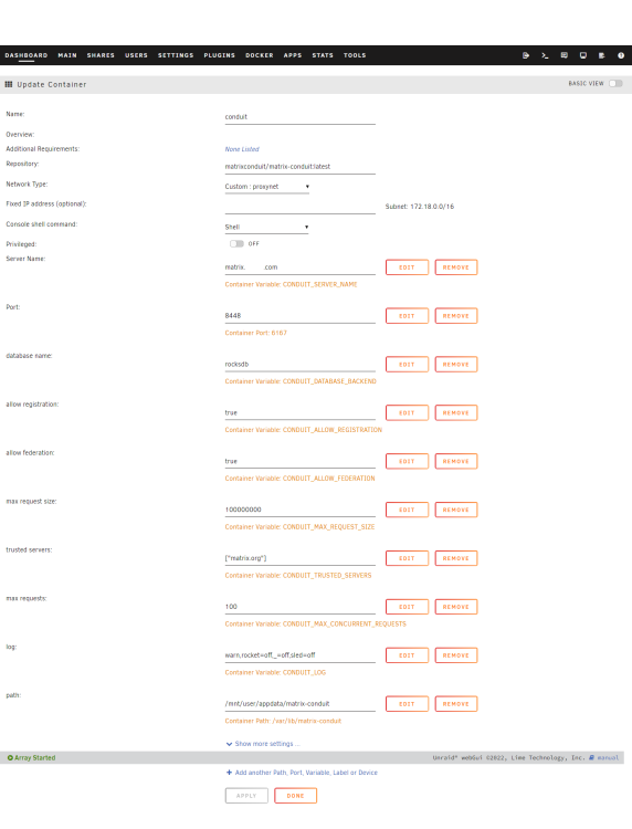

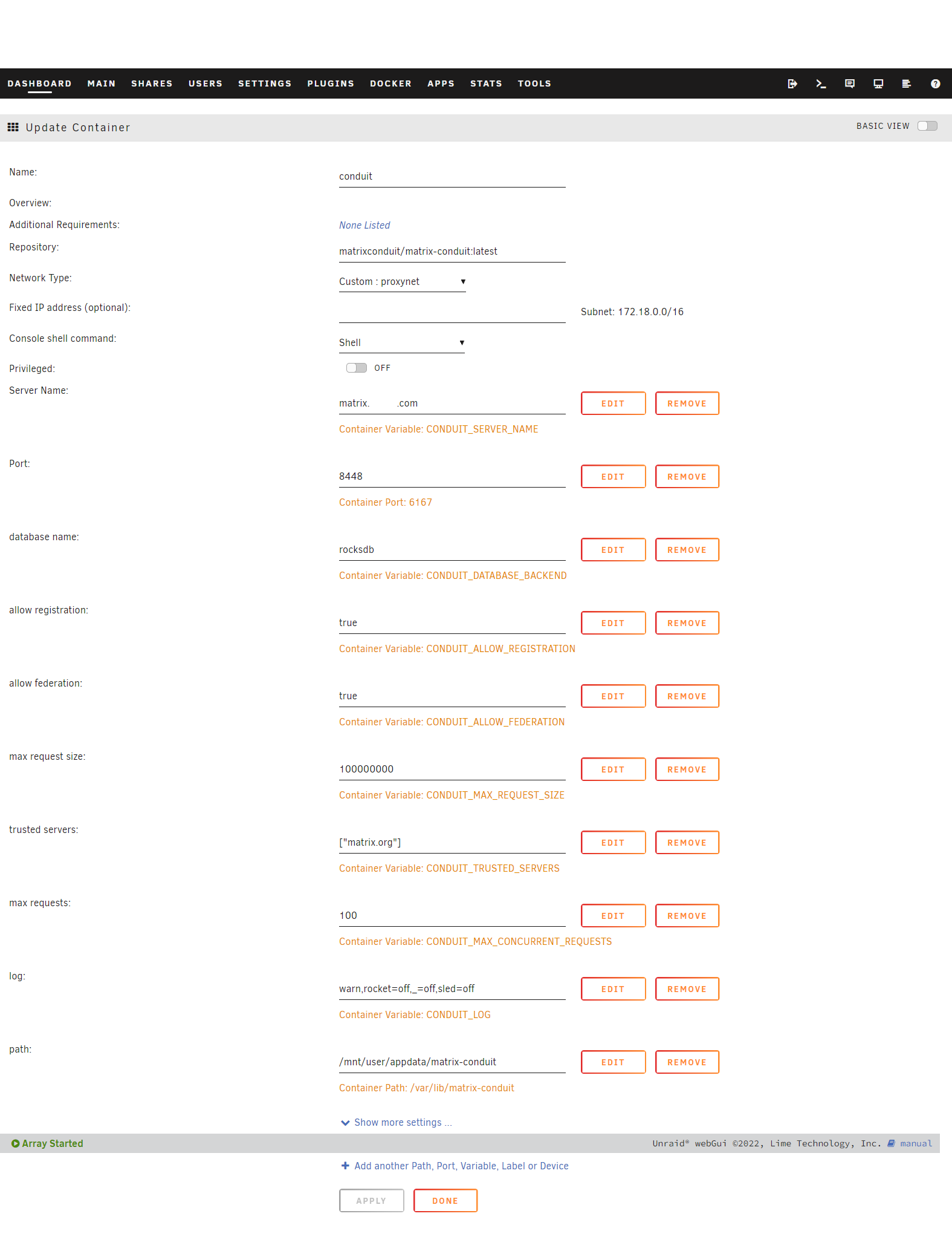

I was hoping to get some help with a docker I've recently added that I'd like to route through SWAG. I had to setup the Docker manually, here are the results of that Docker run:
-d
--name='conduit'
--net='proxynet' (<----- the unRaid Network I use for all my SWAG ssl connections)
-e TZ="America/Los_Angeles"
-e HOST_OS="Unraid"
-e HOST_HOSTNAME="rubble"
-e HOST_CONTAINERNAME="conduit"
-e 'CONDUIT_SERVER_NAME'='matrix.mydomain.com' (<---obfuscated)
-e 'CONDUIT_DATABASE_BACKEND'='rocksdb'
-e 'CONDUIT_ALLOW_REGISTRATION'='true'
-e 'CONDUIT_ALLOW_FEDERATION'='true'
-e 'CONDUIT_MAX_REQUEST_SIZE'='100000000'
-e 'CONDUIT_TRUSTED_SERVERS'='["matrix.org"]'
-e 'CONDUIT_MAX_CONCURRENT_REQUESTS'='100'
-e 'CONDUIT_LOG'='warn,rocket=off,_=off,sled=off'
-l net.unraid.docker.icon='https://raw.githubusercontent.com/mozilla/fxemoji/gh-pages/svgs/nature/u26A1-bolt.svg'
-p '8448:6167/tcp'
-v '/mnt/user/appdata/matrix-conduit':'/var/lib/matrix-conduit':'rw' 'matrixconduit/matrix-conduit:latest'
c9a300cad404e7a5e9d4298ec7a2413fd3e6c5650aa7deafdcb60e411501254c
I'm getting the "502 Bad Gateway nginx" error when I hit my subdomain, and that's an error with the SWAG conf.
screencapture-192-168-11-53-Dashboard-UpdateContainer-2023-03-07-13_57_58.thumb.png.70597f00b2c928f07c9eb6fef9f7e1d1.png
/mnt/user/appdata/swag/nginx/proxy-confs/conduit.subdomain.conf

Conduit is an implementation of Matrix chat server. There is no SWAG template for it; so I've been doing the best I can repurposing a different domain template over into this one, but I'm striking out.
My end goal here is to bring iMessage, Whatsapp, Signal, FB Messenger, IG Messenger, and SMS all into one chat app that will work on: iPhone, android, and my windows laptop. Probably with Element app.
Some notes so far
https://forums.unraid.net/topic/135799-love-to-1-ditch-iphone-2-keep-imessage-and-3-combine-all-messengers/#comment-1235564

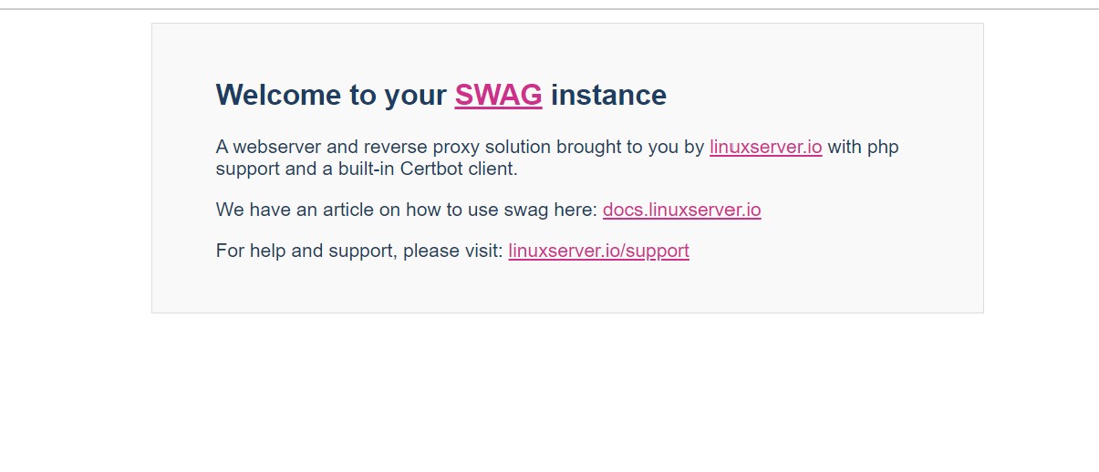

Hi guys. I had this running great last year but for reasons in my own stupid mind thought I would try out OMV. Now I have returned to unraid for the life of me I cannot get Bitwarden running. I have installed swag and it seems to be running correctly saying server is ready.
I don't have a domain so its going to my DDNS.
Following SpaceInvaders instructions carefully I thought I was golden but when I go to my DDNS address it resolves to SWAG and not to Bitwarden. I can get to bitwarden on LAN, via the unraid address, but its set to use proxy web, along with SWAG.
Spaceinvader offers a file download for 'subdomains' and skirts over this bit with barely any instruction, but I feel like I didn't need that file last time but perhaps I did?
IN any case can anyone offer a suggestion why it resolves to the swag home page and not bitwarden as its driving me dolally
Well I have been at this for hours. I simply cannot get it to resolve to my bitwarden. SWAG says server is running. I even changed to another DNS provider (duck) and again it says its functioning. I tried to adjust the vaultwarden conf file that SWAG creates to point to my DNS address (as instructed by spaceinviaderone) but this does not work and when I restart swag the conf file is overwritten by the original.
Obviously this is something I am doing wrong but any pointers would be helpful. I am following the instructions to the letter. the outcome is I see a welcome to swag not bitwarden.
