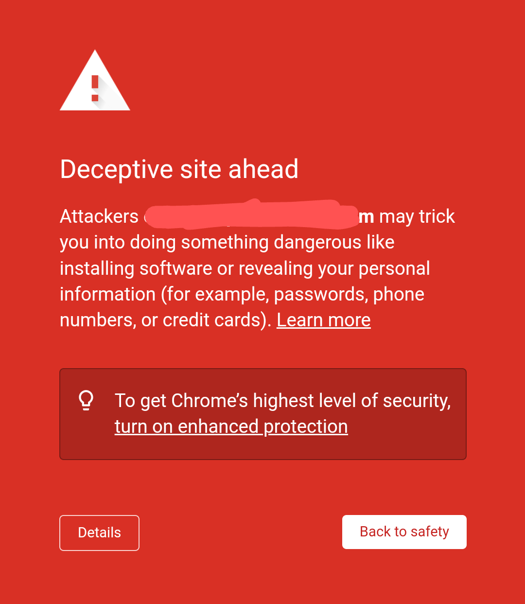

July 11, 20233 yr For the last couple days, every one of my reverse proxied docker containers now shows this. This is annoying enough for me, but friends trying to access pages I host for them are understandably worried I've been hacked, despite me assuring them this is some quirk of Google security monitoring or something. I've tried updating the SSL.conf in the swag appdata folder and uncommenting basically everything at the bottom of that, but it doesn't seem to be helping. How can I make this go away?
July 12, 20233 yr 3 hours ago, MikaelTarquin said: I've tried updating the SSL.conf in the swag appdata folder and uncommenting basically everything at the bottom of that, but it doesn't seem to be helping. How can I make this go away? what does the swag logs say, especially when you start the docker and it tries to refresh the certs ...

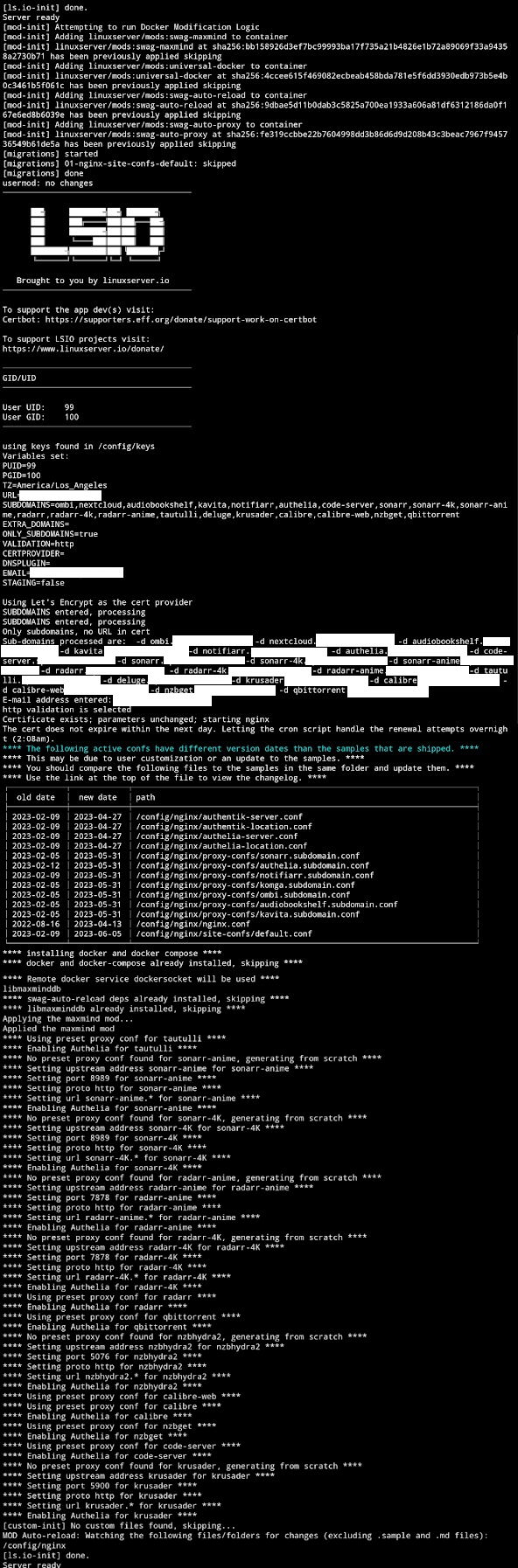

July 12, 20233 yr 14 hours ago, alturismo said: what does the swag logs say, especially when you start the docker and it tries to refresh the certs ... Sorry for the screenshot log, I don't have a better way at the moment of sharing it. It looks unchanged from what I remember it saying in the past. My nextcloud reverse proxy has stopped working (again, I swear that thing hates being reverse proxied more than anything), but I don't think that's related. I'm assuming an update broke it for the nth time.
July 13, 20233 yr 9 hours ago, MikaelTarquin said: It looks unchanged from what I remember it saying in the past. yep, swag and ssl cert refresh are looking fine. i guess this is nothing swag related, i would search for the error on self hosted sites and look what could cause this ... i see some different reasons and as im not using the services ... cant really help from my side, when i google it its now looking like you are flagged as malware ... sorry, may someone else can chim in if somebody else had this before, but i would search for it ...
July 13, 20233 yr 3 hours ago, alturismo said: yep, swag and ssl cert refresh are looking fine. i guess this is nothing swag related, i would search for the error on self hosted sites and look what could cause this ... i see some different reasons and as im not using the services ... cant really help from my side, when i google it its now looking like you are flagged as malware ... sorry, may someone else can chim in if somebody else had this before, but i would search for it ... All I've been able to find so far is some fairly unhelpful discussion about Security Headers, which I think by uncommenting the lines in the SSL configuration file, I've already done. Swag, duckdns, and namecheap are the only common threads I can think of. Bummer.

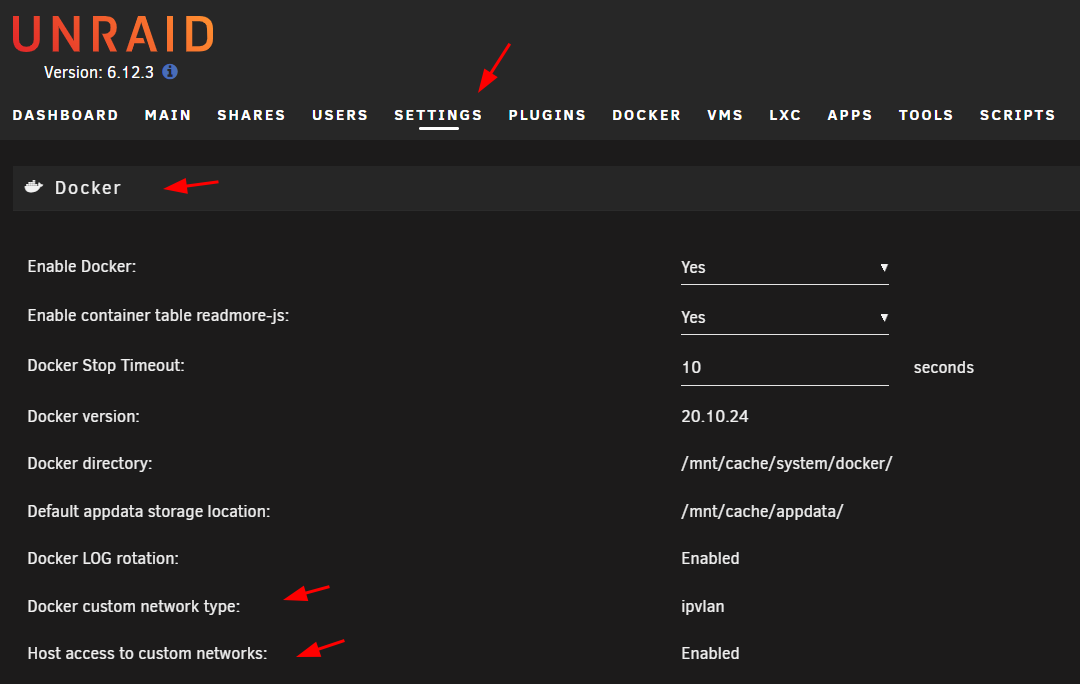

July 30, 20233 yr 9 hours ago, Smith007 said: How shall I approach this? I'm thinking some additional parameters for SWAG container would help? if so, shall I somehow make additional IPs available for the docker first? use custom br0 and assign your (free) ip to the docker, then its already listening in the default ports (as mapping is then obsolete). be aware of the macvlan / ipvlan issues which some have issues with ...
July 30, 20233 yr 2 hours ago, alturismo said: use custom br0 and assign your (free) ip to the docker, then its already listening in the default ports (as mapping is then obsolete). Thanks for your answer, but how exactly to assign an IP to the docker? Sorry, but this is the part I'm probably struggling with...
July 31, 20233 yr 4 hours ago, Smith007 said: but how exactly to assign an IP to the docker? may start reading your options docker, edit ... but ... please also read about it what else would be to set etc ... and how it behaves then ... as starter those 2 ... ans so on, also, this is not swag docker related, rather post or search in the general part/s.
