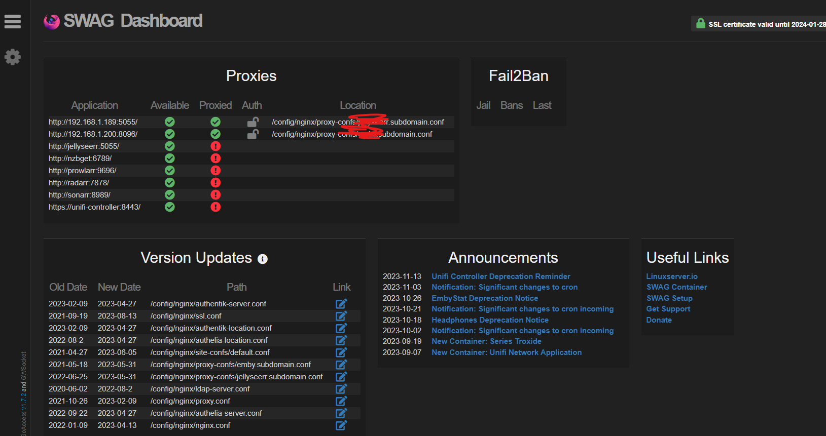

How can I clear the data from swag dashboard?
14 hours ago, Gaius-Baltar said:
Unfortunately, I could not find anything until now:
What is a swag dashboard? I must be missing something here.
its a dashboard from swag linuxserver.io, its a mod https://www.linuxserver.io/blog/introducing-swag-dashboard you can see fail2ban statistics or visits from where countries (ip adresses) your running applications etc.

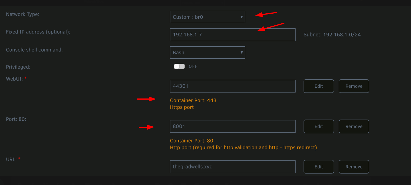

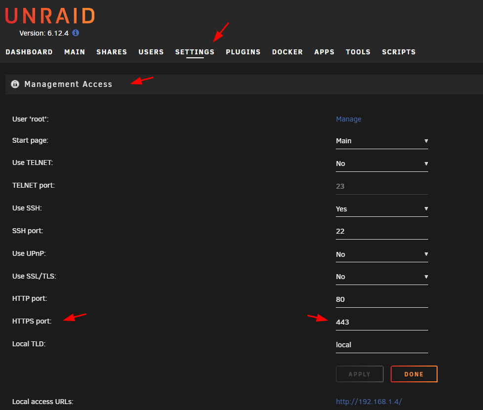

Upgraded Unraid to 6.12.4. Now, swag cannot start. It gives "Execution Error".
The reason is "Error starting userland proxy: listen tcp4 0.0.0.0:443: bind: address already in use." When I check with
> netstat -tunlp | grep ":443"
I get
tcp        0      0 127.0.0.1:443           0.0.0.0:*               LISTEN      15575/nginx: master
I think, Unraid's own nginx is also listening port 443.
How can I stop Unraid's nginx listening 443?
By the way, swag is on a custom docker network named "proxynet" together with all other dockers.
I didn't have this problem with Unraid 6.11.5.
Thanks.
change the SSL port as its not needed anyway if not in use
or change the mapping and the router forwarding rule.
and yes, 6.11 it was disabled when SSL was disabled, in 6.12 port 443 is also listening even with SSL disabled.

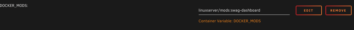

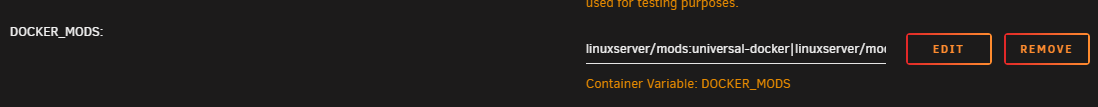

On 11/7/2023 at 11:58 PM, vw-kombi said:
I did understand all that - but I still could not get it to work - likely as I have no way of doing the dns rewrite on my systems here.
Pls tell me what you've done :)
There is not really much to it - but as I said, I doubt mine would work due to not having a capability to rewrite the DNS to my ip address - as my router cant do it, and I dont have adguard or pihole on the network running - i may try again but I can elaborate on the instructions a bit for you for unraid - you saw the  instructiuon here -

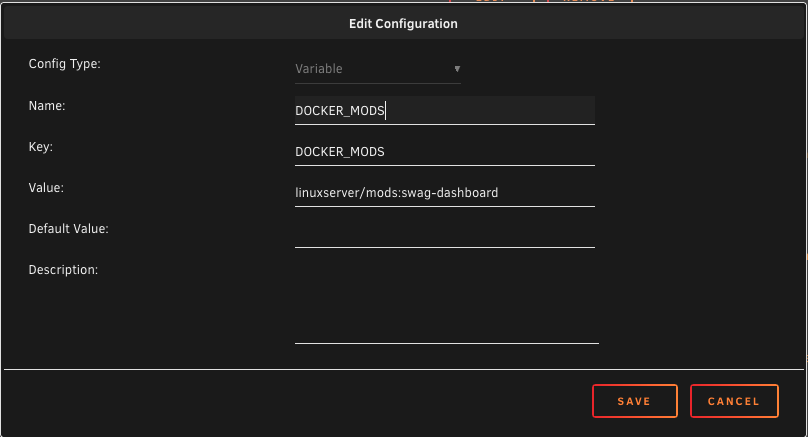

https://github.com/linuxserver/docker-mods/tree/swag-dashboard
1 - set an environment variable DOCKER_MODS=linuxserver/mods:swag-dashboard.  Edit the container in unraid, and add the linuxserver/mods:swag-dashboard to the list of DOCKER_MODS.  I use a number of docker mods already for other things, so I get to add it with | to seperate them.  Mine looks like this - note I added mine ages ago for other config things I wanted.  Maybe watch the swag youtube tutorial from IBRACORP for detailes setup of this  :
This is the line :
And mine looks like this as I use cloudflare, maxmind and crowdsec also - note the extra bit on the end for this swag dashboard after the extra | :
linuxserver/mods:universal-docker|linuxserver/mods:swag-cloudflare-real-ip|linuxserver/mods:swag-maxmind|ghcr.io/linuxserver/mods:swag-crowdsec|linuxserver/mods:swag-dashboard

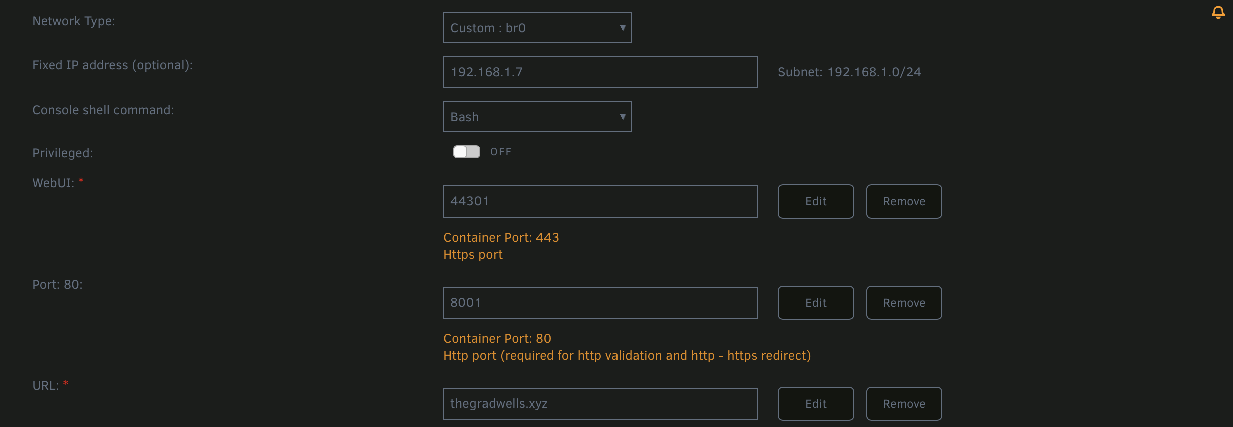

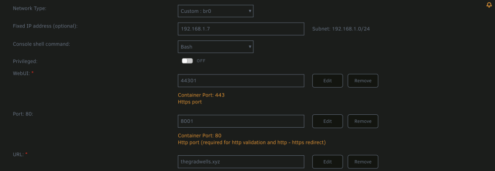

2 - Add a mapping of 81:81 to swag's docker run command or compose
This means to edit the swag docker container in unraid, scroll to bottom, click add another path, port, valriable, lable or device,
Then change config type to port, then set the name and the host port to 81 :
so you then have this at the end of the config :
Thats it for the docker container edits to activate all this -  the container will restart (or do it manually), then check the logs for it, and you will see loading the mod :
The last bit is the DNS re-write - which is done so that when in your browser you enter dashboard.yourdomain.com, it goes to the IP address of your swag container (in my case as I have an IP address for my container for firewalling etc etc etc.  This is the bit I have not (cannot) do so I cant actually test any of this.  Hope to get that last bit done at some stage.
Edit - I have however tested locally with 192.168.1.5:81 and this brings up the dashboard.  .5 is my ip address of the swag container.  As I dont expect to open this out to the world, this is good enough for me :

/run/s6/basedir/scripts/rc.init: fatal: stopping the container.
/docker-mods: line 20: syntax error: bad substitution
/run/s6/basedir/scripts/rc.init: warning: hook /docker-mods exited 2
s6-rc-oneshot-run: fatal: unable to exec /etc/s6-overlay/s6-rc.d/init-migrations/run: Exec format error
s6-rc-oneshot-run: fatal: unable to exec /etc/s6-overlay/s6-rc.d/init-envfile/run: Exec format error
s6-rc: warning: unable to start service init-migrations: command exited 126
s6-rc: warning: unable to start service init-envfile: command exited 126
/run/s6/basedir/scripts/rc.init: warning: s6-rc failed to properly bring all the services up! Check your logs (in /run/uncaught-logs/current if you have in-container logging) for more information.
Any help would be greatly appreciated.

Hello I'm trying to add dashboard to my swag docker on UNRAID, I have attached my configuration for the addons.
However when I start the container shows this error:
[mod-init] Attempting to run Docker Modification Logic
[mod-init] Adding linuxserver/mods:swag-dashboard to container
[mod-init] linuxserver/mods:swag-dashboard could not be found on lscr.io
[migrations] started
[migrations] 01-nginx-site-confs-default: skipped
[migrations] done
What am I doing wrong?

Hi guys,
Hopefully you can help me. I had unRAID running on a HP MicroServer for a few years with no issues. However I've recently upgraded to a Dell R720 so I could increase my storage and install a Nvidia Tesla P4 for Hardware transcoding in Plex. However Im running into an issue that I did not experience on the HP. For some reason UnRAID refuses to use ports that I assign to docker containers. It uses its own and ignores the ports I enter in the container configs.
Any ideas where I might me going wrong?
My main issue at the moment is that I am running Audiobookshelf UnRAID App for my audiobooks and I have assigned its port as 13378 but it ignores that and uses port 80, I am also using SWAG App from the unRAID App Store and that too is ignoring my assigned ports I entered during its installation from port 80 to port 8001.
Edited by GradwellZA
Misspelt Audiobookshelf
when using custom br0 all port mappings are obsolete as not needed anymore as all dockers running on their own LAN IP and wont conflicht anyhow ... was all the time like this.

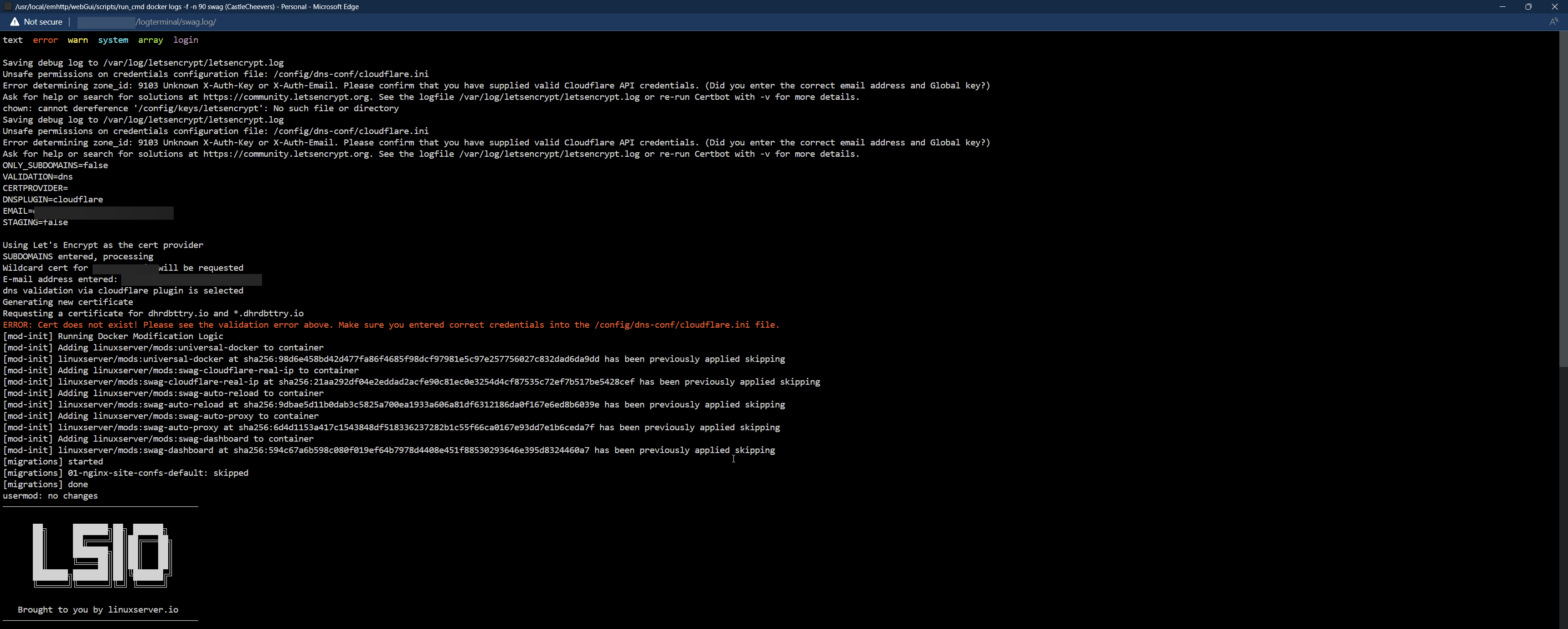

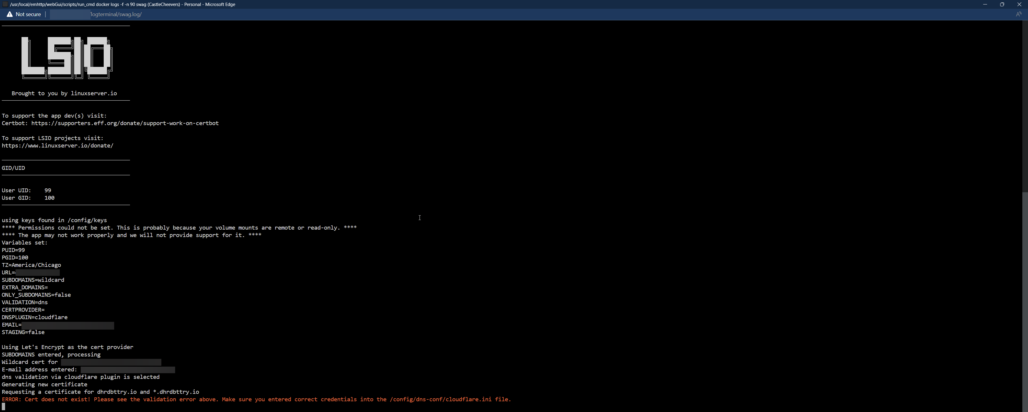

Requesting a certificate for ******** and 3 more domains
ERROR: Cert does not exist! Please see the validation error above. The issue may be due to incorrect dns or port forwarding settings. Please fix your settings and recreate the container

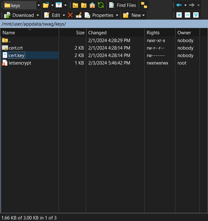

I'm having an issue whereby my certs are no longer auto-renewing. I had the cron set for 20:30 each night to check and renew if necessary, but for whatever reason, it recently stopped using the specified cron time and is now using the default 2:08am time (a time that my server is powered off.)
Appdata/swag/crontabs/root:
30 20 * * * /app/le-renew.sh >> /config/log/letsencrypt/letsencrypt.log 2>&1
cronjob running on Mon Nov 20 20:30:00 GMT 2023
Running certbot renew
Saving debug log to /var/log/letsencrypt/letsencrypt.log
Processing /etc/letsencrypt/renewal/mydomain.conf
Certificate not yet due for renewal
The following certificates are not due for renewal yet:
  /etc/letsencrypt/live/mydomain/fullchain.pem expires on 2024-01-14 (skipped)
No renewals were attempted.
cronjob running on Tue Jan  2 02:08:00 GMT 2024
  /etc/letsencrypt/live/mydomain/fullchain.pem expires on 2024-03-26 (skipped)
^^^ You can see here that things USED to run normally for me at 20:30, but more recently it's back to 02:08 and the cron time specified above isn't being used.
Has anyone ANY idea how to fix this? I really don't want to wait for cert expiry reminder emails and then have to manually renew them with certbot.
Would appreciate any help, thanks
Edited by Unrayed
