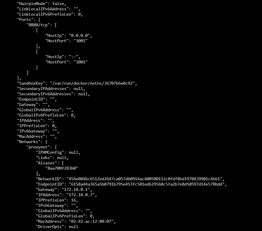

April 7, 20242 yr I have gone through everything I can find and can't seem to find my error. I'm sure it's something silly but I can't figure out what it is. When I go to immich.mydomain.com I get a 502 error. Other custom domains work without issue. My nginx error log contains the following 2024/04/05 14:42:43 [error] 709#709: *350 connect() failed (111: Connection refused) while connecting to upstream, client: 192.168.1.1, server: immich.*, request: "GET /favicon.ico HTTP/2.0", upstream: "http://172.18.0.7:3001/favicon.ico", host: "immich.mydomain.com", referrer: "https://immich.mydomain.com/" The docker container that is hosting immich looks like the following and the docker container is on the same custom network as my swag instance. What am I missing?

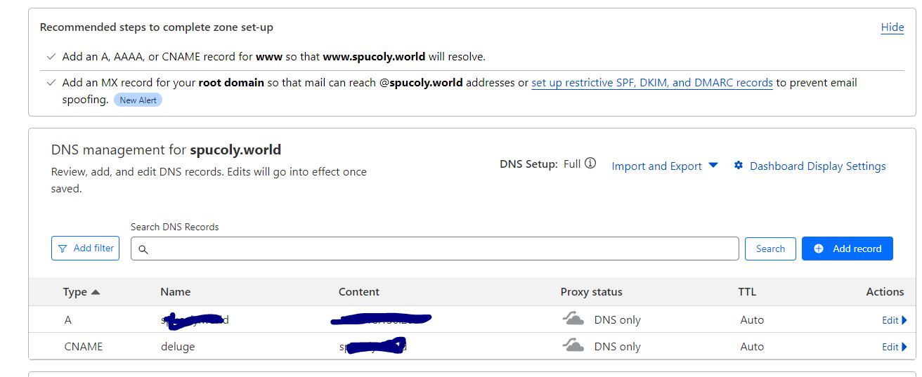

April 22, 20242 yr So after a total loss of half of my drives I am trying to reconfigure Sawg to work with Deluge. I have done this many times with no issue. No matter what I do all I get is a ERR_CONNECTION_REFUSED when navigating to the address. Ports 80 and 443 are forwarded to the ports on swag correctly. I am using Cloudflare. Both dockers are on the same custom docker network and preserve user defined network is set the true. Any help would be much appreciated. tower-diagnostics-20240422-1646.zip deluge.subdomain.conf

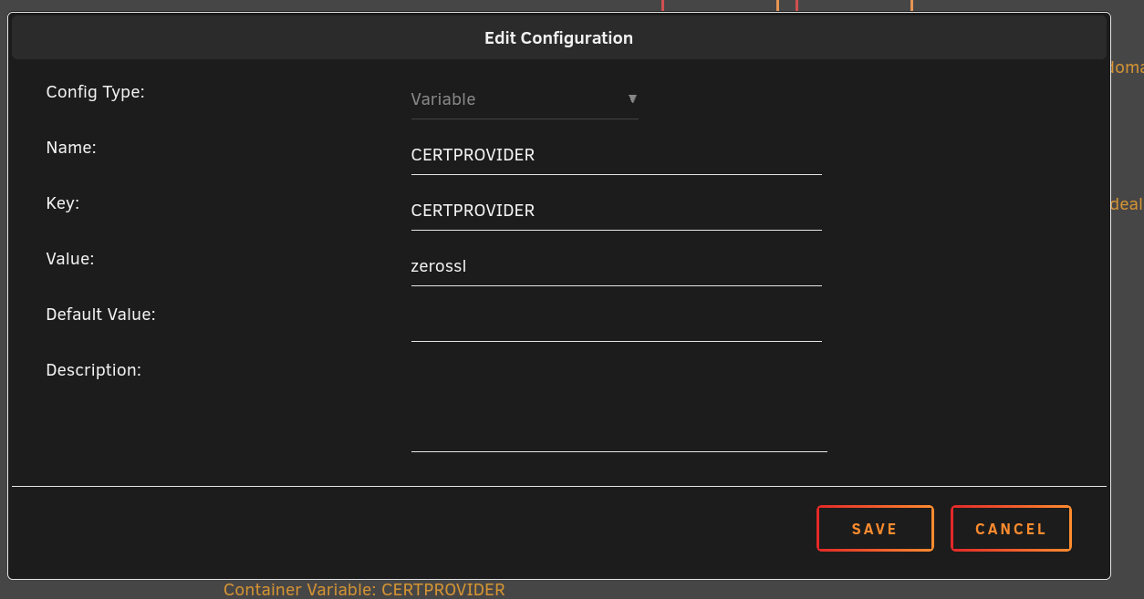

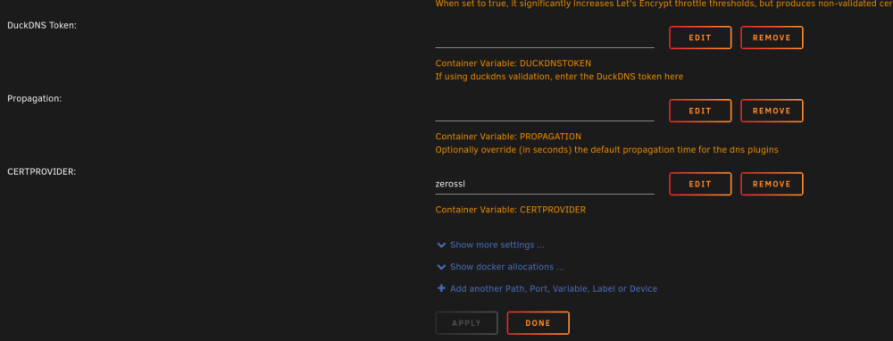

April 25, 20242 yr On 4/4/2024 at 8:40 AM, Ben4 said: I was able to renew my certs using Zerossl instead of Letsencrypt. I was waiting for an update, but I need my Nextcloud site back up. Per Swag support site How to switch from Letsencrypt to Zerossl: https://docs.linuxserver.io/general/swag/#authorization-method "SWAG currently defaults to Let's Encrypt as the cert provider so as not to break existing installs, however users can override that behavior by setting the environment variable CERTPROVIDER=zerossl to retrieve a cert from ZeroSSL instead. The only gotcha is that ZeroSSL requires the EMAIL env var to be set so the certs can be tied to a ZeroSSL account for management over their web interface." Stop swag, then edit your Swag container and add the variable CERTPROVIDER ( i have attached screenshots). Then hit apply and start your container. Open the log viewer to make sure Swag has switched to Zerossl and has successfully renewed your certs. I also restarted my Nextcloud and Collobora containers, so restart any containers that use Swag. Letsencrypt is now requiring secondary validation of your domains from other locations. Basically this means that letsencrypt will start a web server, try to connect to your domains from some external locations, before validating your domain and issuing you a cert if your validation method is set to http. Issue is there are a lot of different firewall configurations and nginx configurations. In @MxFox case his firewall is blocking one of the secondary validation cloudflare locations https://community.letsencrypt.org/t/unexpected-renewal-failures-during-april-2024-please-read-this/216830 https://letsencrypt.org/docs/challenge-types/#http-01-challenge http://<YOUR_DOMAIN>/.well-known/acme-challenge/<TOKEN> Looks like both your cases are failing validation at on the HTTP-01 challenge. As am I, but with different reasons. In my case, I have my nginx configured to hit Authelia for SSO signon but that is messing things up on all subdomains because the webserver that letsecrypt spins up to answer validation requests are being blocked my Authelia. I switched to DNS validation using Cloudflare and that works fine now Edited April 29, 20242 yr by chanrc
