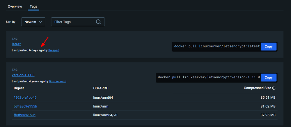

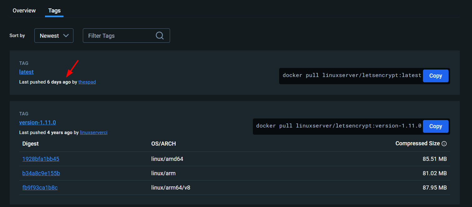

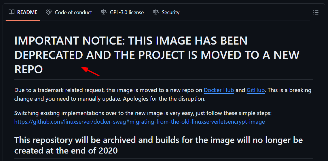

July 31, 20242 yr Nobody know, why suddenly the deprecated Letsencrypt got a new update? Is it re-maintened?
August 1, 20242 yr 6 hours ago, hundsboog said: Nobody know, why suddenly the deprecated Letsencrypt got a new update? Is it re-maintened? nope, rather ask this where lsio is active, sample, their discord its still marked deprecated ... but yes, there was a update last week

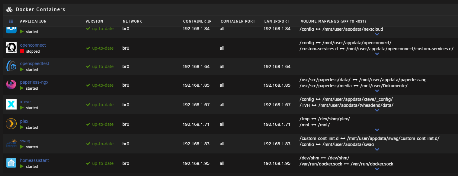

November 25, 20241 yr I am testing SWAG and have it setup in bridge mode and was wanting to set it to a static IP like i do with all my dockers on br0 network. Can SWAG use a static IP instead of being set to bridge mode? If so what is the best way to do this? Thank you Edited November 25, 20241 yr by JM2005
November 25, 20241 yr 10 hours ago, JM2005 said: Can SWAG use a static IP instead of being set to bridge mode? sure 10 hours ago, JM2005 said: If so what is the best way to do this? the same like 10 hours ago, JM2005 said: like i do with all my dockers on br0 network. where is your issue if you ask like this ?
November 25, 20241 yr I have a working swag setup currently using the network bridge setting and i wish to switch this (swag docker) setting to a static IP on network br0. When i attempt to switch it to br0 network and give swag itself a static IP i cannot access my sites. Any ideas to how i can do this? Thank you.
November 25, 20241 yr 2 hours ago, JM2005 said: When i attempt to switch it to br0 network and give swag itself a static IP i cannot access my sites. Any ideas to how i can do this? well, how is a site setup look like ... as sample you prolly use the pre configured ones from ../proxy-confs do you use ip's as target or names, may try ip ... are your target apps also running in custom_br0 ... so your targetting should be the default ports which should be fine anyway

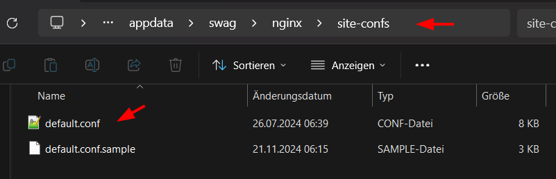

November 25, 20241 yr Yeah I used the swags pre-configured proxy’s files and use each apps static docker ip and those work great with swag setup as bridge. I was just thinking of switching the swag docker to a static ip as well. I have another question as well. How would I turn off the swag landing page? I would like it to just return a 444 or 403 if possible and just be able to access my otter stuff. Thank you for your help.
November 26, 20241 yr 8 hours ago, JM2005 said: Yeah I used the swags pre-configured proxy’s files and use each apps static docker ip and those work great with swag setup as bridge. I was just thinking of switching the swag docker to a static ip as well. there is nothing special todo when using br0 mode ... i have all my dockers on br0 ... sample 8 hours ago, JM2005 said: I have another question as well. How would I turn off the swag landing page? I would like it to just return a 444 or 403 if possible and just be able to access my otter stuff. what you see is the default page, may look into read into how to change the default behaviours # redirect all traffic to https server { listen 80 default_server; listen [::]:80 default_server; location / { return 301 https://$host$request_uri; } } ... .. . # main server block server { listen 443 ssl default_server; listen [::]:443 ssl default_server; server_name _; include /config/nginx/ssl.conf; root /config/www; index index.html index.htm index.php; # enable subfolder method reverse proxy confs include /config/nginx/proxy-confs/*.subfolder.conf; ... .. . you will find many ways to either redirect to "nothing" or a custom "404 page" or ... but be sensitive and beware what you do, keep the steps in mind (backups) so you can always move back and so on ... and yes, you should read into it and not just copy / paste code without knowing what you do there ... so i wont just write a sample here, go into it to understand ... its your "door" to your home from outside, so you should really know what you do.

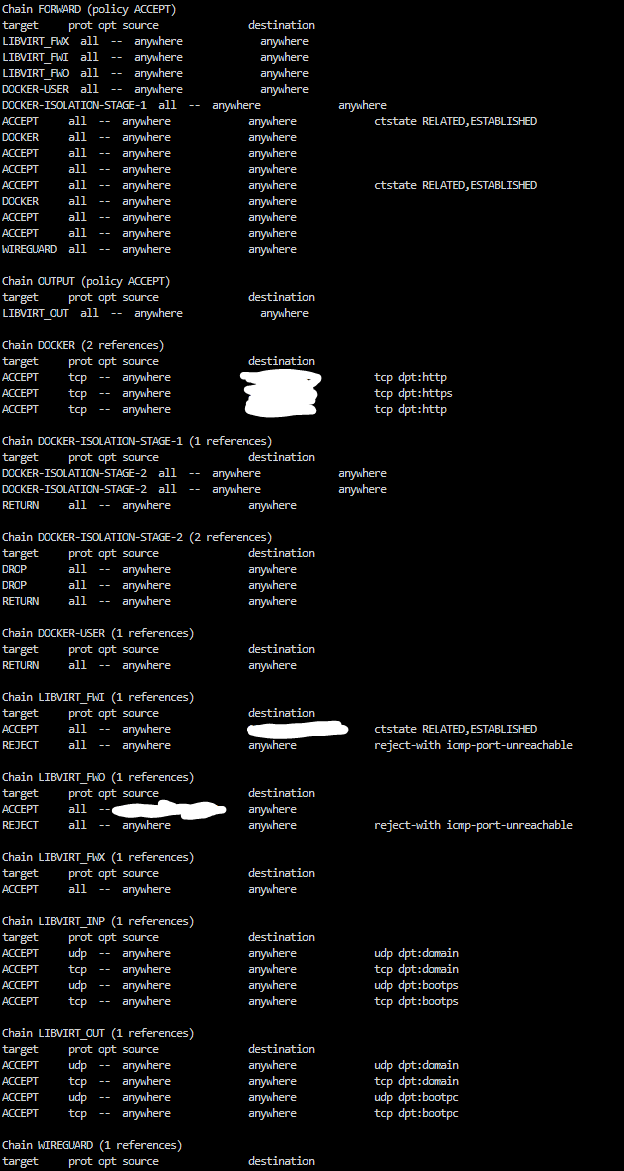

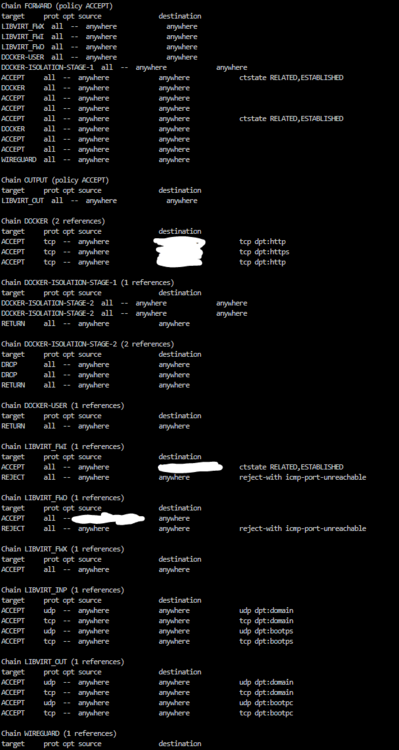

December 14, 20241 yr I'm very confused where I am going wrong with setting up fail2ban on SWAG reverse proxy. I am using the fail2ban included with SWAG. I have looked up every guide I could find regarding SWAG, fail2ban, Docker, and tried all fixes to get fail2ban to work, to no avail. The fail2ban properly see's the login attempts to Vaultwarden, and after max retries bans the IP, but the IP is still able to access the service. I am using a Cloudflare tunnel to accept connection, so in SWAG I use Cloudflare real IP and have confirmed the banned IP's to be actual user IP's. I believe the problem resides somewhere with iptables, but lack the knowledge to know for sure. I've attached all images that could be of any use to solve this issue. Is there anything I am doing wrong? Thank you.
December 26, 20241 yr On 12/14/2024 at 7:07 AM, GayMan420 said: I'm very confused where I am going wrong with setting up fail2ban on SWAG reverse proxy. I am using the fail2ban included with SWAG. I have looked up every guide I could find regarding SWAG, fail2ban, Docker, and tried all fixes to get fail2ban to work, to no avail. The fail2ban properly see's the login attempts to Vaultwarden, and after max retries bans the IP, but the IP is still able to access the service. I am using a Cloudflare tunnel to accept connection, so in SWAG I use Cloudflare real IP and have confirmed the banned IP's to be actual user IP's. I believe the problem resides somewhere with iptables, but lack the knowledge to know for sure. I've attached all images that could be of any use to solve this issue. Is there anything I am doing wrong? Thank you. banaction = iptables-multiport [Vaultwarden] enabled = true port = https filter = bitwarden logpath = /log/vaultwarden.log maxretry = 1 bantime = 14400 findtime = 14400 [Definition] _daemon = Bitwarden-Identity failregex = ^%(__prefix_line)s\s*\[(?:W(?:RN|arning)|Bit\.Core\.[^\]]+)\]\s+Failed login attempt(?:, 2FA invalid)?\. <ADDR>$ failregex = ^.*Username or password is incorrect\. Try again\. IP: <ADDR>\. Username:.*$ This is mine and here it works. Edited December 26, 20241 yr by KoNeko
