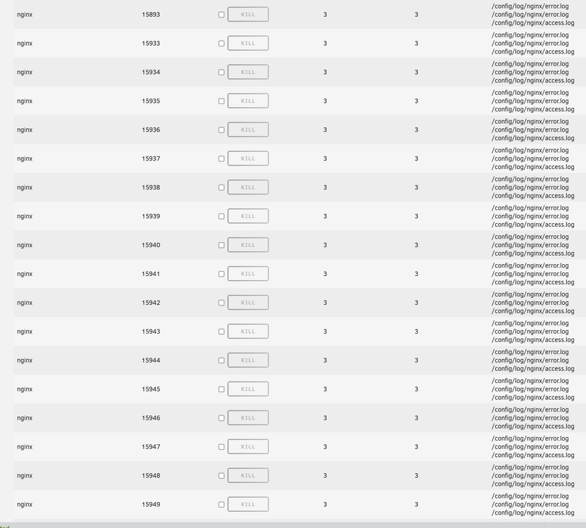

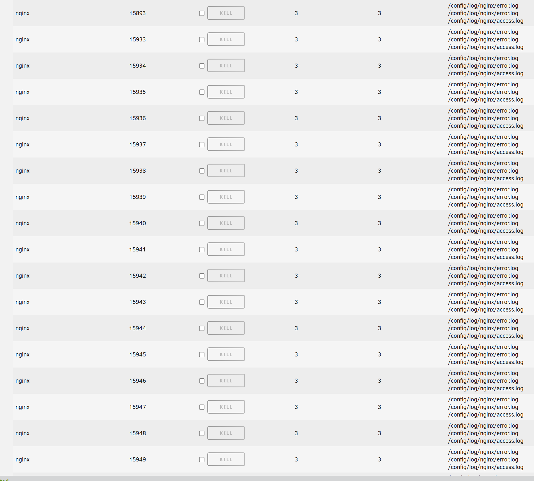

March 17, 20251 yr Hi, I´ve tried to secure npm with fail2ban from @linuxserver.io / lscr.io/linuxserver/fail2ban fail2ban triggers IPs correctly: IPv4: 2025-03-16 15:12:25,087 146D00D56B38 INFO [npm] Found 80.187.xxx - 2025-03-16 15:12:24 2025-03-16 15:12:43,834 146D00D56B38 INFO [npm] Found 80.187.xxx - 2025-03-16 15:12:43 2025-03-16 15:12:49,078 146D00D56B38 INFO [npm] Found 80.187.xxx - 2025-03-16 15:12:49 2025-03-16 15:12:49,177 146D00B4BB38 NOTIC [npm] Ban 80.187.xxx 2025-03-16 15:12:49,195 146D00B4BB38 ERROR 146d01b5fd20 -- exec: { iptables -w -C f2b-npm -j RETURN >/dev/null 2>&1; } || { iptables -w -N f2b-npm || true; iptables -w -A f2b-npm -j RETURN; } for proto in $(echo 'tcp' | sed 's/,/ /g'); do { iptables -w -C DOCKER-USER -p $proto -m multiport --dports 12345 -j f2b-npm >/dev/null 2>&1; } || { iptables -w -I DOCKER-USER -p $proto -m multiport --dports 12345 -j f2b-npm; } done 2025-03-16 15:12:49,196 146D00B4BB38 ERROR 146d01b5fd20 -- stderr: 'iptables: No chain/target/match by that name.' 2025-03-16 15:12:49,196 146D00B4BB38 ERROR 146d01b5fd20 -- returned 1 2025-03-16 15:12:49,196 146D00B4BB38 ERROR Failed to execute ban jail 'npm' action 'iptables-multiport' info 'ActionInfo({'ip': '80.187.xxx', 'family': 'inet4', 'fid': <function Actions.ActionInfo.<lambda> at 0x146d01b85a80>, 'raw-ticket': <function Actions.ActionInfo.<lambda> at 0x146d01b86200>})': Error starting action Jail('npm')/iptables-multiport: 'Script error' IPv6: 2025-03-16 15:05:59,104 146D00D56B38 INFO [npm] Found 2003:da:xxx - 2025-03-16 15:05:58 2025-03-16 15:06:02,336 146D00D56B38 INFO [npm] Found 2003:da:xxx - 2025-03-16 15:06:01 2025-03-16 15:06:09,597 146D00D56B38 INFO [npm] Found 2003:da:xxx - 2025-03-16 15:06:09 2025-03-16 15:06:10,344 146D00B4BB38 NOTIC [npm] Ban 2003:da:xxx 2025-03-16 15:06:10,379 146D00B4BB38 ERROR 146d01b796f0 -- exec: { ip6tables -w -C f2b-npm -j RETURN >/dev/null 2>&1; } || { ip6tables -w -N f2b-npm || true; ip6tables -w -A f2b-npm -j RETURN; } for proto in $(echo 'tcp' | sed 's/,/ /g'); do { ip6tables -w -C DOCKER-USER -p $proto -m multiport --dports 12345 -j f2b-npm >/dev/null 2>&1; } || { ip6tables -w -I DOCKER-USER -p $proto -m multiport --dports 12345 -j f2b-npm; } done 2025-03-16 15:06:10,381 146D00B4BB38 ERROR 146d01b796f0 -- stderr: 'ip6tables: No chain/target/match by that name.' 2025-03-16 15:06:10,382 146D00B4BB38 ERROR 146d01b796f0 -- returned 1 2025-03-16 15:06:10,383 146D00B4BB38 ERROR Failed to execute ban jail 'npm' action 'iptables-multiport' info 'ActionInfo({'ip': '2003:da:xxx', 'family': 'inet6', 'fid': <function Actions.ActionInfo.<lambda> at 0x146d01b85a80>, 'raw-ticket': <function Actions.ActionInfo.<lambda> at 0x146d01b86200>})': Error starting action Jail('npm')/iptables-multiport: 'Script error' it seems that the fail2ban container can´t access iptables, although it has privileged rights. jail.local: [DEFAULT] bantime = 4h maxretry = 3 [npm] enabled = true port = 12345 backend = polling logpath = /var/log/proxy-host-*_error.log chain = DOCKER-USER action = %(known/action)s any ideas? unraid 7.0.1

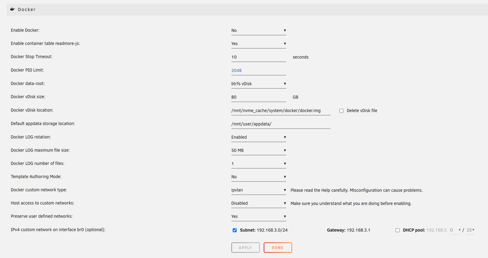

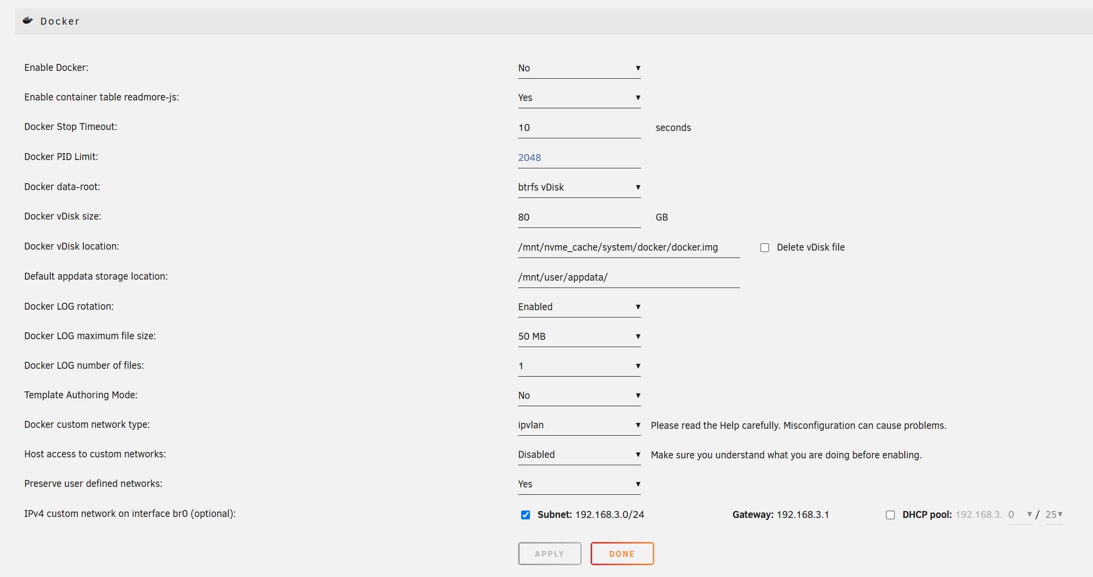

April 30, 20251 yr It would appear that ngnix is unable to resolve dns. /etc/resolv.conf nameserver 127.0.0.11 options ndots:0 This appears to point to the docker dns which should in return point to the host dns. The host dns resolves. I cant seem to change the /etc/resolv.conf file in swag as each time I change it then restart swag it recreates itself. I can't figure out why the docker container is unable to resolve dns if the host can. This is a relatively new occurrence and I haven't changed anything in swag or unraid other then the pushed updates. Any help would be appreciated host dns below root@Server:~# dig A r3.o.lencr.org @1.1.1.1 +short dig A r3.o.lencr.org @1.0.0.1 +short dig A r3.o.lencr.org @8.8.8.8 +short o.lencr.edgesuite.net. a1887.dscq.akamai.net. 104.100.168.73 104.100.168.115 o.lencr.edgesuite.net. a1887.dscq.akamai.net. 104.103.68.73 104.103.68.105 ; <<>> DiG 9.16.42 <<>> A r3.o.lencr.org @8.8.8.8 +short ;; global options: +cmd ;; connection timed out; no servers could be reached Edited April 30, 20251 yr by xokia
April 30, 20251 yr I remember having something similar for another container. It’s was a while back and not swag. I googled it and maybe I did this - Configure DNS for Docker Containers Docker containers may not inherit the host's DNS settings. To force proper DNS resolution for containers: Edit the Docker daemon configuration file: Go to Settings > Docker in Unraid. Under "Docker custom network DNS server", add 1.1.1.1 and 8.8.8.8. *Sometimes a network reload helps here: /etc/rc.d/rc.docker restart
May 3, 20251 yr Now I am confused if I ping the offending address from the swag container it resolves! Maybe there is something wrong with letsencrypt? I know my error log is full of these it appears it tries every 5 min or so. 2025/05/02 18:14:06 [error] 961#961: e6.o.lencr.org could not be resolved (110: Operation timed out) while requesting certificate status, responder: e6.o.lencr.org, certificate: "/config/keys/cert.crt" 2025/05/02 18:19:46 [error] 969#969: e6.o.lencr.org could not be resolved (110: Operation timed out) while requesting certificate status, responder: e6.o.lencr.org, certificate: "/config/keys/cert.crt" 2025/05/02 18:19:58 [error] 970#970: e6.o.lencr.org could not be resolved (110: Operation timed out) while requesting certificate status, responder: e6.o.lencr.org, certificate: "/config/keys/cert.crt" PING e6.o.lencr.org (23.32.152.232): 56 data bytes 64 bytes from 23.32.152.232: seq=0 ttl=45 time=29.889 ms 64 bytes from 23.32.152.232: seq=1 ttl=45 time=30.711 ms 64 bytes from 23.32.152.232: seq=2 ttl=45 time=29.913 ms 64 bytes from 23.32.152.232: seq=3 ttl=45 time=30.170 ms 64 bytes from 23.32.152.232: seq=4 ttl=45 time=29.624 ms 64 bytes from 23.32.152.232: seq=5 ttl=45 time=30.873 ms 64 bytes from 23.32.152.232: seq=6 ttl=45 time=29.585 ms ^C --- e6.o.lencr.org ping statistics --- 7 packets transmitted, 7 packets received, 0% packet loss round-trip min/avg/max = 29.585/30.109/30.873 ms Edited May 3, 20251 yr by xokia

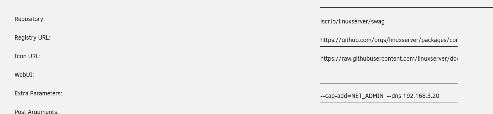

May 3, 20251 yr 13 hours ago, vw-kombi said: Stop docker, then try the above settings. I run my own dns server .20 is my dns server. I tried manually adding the dns to the swag container. I also tried --dns 8.8.8.8 --dns 1.1.1.1 made zero difference. There is no option for custom dns server under the docker setting Edited May 3, 20251 yr by xokia

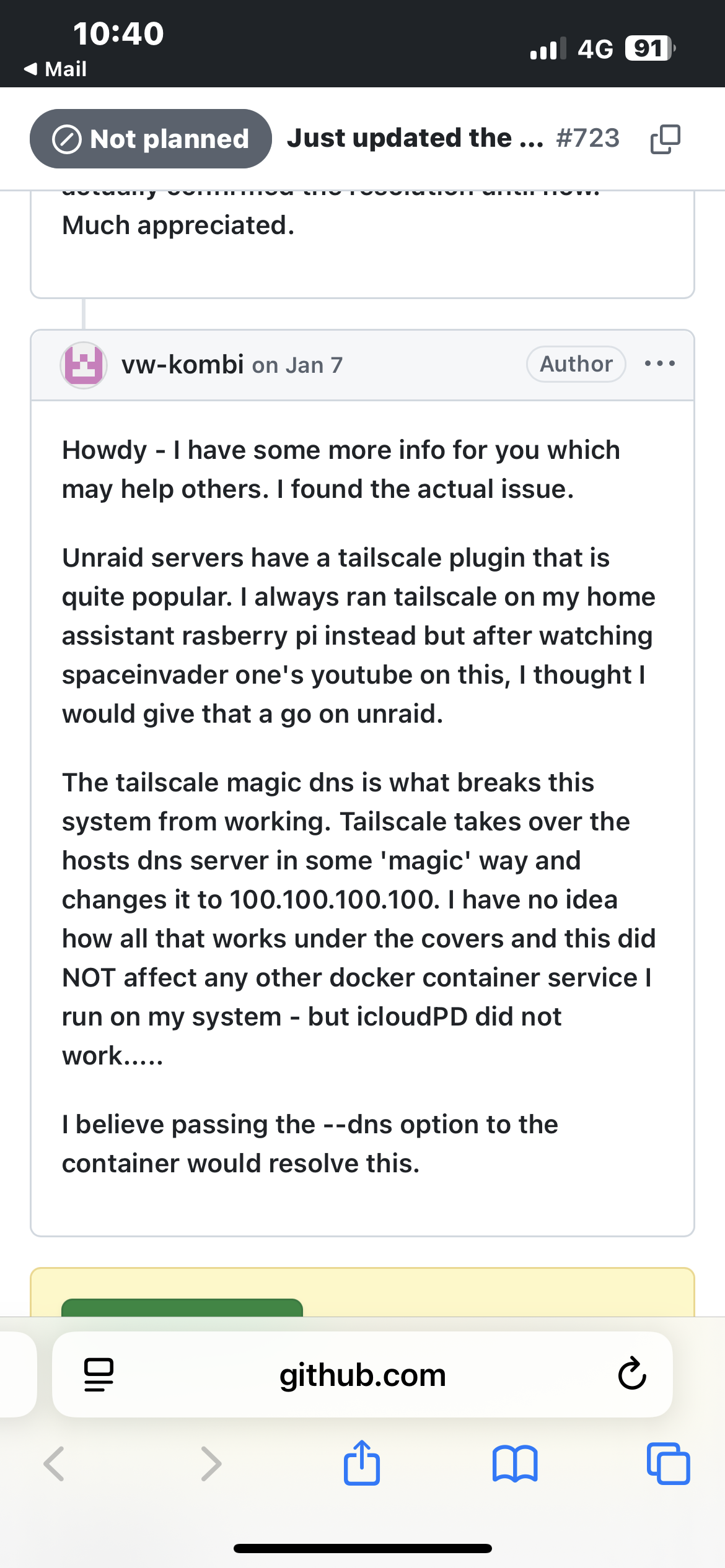

May 4, 20251 yr I found where I had this exact same issue. It was with the iCloudPD container. Reason I could not find it here was I posted on their discord support. issue was the tailscale plugin. i uninstalled that and dns worked again. attaching screenshot of my post. Something to do with magic dns.
May 4, 20251 yr 14 hours ago, vw-kombi said: I found where I had this exact same issue. It was with the iCloudPD container. Reason I could not find it here was I posted on their discord support. issue was the tailscale plugin. i uninstalled that and dns worked again. attaching screenshot of my post. Something to do with magic dns. The plugin disables Tailscale DNS by default. Unfortunately, one of the popular video tutorial makers put out a video a while back that directed people to turn it on, which is probably why you had the issue.

May 5, 20251 yr 13 hours ago, EDACerton said: The plugin disables Tailscale DNS by default. Unfortunately, one of the popular video tutorial makers put out a video a while back that directed people to turn it on, which is probably why you had the issue. Dunno about that - I never did any config to it, or watched any youtubes, just installed it one day, did the setup, then a few days later realised icloudPD container was not working. All other containers were working fine, just not that one. Uninstalled plugin, it works again, I tried installing it again to prove that was it, and it stopped again - never installed it again (I have tailscale with advertise routes on another always on machine (my home assistant and CCTV system) - so its not really needed on unraid.
