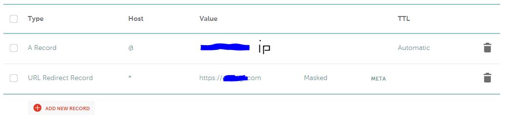

August 9, 20179 yr 59 minutes ago, CHBMB said: AFAIK only port 443 is required Sent from my LG-H815 using Tapatalk Ok. I know this is beyond the scope of support for this docker, so any help would be appreciated. I have a domain with namecheap and an A record pointing to my IP address. Would having a URL redirect record https://mydomain.com suffice? Reason I'm asking is because I'm getting a "connection refused" error and even though my ISP blocks port 80, I thought redirecting to https would force port 443 (which is open on my server)

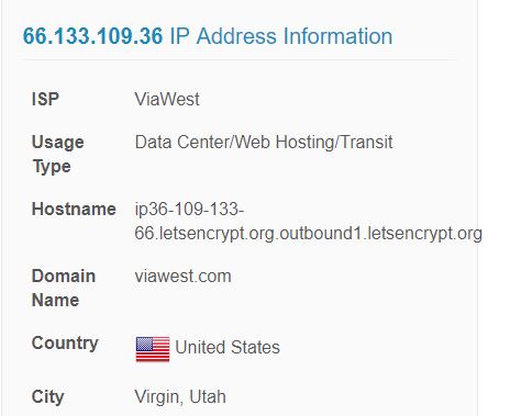

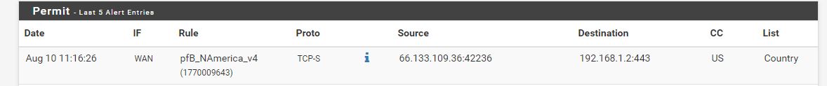

August 10, 20179 yr 11 minutes ago, aptalca said: 2 hours ago, surfshack66 said: Brought to you by linuxserver.ioWe gratefully accept donations at:https://www.linuxserver.io/donations/-------------------------------------GID/UID-------------------------------------User uid: 99User gid: 100-------------------------------------[cont-init.d] 10-adduser: exited 0.[cont-init.d] 20-config: executing...[cont-init.d] 20-config: exited 0.[cont-init.d] 30-keygen: executing...using keys found in /config/keys[cont-init.d] 30-keygen: exited 0.[cont-init.d] 50-config: executing...2048 bit DH parameters presentSUBDOMAINS entered, processingSub-domains processed are: -d sub1.domain.com -d sub2.domain.comE-mail address entered: Different sub/domains entered than what was used before. Revoking and deleting existing certificate, and an updated one will be createdusage:certbot [sUBCOMMAND] [options] [-d DOMAIN] [-d DOMAIN] ...Certbot can obtain and install HTTPS/TLS/SSL certificates. By default,it will attempt to use a webserver both for obtaining and installing thecert.certbot: error: argument --cert-path: No such file or directoryGenerating new certificateSaving debug log to /var/log/letsencrypt/letsencrypt.logObtaining a new certificatePerforming the following challenges:tls-sni-01 challenge for domain.comtls-sni-01 challenge for sub1.domain.comtls-sni-01 challenge for sub2.domain.comWaiting for verification...Performing the following challenges:tls-sni-01 challenge for domain.comtls-sni-01 challenge for sub1.domain.comtls-sni-01 challenge for sub2.domain.comWaiting for verification...Cleaning up challengesFailed authorization procedure. sub1.domain.com (tls-sni-01): urn:acme:error:connection :: The server could not connect to the client to verify the domain :: Connection refused, sub2.domain.com (tls-sni-01): urn:acme:error:connection :: The server could not connect to the client to verify the domain :: Connection refusedIMPORTANT NOTES:- The following errors were reported by the server:Domain: sub1.domain.comType: connectionDetail: Connection refusedDomain: sub2.domain.comType: connectionDetail: Connection refusedTo fix these errors, please make sure that your domain name wasentered correctly and the DNS A record(s) for that domaincontain(s) the right IP address. Additionally, please check thatyour computer has a publicly routable IP address and that nofirewalls are preventing the server from communicating with theclient. If you're using the webroot plugin, you should also verifythat you are serving files from the webroot path you provided.- Your account credentials have been saved in your Certbotconfiguration directory at /etc/letsencrypt. You should make asecure backup of this folder now. This configuration directory willalso contain certificates and private keys obtained by Certbot somaking regular backups of this folder is ideal./var/run/s6/etc/cont-init.d/50-config: line 127: cd: /config/keys/letsencrypt: No such file or directory[cont-init.d] 50-config: exited 1.[cont-finish.d] executing container finish scripts...[cont-finish.d] done.[s6-finish] syncing disks.[s6-finish] sending all processes the TERM signal.[s6-finish] sending all processes the KILL signal and exiting. Assuming the ip is correct, your router seems to be not forwarding the request on port 443 to the container properly I thought so too but I just checked my firewall logs.
August 10, 20179 yr 5 minutes ago, surfshack66 said: I thought so too but I just checked my firewall logs. There's your problem. Change 42236 to 443 and it will fire right up.
August 10, 20179 yr 1 minute ago, jonathanm said: There's your problem. Change 42236 to 443 and it will fire right up. No thats not my NAT rule. Thats my permit inbound traffic rule. The source IP (lets encrypt) is accessing my webserver. The rule allows IPs originating from North America.
August 10, 20179 yr 1 minute ago, surfshack66 said: No thats not my NAT rule. Thats my permit inbound traffic rule. The source IP (lets encrypt) is accessing my webserver. The rule allows IPs originating from North America. Ahh, my bad. If you stop letsencrypt and fire up a different container on the same internal port and IP, can you access it from outside your firewall on <externalip>:443?

August 10, 20179 yr If canyouseeme.org thinks the port is closed, it's closed, whether the container can see the outside world or not is immaterial. Also I'd get rid of that URL redirect in namecheap.
August 10, 20179 yr @chbmb On my config, does it look like I have PlexPy setup right? For some reason it's not passing. Plex and SabNZB works Sent from my iPhone using Tapatalk
August 10, 20179 yr 53 minutes ago, CHBMB said: If canyouseeme.org thinks the port is closed, it's closed, whether the container can see the outside world or not is immaterial. Also I'd get rid of that URL redirect in namecheap. Its odd that the port is open when the nginx container is started but closed when the letsencrypt container is started. I'm at a loss. Also, I removed the URL redirect but then received a different error from letsencrypt below. FYI - Port 80 is definitely blocked by my ISP, so the domain won't reach my IP then. Failed authorization procedure. sub1.domain.com (tls-sni-01): urn:acme:error:connection :: The server could not connect to the client to verify the domain :: DNS problem: NXDOMAIN looking up A for sub1.domain.com, sub2.domain.com (tls-sni-01): urn:acme:error:connection :: The server could not connect to the client to verify the domain :: DNS problem: NXDOMAIN looking up A for sub2.domain.com IMPORTANT NOTES: - The following errors were reported by the server: Domain: sub1.domain.com Type: connection Detail: DNS problem: NXDOMAIN looking up A for sub1.domain.com Domain: sub2.domain.com Type: connection Detail: DNS problem: NXDOMAIN looking up A for sub2.domain.com
August 10, 20179 yr Get rid of the URL redirect, not necessary. If your DNS isn't forwarding properly and LE can't authenticate then nginx won't work.
