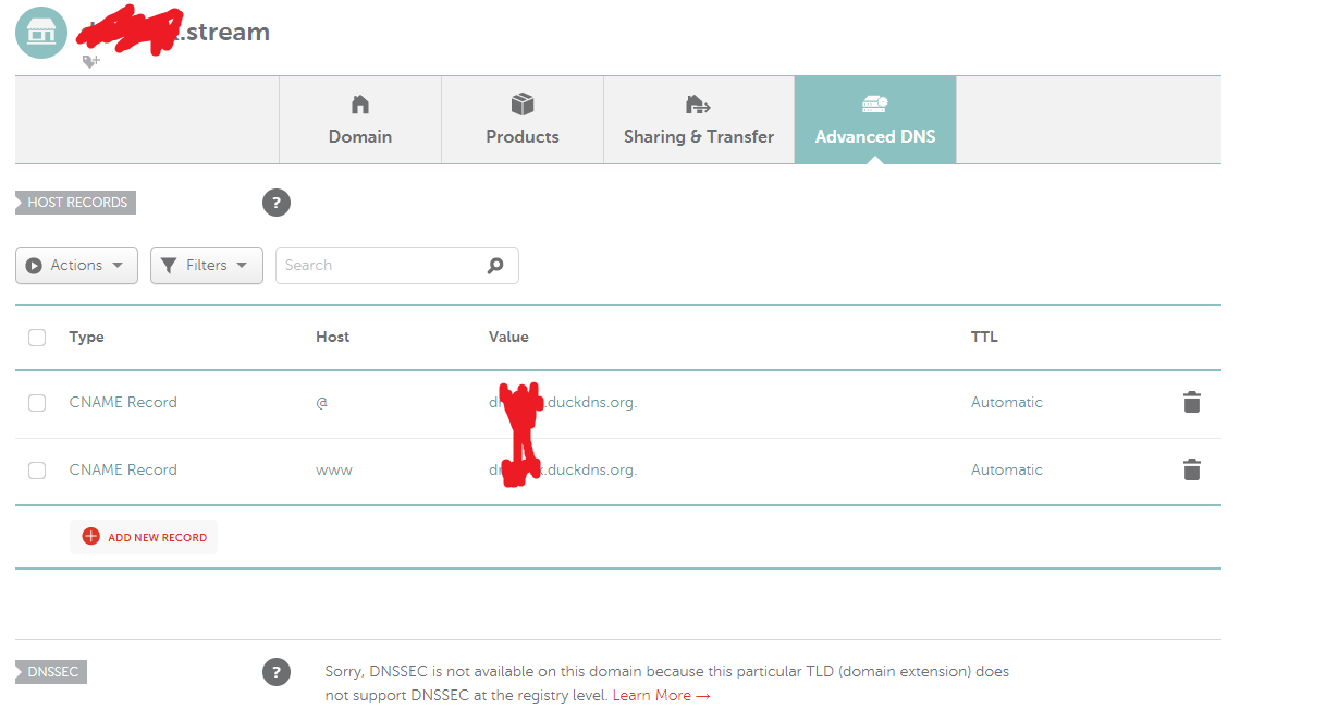

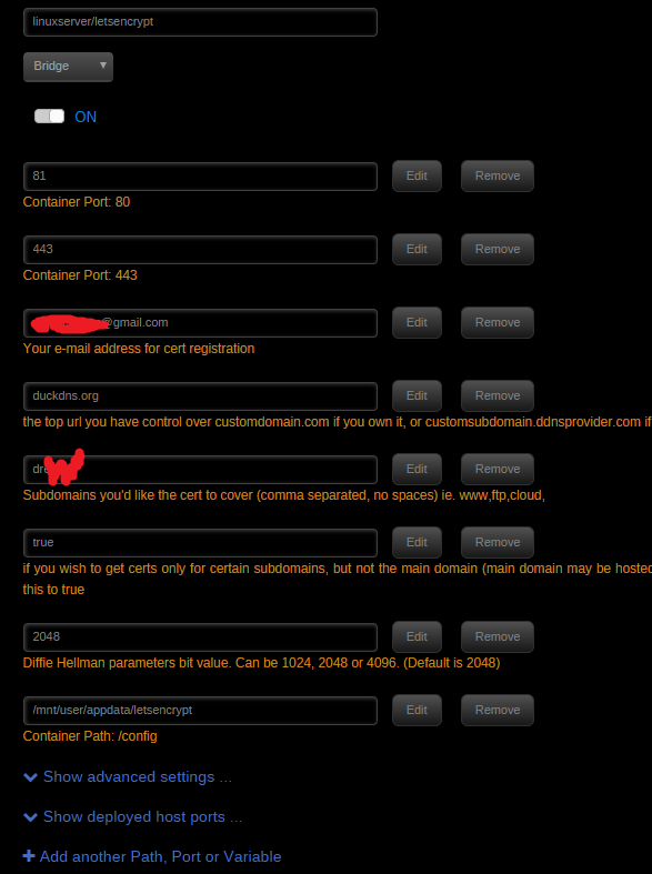

I't trying to set letsencrypt up in conjunction with duckdns, organizr, and my own personal domain. I am following this  guide.
I have my domain through namecheap and their dns was not working correctly for some reason with letsencrypt.
I went ahead and created a DuckDNS subdomain to use directly with letsencrypt and then just insert a CNAME into namecheap that is the DuckDNS subdomain. (I think that will work)
My main issues right now is I cannot get the NGINX splash to come up when i go to http://MYSERVER:81 but it will come up when i navigate to https://192.168.1.105. And it wont work when i navigate to my purchased domain.
I have very little knowledge when it comes to web hosting and that is my main issue.
IMGUR POST WITH ALL SETTINGS

Try creating A-Names with Dynamic DNS address.  Then you won't have to use DuckDNS
I tried that but it wasn't working well for me. I will try it again though. Do the other settings look right?

I'm going to assume your domain name is dranani.com , so this is how I'd set it up...
Top URL = dranani.com
Subdomains = www
Certs for certain subdomains = false
EDIT:  Turn off DNSSEC, you've put internal IP addresses in there anyway, so that won't work.
How are you updating your dynamic DNS records with Namecheap?

stupid question, how should i forward my IP? just [Aname --@--public IP] & [Aname --www--public IP]?
If you have a dynamic IP then you need some way of monitoring that and notifying namecheap if it changes.
Do you have a dynamic IP or Static?
I'm fairly certain it is static but have never paid much attention
If it's static then just put the IP into namecheap and no need to worry about it as it won't change.

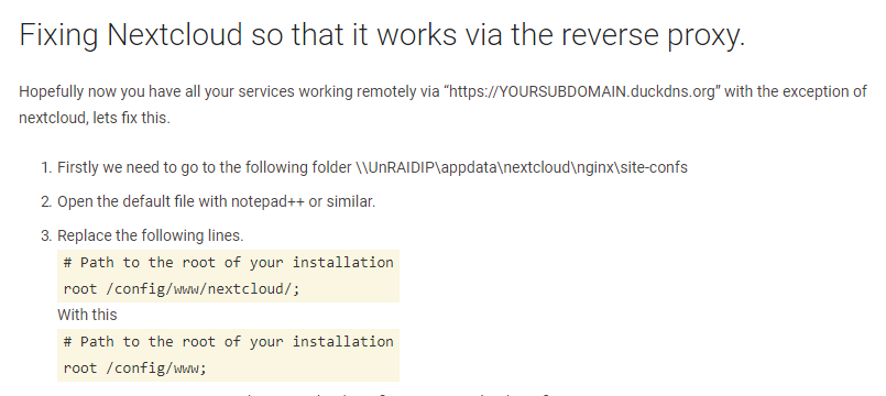

I just got NextCloud working. I forgot this part:
Changing the default file of nextcloud ¬¬
I thank everyone who helped me with this :)
