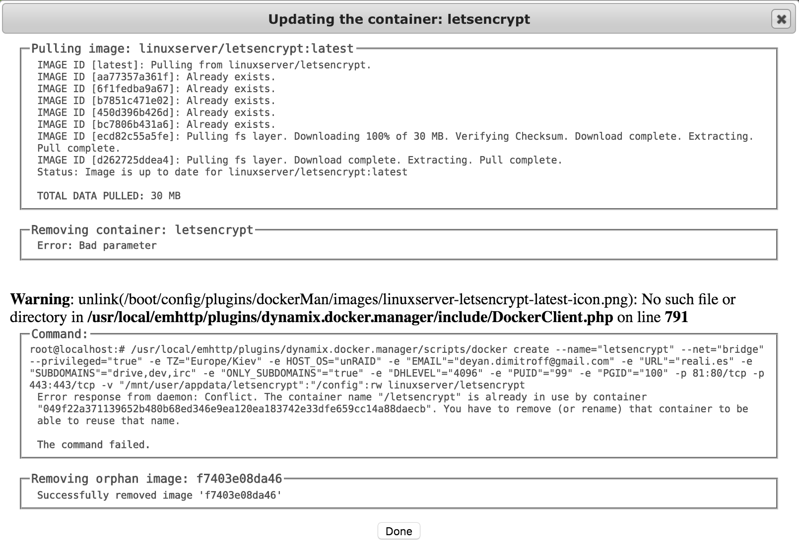

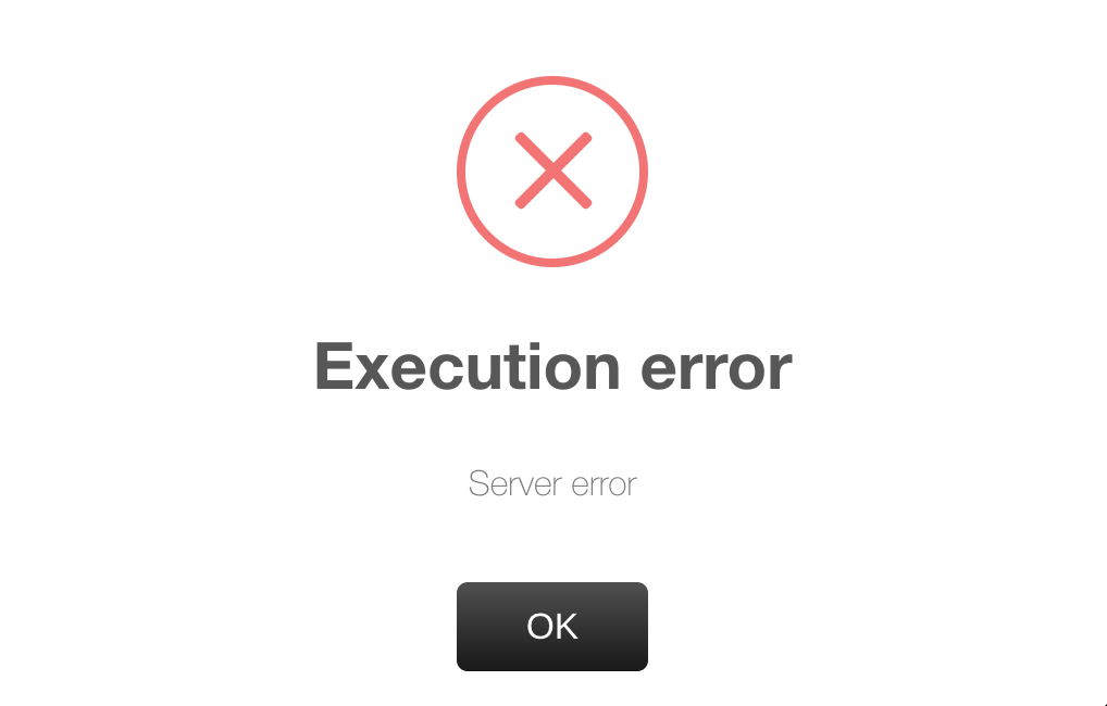

September 23, 20178 yr Having issues updating and starting on 6.4.0-rc9f. Edited February 3, 20188 yr by realies
September 23, 20178 yr That's an issue with docker I think. Switch advanced on in the webui. Delete any letsencrypt containers & images including any orphan containers and try pulling again.
September 23, 20178 yr 48 minutes ago, CHBMB said: That's an issue with docker I think. Switch advanced on in the webui. Delete any letsencrypt containers & images including any orphan containers and try pulling again. Removing the container and image (without orphan containers) and reinstalling worked. Although now I think I am having trouble with the built-in https support of 6.4.0.rc9f.
