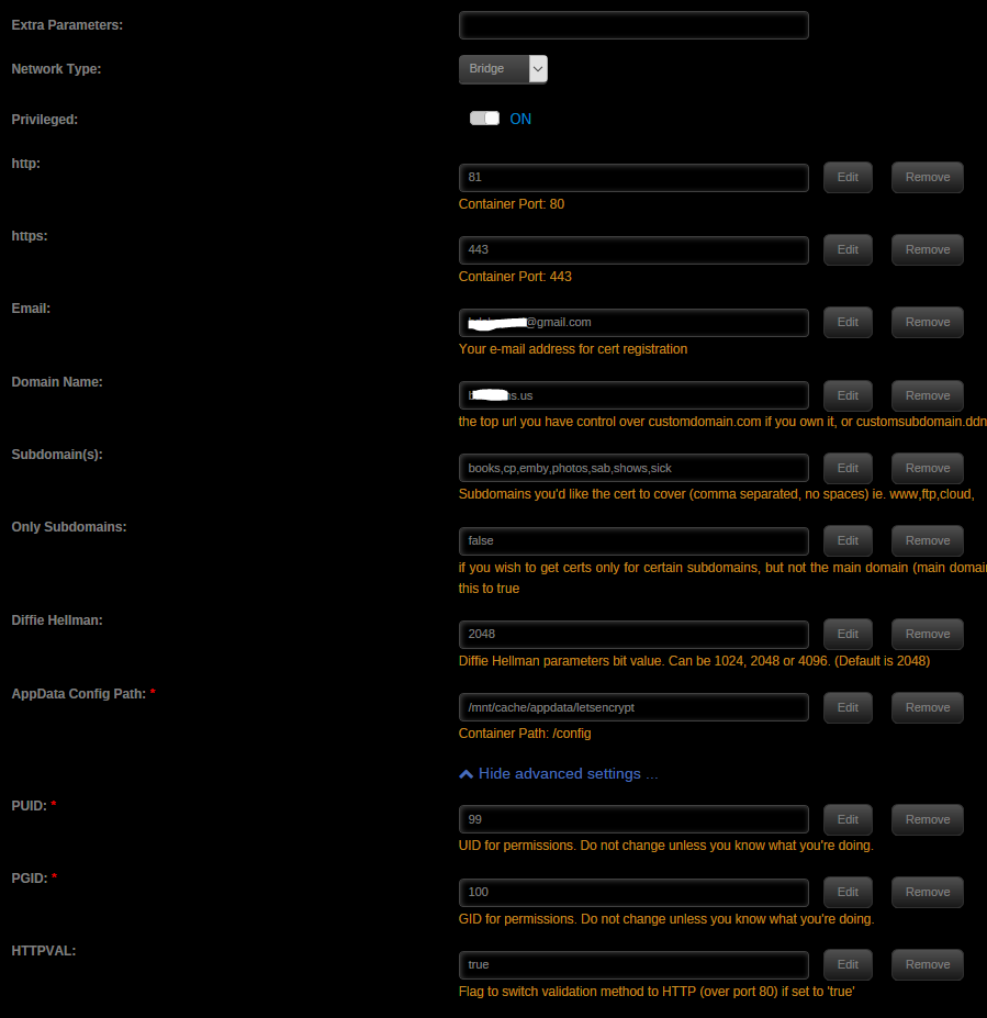

aptalca 325 Posted January 13, 2018 Share Posted January 13, 2018 (edited) 7 minutes ago, FreeMan said: I went ahead and removed the extra "Hosts" parameter and LE is running, however, I'm still unable to get through to emby It seems that I'm having a non-fatal error on startup: Here's the run command: The new run command: Carp, is this the issue? Check your settings, you have two HTTPVAL directives, second one is setting it to false Edited January 13, 2018 by aptalca Quote Link to post

izarkhin 1 Posted January 13, 2018 Share Posted January 13, 2018 7 minutes ago, Muff said: How did you do that? In the container map port 80 to some other port (8083 in this case): In the container advanced settings set HTTPVAL to true: On the router forward port 80 to the same port you mapped your container's port 80 to (port 8083 ion this case): Quote Link to post

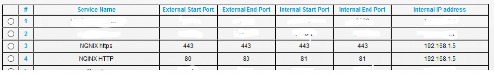

FreeMan 61 Posted January 13, 2018 Share Posted January 13, 2018 2 hours ago, aptalca said: Check your settings, you have two HTTPVAL directives, second one is setting it to false Thanks - the penny dropped when you said that... I believe I've got everything set correctly , but I'm still getting errors and not getting access via the domain, while internally via the IP works fine. My docker settings: I hit the "advanced view" and put the "-e "HTTPVAL"="true"" in there while not hitting the "Advanced settings" to realize that it had been added to the container - that's why I had 2 conflicting settings in the run command. I've rectified that and now my run command is: root@localhost:# /usr/local/emhttp/plugins/dynamix.docker.manager/scripts/docker run -d --name="letsencrypt" --net="bridge" --privileged="true" -e TZ="America/New_York" -e HOST_OS="unRAID" -e "EMAIL"="me@gmail.com" -e "URL"="mydomain.us" -e "SUBDOMAINS"="books,cp,emby,photos,sab,shows,sick" -e "ONLY_SUBDOMAINS"="false" -e "DHLEVEL"="2048" -e "PUID"="99" -e "PGID"="100" -e "HTTPVAL"="true" -p 81:81/tcp -p 443:443/tcp -v "/mnt/cache/appdata/letsencrypt":"/config":rw linuxserver/letsencrypt I'm confused by the port mapping of 81:81 - I thought it should be 80:81 (or vice versa) since I'm forwarding external port 80 to internal port 81 and LE should be listening on that. Here's the router settings showing that: And yet the LE log shows: IMPORTANT NOTES:- The following errors were reported by the server:Domain: photos.mydomain.usType: connectionDetail: Fetchinghttp://photos.mydomain.us/.well-known/acme-challenge/MnhfHpAVNOCCW7o1D8UMwqy5AzUUNr9QPfjbhwl-k1M:Connection refusedDomain: cp.mydomain.usType: connectionDetail: Fetchinghttp://cp.mydomain.us/.well-known/acme-challenge/Flk3oN3gS8SyH--pD6pnLawz4Ukf0cE0Xq-lcia-N_8:Connection refused etc... In my ...\nginx\site-confs\default I have: # listening on port 80 disabled by default, remove the "#" signs to enable # redirect all traffic to https server { listen 80; server_name _; return 301 https://$host$request_uri; } # main server block server { listen 443 ssl default_server; root /config/www; index index.html index.htm index.php; add_header Strict-Transport-Security "max-age=2592000; includeSubdomains" always; add_header Content-Security-Policy "frame-ancestors bds.ddns.us emby.bds.ddns.us;"; add_header Referrer-Policy "no-referrer"; server_name _; #SSL Certificates ssl_certificate /config/keys/letsencrypt/fullchain.pem; ssl_certificate_key /config/keys/letsencrypt/privkey.pem; #Diffie-Hellman key exchange ssl_dhparam /config/nginx/dhparams.pem; #SSL Ciphers ssl_ciphers 'ECDHE-RSA-AES128-GCM-SHA256:ECDHE-ECDSA-AES128-GCM-SHA256:ECDHE-RSA-AES256-GCM-SHA384:ECDHE-ECDSA-AES256-GCM-SHA384:DHE-RSA-AES128-GCM-SHA256:DHE-DSS-AES128-GCM-SHA256:kEDH+AESGCM:ECDHE-RSA-AES128-SHA256:ECDHE-ECDSA-AES128-SHA256:ECDHE-RSA-AES128-SHA:ECDHE-ECDSA-AES128-SHA:ECDHE-RSA-AES256-SHA384:ECDHE-ECDSA-AES256-SHA384:ECDHE-RSA-AES256-SHA:ECDHE-ECDSA-AES256-SHA:DHE-RSA-AES128-SHA256:DHE-RSA-AES128-SHA:DHE-DSS-AES128-SHA256:DHE-RSA-AES256-SHA256:DHE-DSS-AES256-SHA:DHE-RSA-AES256-SHA:AES128-GCM-SHA256:AES256-GCM-SHA384:AES128-SHA256:AES256-SHA256:AES128-SHA:AES256-SHA:AES:CAMELLIA:DES-CBC3-SHA:!aNULL:!eNULL:!EXPORT:!DES:!RC4:!MD5:!PSK:!aECDH:!EDH-DSS-DES-CBC3-SHA:!EDH-RSA-DES-CBC3-SHA:!KRB5-DES-CBC3-SHA'; ssl_prefer_server_ciphers on; ###Extra Settings### ssl_session_cache shared:SSL:10m; ### Add HTTP Strict Transport Security ### add_header Strict-Transport-Security "max-age=63072000; includeSubdomains"; add_header Front-End-Https on; client_max_body_size 0; location / { try_files $uri $uri/ /index.html /index.php?$args =404; } location ~ \.php$ { fastcgi_split_path_info ^(.+\.php)(/.+)$; # With php7-cgi alone: fastcgi_pass 127.0.0.1:9000; # With php7-fpm: #fastcgi_pass unix:/var/run/php7-fpm.sock; fastcgi_index index.php; include /etc/nginx/fastcgi_params; } } to redirect HTTP to HTTPS. Do I now need to remove this section in blue in order to make validation work? If so, do I need to do it only in "default" since that's the only one of the config files that listens on 80? (All the rest only have a server { listen 443 ssl; ...} section.) I've read and re-read the last 4 pages or so of complaints, attempts, and fixes, I've thought they made sense and I've attempted to apply what I learned, but I'm still stuck... Quote Link to post

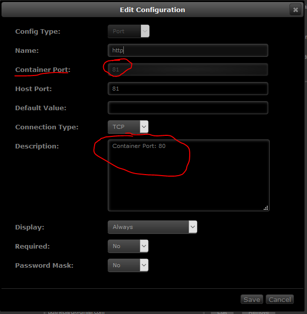

CHBMB 976 Posted January 13, 2018 Share Posted January 13, 2018 (edited) 35 minutes ago, FreeMan said: OK, so what's causing these errors in the log and causing me not to be able to access my server? Failed authorization procedure. photos.bds.mydomain.us (http-01): urn:acme:error:connection :: The server could not connect to the client to verify the domain :: Fetching http://photos.mydomain.us/.well-known/acme-challenge/MnhfHpAVNOCCW7o1D8UMwqy5AzUUNr9QPfjbhwl-k1M: Connection refused, cp.mydomain.us (http-01): urn:acme:error:connection :: The server could not connect to the client to verify the domain :: Fetching http://cp.mydomain.us/.well-known/acme-challenge/Flk3oN3gS8SyH--pD6pnLawz4Ukf0cE0Xq-lcia-N_8: Based on the lack of other feedback, I'd presume that all the configuration info I showed appears to be correct. Like I said, I've read through several pages of posts and tried to put it all together. This is the best I've come up with and it's still not working. You may have to break out the crayons and color me a picture 'cause I'm missing something. You need to map port 80 INSIDE the docker container to port 81 on Unraid Like this..... Edited January 13, 2018 by CHBMB Quote Link to post

FreeMan 61 Posted January 14, 2018 Share Posted January 14, 2018 1 hour ago, CHBMB said: You need to map port 80 INSIDE the docker container to port 81 on Unraid Like this..... Like this? That's how it's currently set (and hasn't been changed), but it is yielding this run command: root@localhost:# /usr/local/emhttp/plugins/dynamix.docker.manager/scripts/docker run -d --name="letsencrypt" --net="bridge" --privileged="true" -e TZ="America/New_York" -e HOST_OS="unRAID" -e "EMAIL"="me@gmail.com" -e "URL"="mydomain.us" -e "SUBDOMAINS"="books,cp,emby,photos,sab,shows,sick" -e "ONLY_SUBDOMAINS"="false" -e "DHLEVEL"="2048" -e "PUID"="99" -e "PGID"="100" -e "HTTPVAL"="true" -p 81:81/tcp -p 443:443/tcp -v "/mnt/cache/appdata/letsencrypt":"/config":rw linuxserver/letsencrypt When I clicked on the Edit button from the first picture, it shows me this: Which looks very much borked! Time for a reinstall? Quote Link to post
