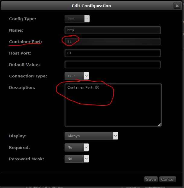

January 14, 20188 yr I deleted the default HTTP port mapping: and created a new one: and winner, winner, chicken dinner I'm back in business! Is there something wrong with the template that it's mapping internally to port 81, or is that in preparation for v6.4 and I need to change my port forward at the router, or...?
January 14, 20188 yr 5 hours ago, aptalca said: The last update of this image didn't break things. I fully appreciate all the work & support you and @CHBMB , in particular, put into supporting all the lsio containers and answering all our questions. I, for one, meant no implication that you guys broke things - it's just that the symptoms of the LE change didn't show up for us mere-mortal users until the updated, fixed version rolled out to us and we tried to revalidate our sites using configuration for the old methods. Since I don't keep a finger on the pulse of the latest security issues, my two data points were A) LE updated, and B) I can't get the container to start. That, therefore, led to my conclusion - it's broken. Again - there's no way I could manage to get through all these fantastic bits working without you wizards behind the curtain. Thank you!
January 14, 20188 yr 19 minutes ago, FreeMan said: I deleted the default HTTP port mapping: and created a new one: and winner, winner, chicken dinner I'm back in business! Is there something wrong with the template that it's mapping internally to port 81, or is that in preparation for v6.4 and I need to change my port forward at the router, or...? The 81 part is most likely your own doing. It's port 80 in the template.
January 14, 20188 yr 1 minute ago, saarg said: The 81 part is most likely your own doing. It's port 80 in the template. I'll accept responsibility, but I have no recollection whatsoever of ever having changed that setting. Weird...

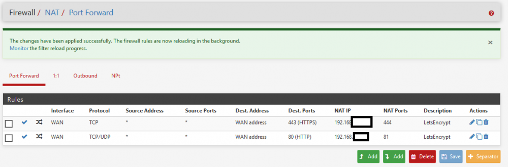

January 14, 20188 yr 16 minutes ago, Earache said: Rogers Internet (Canada). They apparently don't block it so I don't know wtf is going on. I'm using an EdgeRouter Lite, so either my port-forwarding is farked or Rogers decided to block the port? Your port forwarding is wrong. You are forwarding 81 to 80, you should be forwarding 80 to 81 Edited January 14, 20188 yr by aptalca
January 14, 20188 yr 8 minutes ago, aptalca said: Your port forwarding is wrong. You are forwarding 81 to 80, you should be forwarding 80 to 81 Nope still get Failed authorization procedure. sub.domain.org (http-01): urn:acme:error:connection :: The server could not connect to the client to verify the domain :: Fetching http://sub.domain/.well-known/acme-challenge/dcVgooswjuwm_DhQXskQSuKDbRdmN4qKyZTxbDzFg9g: Timeout ERROR: Cert does not exist! Please see the validation error above. The issue may be due to incorrect dns or port forwarding settings. Please fix your settings and recreate the container

January 14, 20188 yr 5 hours ago, Earache said: Nope still get Failed authorization procedure. sub.domain.org (http-01): urn:acme:error:connection :: The server could not connect to the client to verify the domain :: Fetching http://sub.domain/.well-known/acme-challenge/dcVgooswjuwm_DhQXskQSuKDbRdmN4qKyZTxbDzFg9g: Timeout ERROR: Cert does not exist! Please see the validation error above. The issue may be due to incorrect dns or port forwarding settings. Please fix your settings and recreate the container You're also forwarding 444 to 443, again the wrong way around, these are inbound ports, not outbound

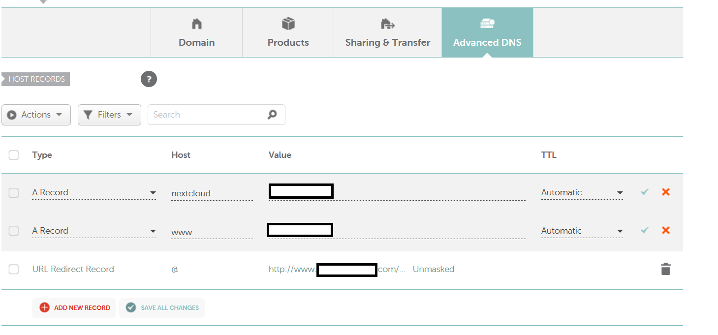

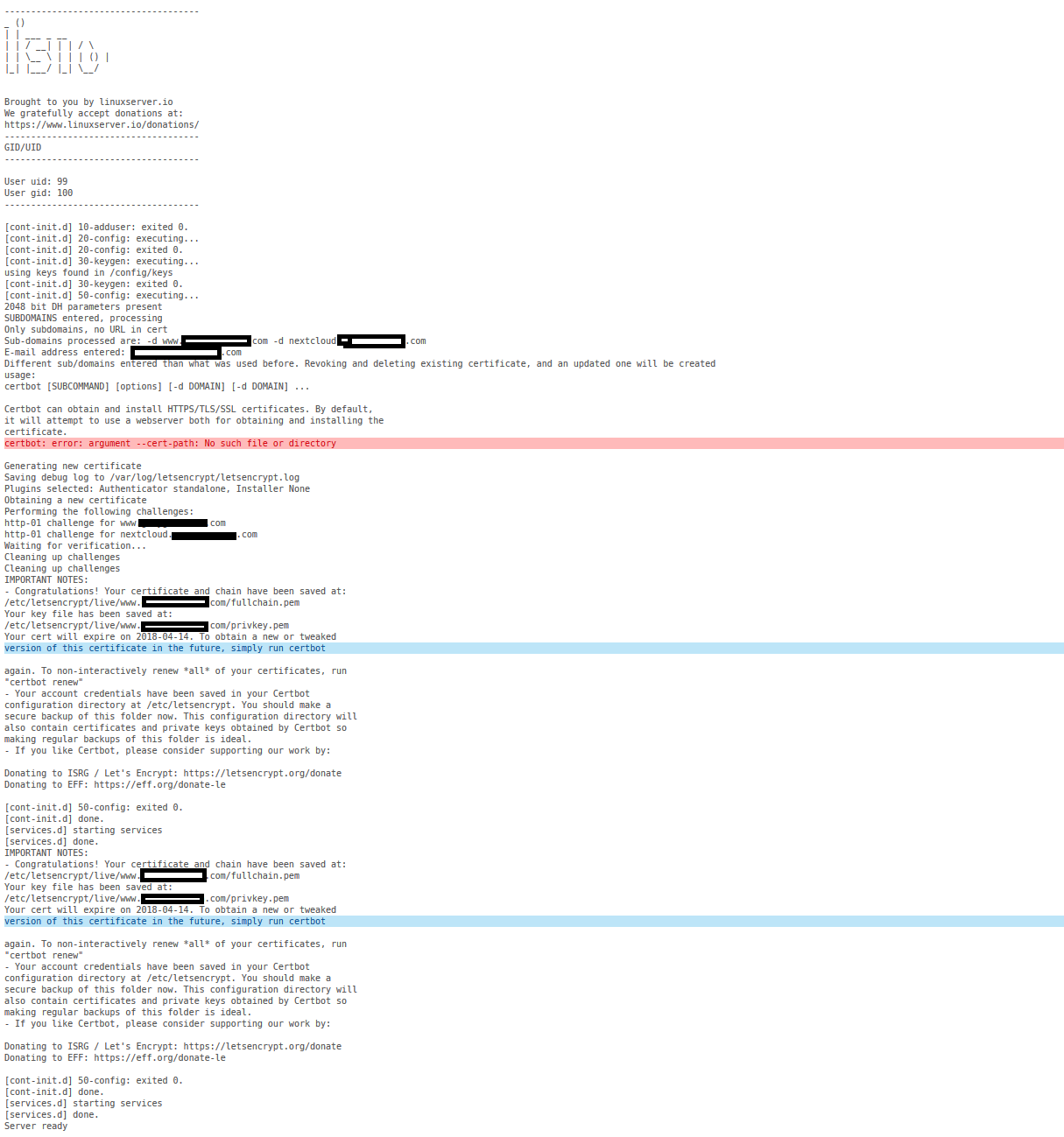

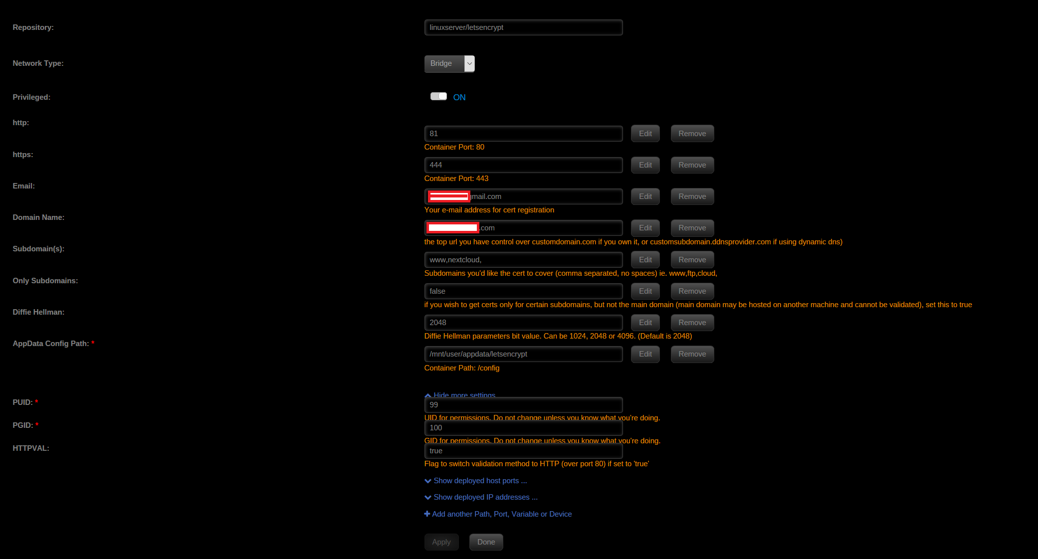

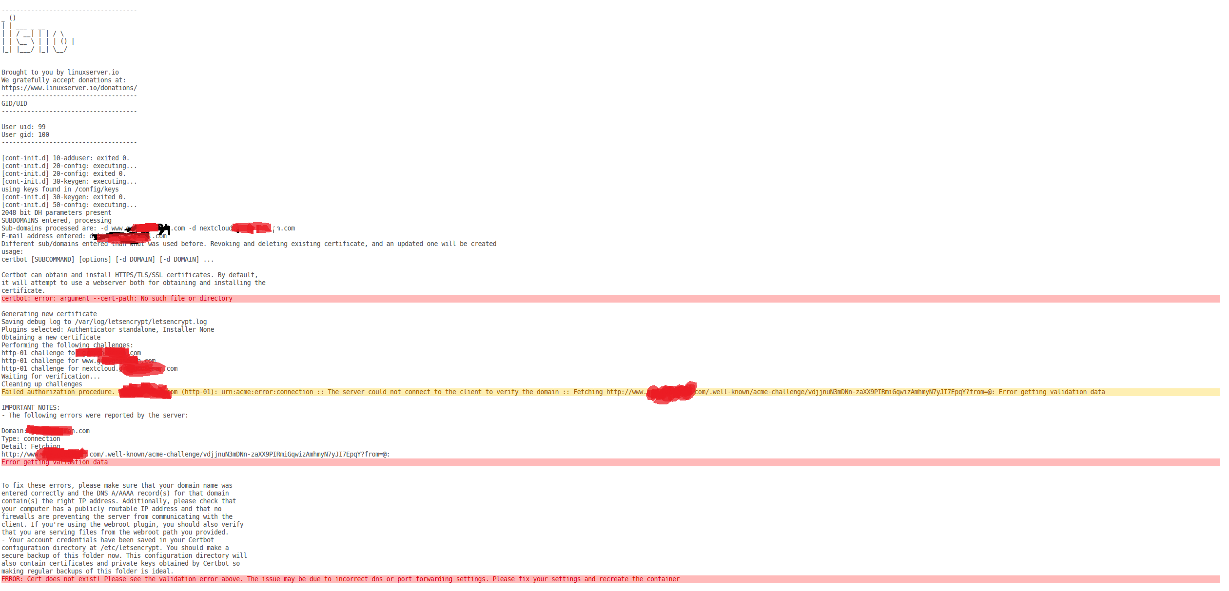

January 14, 20188 yr 12 minutes ago, Greygoose said: here is my config, please someone tell me what im doing wrong. Can you check that the IP address you have in Namecheap DNS settings is the same as the IP address you get when you go to https://www.whatismyip.com/

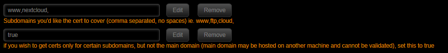

January 14, 20188 yr I have changed in docker to use only subdomains and then run docker and it looks to have started? Edited January 14, 20188 yr by Greygoose

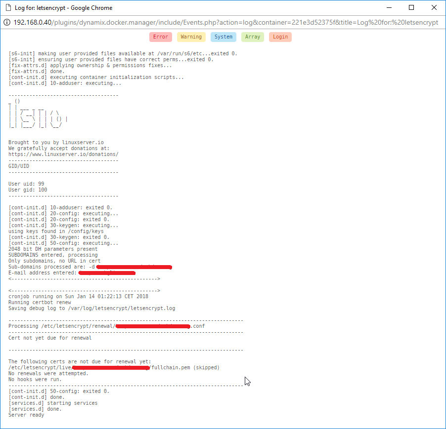

January 14, 20188 yr The was doing the trick: port forward http (tcp 80 -->> 85) as well as https (tcp 443 -->> 443) is required. This was working for unRAID 6.3.5 but it stopped working for 6.4. Anyone Else whole made that experience? Latest letsencrypt Docker is installed: root@localhost:# /usr/local/emhttp/plugins/dynamix.docker.manager/scripts/docker run -d --name="letsencrypt" --net="bridge" --privileged="true" -e TZ="Europe/Berlin" -e HOST_OS="unRAID" -e "EMAIL"="[email protected]" -e "URL"="mydomain.org" -e "ONLY_SUBDOMAINS"="false" -e "DHLEVEL"="4096" -e "PUID"="99" -e "PGID"="100" -e "HTTPVAL"="true" -p 85:80/tcp -p 443:443/tcp -v "/mnt/user/system/docker/appdata/letsencrypt":"/config":rw linuxserver/letsencrypt68820e55413df4f6d12189d079334a943a01c4699136e38059fc459597f8670b/usr/bin/docker: Error response from daemon: driver failed programming external connectivity on endpoint letsencrypt (296916628be7ee045bd094ac8ebaa72631a8bd1146130c8480a19b91462dd0d4): Error starting userland proxy: listen tcp 0.0.0.0:443: bind: address already in use. Gesendet von iPad mit Tapatalk
January 14, 20188 yr 1 minute ago, Greygoose said: I have changed in docker to use only subdomains and then run docker and it looks to have started? What had you got in DOMAIN NAME? If you don't want to post it in public can you PM me? I have a theory....
January 14, 20188 yr 1 minute ago, EdgarWallace said: This was working for unRAID 6.3.5 but it stopped working for 6.4. Anyone Else whole made that experience? Latest letsencrypt Docker is installed. Gesendet von iPad mit Tapatalk
