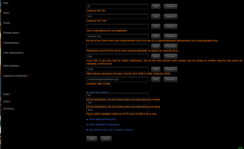

Loosing my mind here. I've read all the documentation but it doesn't seem like http val is working through port 81 (port 80 is blocked by my isp). Am I missing something obvious?

ERROR: Cert does not exist! Please see the validation error above. The issue may be due to incorrect dns or port forwarding settings. Please fix your settings and recreate the container
Sort of. You stated the problem very well. If port 80 is blocked, you can't use httpval. Period. End of Sentence.
You will have to figure out one of the other methods for getting certificates from LE.

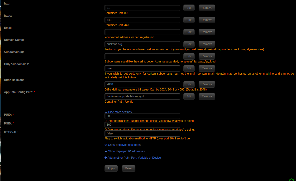

I wrongly assumed by changing the port to 81 on the config that would help. Thanks. Suggestions on alternatives?

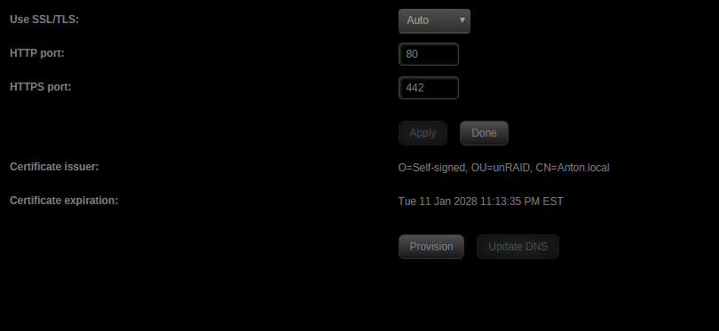

Going to mydomain.duckdns.org seems to take me to the unraid webgui instead of going through lets encrypt. I've been playing around with the settings as mentioned in the last few pages but i can't seem to get this working. I changed most of it back to what i had before. Here's what it is right now. I feel like it has to do with Unraid's HTTP port being set to 80 by default but i've tried changing that to 8008 and that didn't work either.
3.PNG.9f35829fbcea925fa0ef1545564936cd.PNG2.PNG.85ff33a781ec492080d0aafcfebac6eb.PNG1.thumb.PNG.80d3367ce55bf293aee36cfbdfb9aa15.PNG
Edited by Invincible
Added pictures of current settings
Link to post
