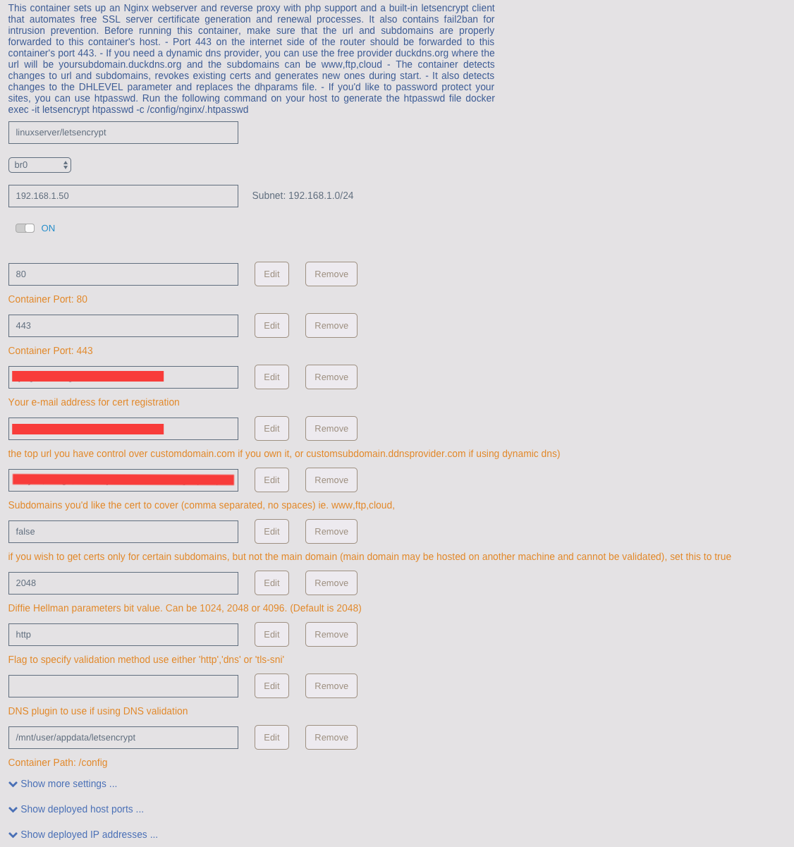

So I'm trying to migrate from a standalone instance of this container to the unraid container now that I can assign IP addresses directly to containers. I'm running into an issue where the container doesn't seem to be able to reach the host(where all the services being reverse-proxied live). The container can talk to other systems on the same network with no issue but not the unraid host it is running on.
# letsencrypt container to an nzbget container on unRAID
root@73977ce49f97:/root$ nc -vz 192.168.1.10 6789
nc: 192.168.1.10 (192.168.1.10:6789): Host is unreachable
# nzbget container accessible from another system on my network
Connection to 192.168.1.10 6789 port [tcp/*] succeeded!
# letsencrypt container can talk to systems that aren't unraid on the network
root@73977ce49f97:/root$ nc -vz 192.168.1.11 5000
192.168.1.11 (192.168.1.11:5000) open
Am I missing something in my configuration to make them able to talk to each other over the network? here is my container config in unraid
5a851f334e1b5_ScreenShot2018-02-14at10_46_37PM.thumb.png.d4730d5c96215641cd68e532998896a0.png
Link to post
That is how the security works when making macvlan in docker. The container can't talk to host. Only way around it is to set up some routing if I remember correctly. Don't know how, so use the search function of the forum to find it.
Link to post
Yeah I was just reading about that shortly after I posted. I had some spare NIC's on the box so I was able setup a second interface solely for use with docker which has allowed the container to communicate with the host. Thanks for the quick reply =]
Link to post

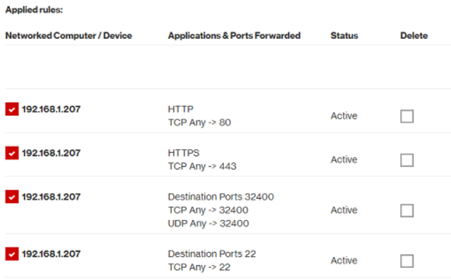

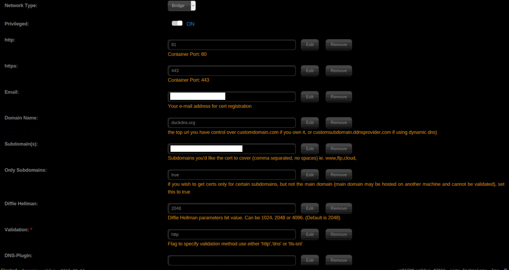

On 2/12/2018 at 5:04 PM, saarg said:
Your Wan port forward is wrong for port 80. Change it from 81 to 80.
I'm running into the same issue as deadnote. My LetsEncrypt was working fine prior to updating, but the container update seems to have broken it.
My port forwarding is set to port 80, and I have 80->81 in the container.
Does anyone know what else I can try?
Link to post
As far as I'm aware all the issues have fallen into 2 categories.  Those whose ISP blocks port 80 and those who haven't configured the container correctly
So post your docker logs, docker run command and screenshot of your port forwarding settings in your router and maybe we can help.  All we know from the info you've given is it isn't working, which isn't really enough to go on.

As the others, your port forward is wrong. You need to forward 80 external to 81 on the IP you have unraid.
Link to post
I think I understand.
I updated my router to forward to 81:
But now I'm running into an error with finding my 'default' file:
Docker Log
[cont-init.d] 50-config: exited 0.
[cont-init.d] done.
[services.d] done.
nginx: [emerg] open() "/config/nginx/common" failed (2: No such file or directory) in /config/nginx/site-confs/default:8
Edit: Disregard. I copied my common file over and now everything's working!
Thanks saarg / CHBMB!
Edited by Ezro
Link to post
