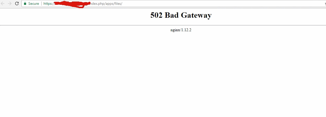

Can you help me setup this docker, I want to use it with nextcloud?

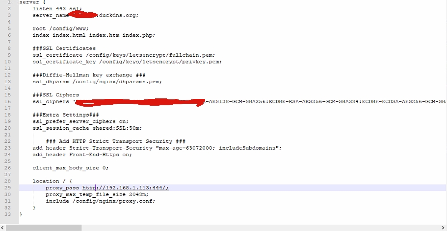

 cqan someone please point me in the right direction im trying to set this docker up with owjncloud i folled chmb guide here  https://blog.linuxserver.io/2017/05/10/installing-nextcloud-on-unraid-with-letsencrypt-reverse-proxy  and for the most part have things going when i launch the letsencrypt docker i get taken to welcome to our server  but when i launch owncloud i get 502 bad gateway ive been at this for 22 hours any help would be greatly appreciated
Edited by Sinister

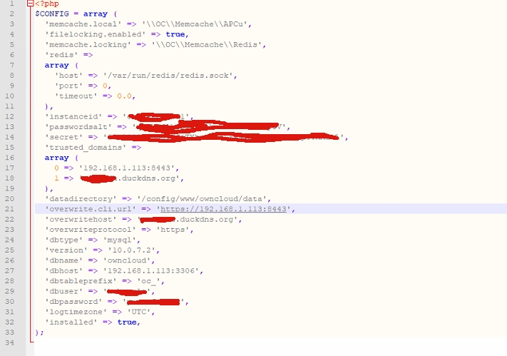

1. You are proxy_passing http not https. AND you are proxy_passing the letsencrypt container?! you need to proxy_pass the NEXTCLOUD container!  proxy_pass https://192.168.1.113:8443;
2: you config.php is wrong it needs to be 'overwrite.cli.url' => 'https://YOURsubdomain.duckdns.org', NOT you localip to nextcloud
