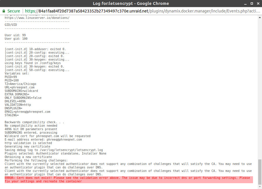

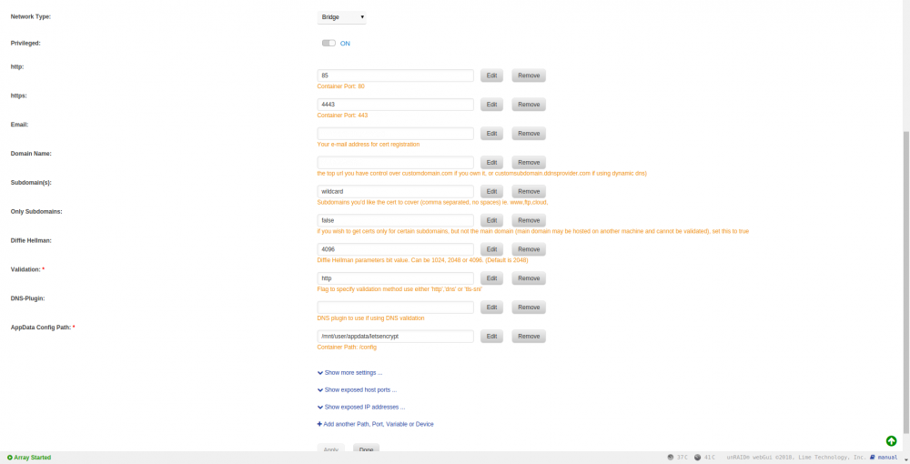

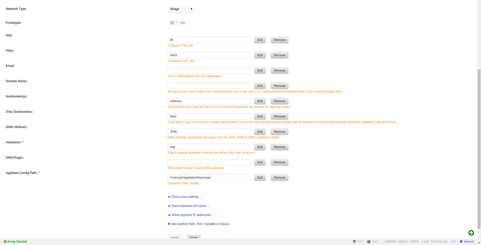

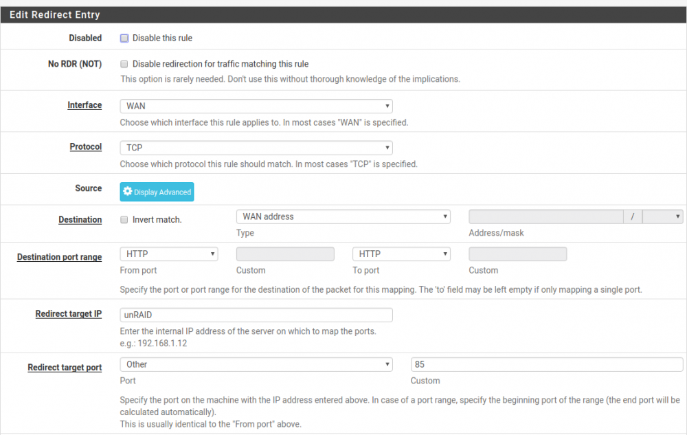

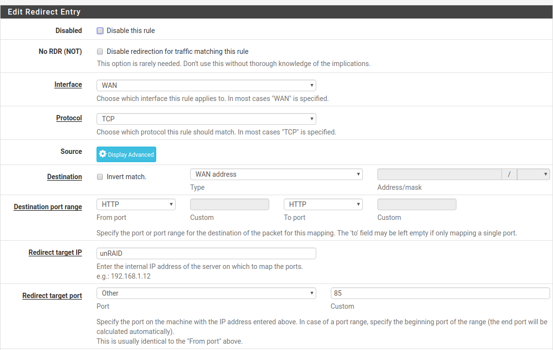

I just know that I'm missing something, but I can't figure out what. If any of y'all can give me a hand, I'd appreciate it.
cant do wildcard with http validation iirc. Read the FAQ on github
Edited by GilbN
So totally missed that part, thanks! Now I just need to figure out the whole dns validation part, wish me luck

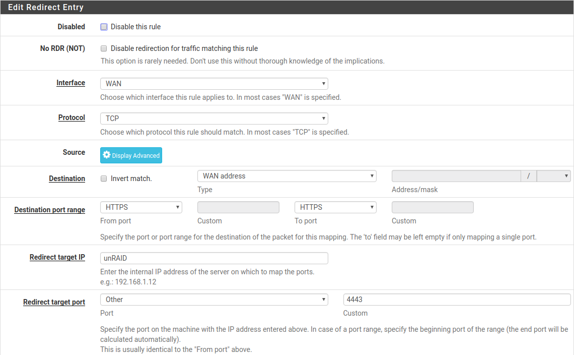

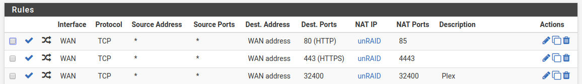

I dug through most of this post and I'm sure I'm missing something obvious, but could someone please look through my settings. I have tried everything that I can think of and I cant get it to work. Thank you Folks
Hmm, the port forwarding seems to be correct. Is the IP on duckdns correct?
If so, try restarting your router. And if that doesn't work, try setting the config folder location to /mnt/cache or /mnt/disk instead of /mnt/user
IP is correct, if I ping the domain name it comes up with my IP.
I appreciate your help, so far I've tried these:
restart router(plex port forward does work)
update firmware on router
reinstall docker from user to cache
change domain name to staticserver.duckdns.org instead of duckdns.org
change to different ports
I'm kind of at a loss for other things to try, is there a docker for testing port forward settings?
Install a docker for a plain web server configured for host 85 and 4445, and see if you can get external 80 and 443 answered properly there. You can have multiple dockers answering on the same ports as long as they aren't ever running at the same time.
Thankyou for your help. Unfortunately my understanding of unraid and networking is pretty basic, and mostly comes from youtube. While I think I get what you are saying, I am not sure how to do it. Any chance you could reference a video or specific docker container?

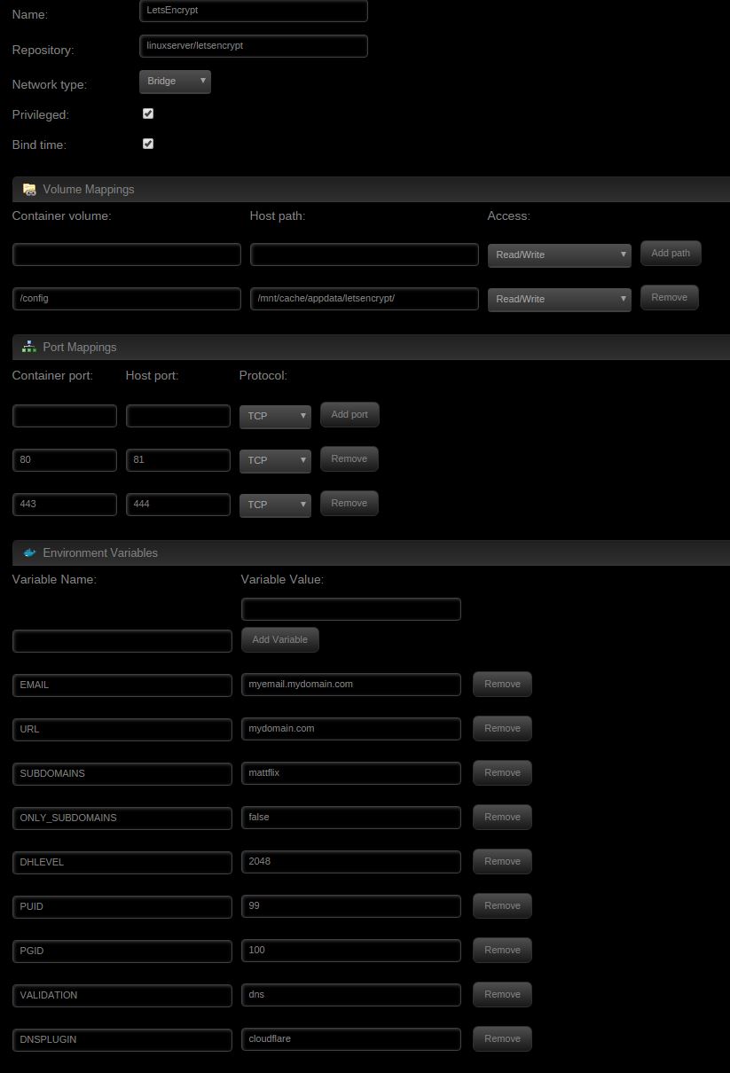

Is it possible to get the UNRAID GUI working through this letsencrypt / nginx reverse proxy ?  I tried but there were some pretty bad formatting errors that made it unusable.
I've gotten everything working so far for use with Ombi on unRAID 6.1.9, (I'll eventually be moving everything over to the sister server v6.5.0)
My questions now are really focused on security.
I have this server on my home network, with a few business servers running on the same network, and some business data even in the same unRAID server.
I'm hoping I may list my setup configurations here, and someone may be able to answer a few questions.
(All sensitive information fields have been redacted)
DDNS
DDNS is handled through freedns.afraid.org where mysub.strangled.net resolves to my home dynamically agssigned IP provided by my ISP.
The DDNS update is maintained by the DDNS updater in my DD-WRT flashed router.
DNS
The domain I use is actually a split domain, as the base domain mydomain.com points to an external business mail server.  I set up a separate sub-domain for use, we'll call it: mattflix.mydomain.com.  This is a CNAME using cloudflare DNS, that resolves to my DDNS domain provided by freedns.  This setup looks like so:
  • mattflix.mydomain.com --> mysub.strangled.net --> external IP at home.
Questions:
I assume because I am using a sub-domain of mydomain.com and not the base domain, this is what would be limiting me to only being able to use one letsencrypt/nginx/site-conf file (default) instead of what I've seen in this thread about using multiple files one for each subdomain?
  • I've tried every possible way I could find, and think of,  to make this work, with the default, without, with main server block in the default, and separate in each site conf..  But every time I have more than one site-conf file it kills the page and gives a connection refused.  (This does the same if I try to list more than one sub-domain /location in the default file.
I'm just confirming a suspicion here, and I know I can switch to mydomain.com/service over subdomains, or just buy a dedicated base domain.com.  Just want to confirm that is the solution or I'm doing something wrong.
Also: I currently have a couple subdomain.mydomains.com that resolve to the same DDNS destination.  The problem is they all translate to mattflix.mydomain.com
  • I'd like if possible to only allow specifically mattflix.mydomian.com resolve, and any other valid subdomain.mydomain.com either time out, or error.  I tried but just couldn't get it, I played around with the server listen block, and I suspect I'm just missing something in there?
Port Forwarding / LetsEncrypt Docker Container Setup
Firewall port forwarding is standard: External --> Internal  80 ---> 81 | 443 --> 444
DDNS
DNS
Questions:
LetsEncrypt Docker Configuration

This all gets me an A+ on securityheaders.io which is great and all, but what does that actually do for me?
I'm concerned about brute force, DDOS, and some thug trying to muscle into my server.
I've been trying to read up on fail2ban and it's implementation, however from what I've found, because I'm using this for Ombi, and it authenticates off of the users Plex account, this bypasses the fail2ban?
I've tried monitoring the fail2ban status however I get this error when I try to check the status:
docker exec -it LetsEncrypt bash
root@d3fc185ce9d5:/$ fail2ban-client -i

There are a lot of questions here so I'll take a stab and try to answer a few. But before I start I should let you know, it seems you took a lot of these configs from guides or other people. They are all so heavily modified that it is difficult for me to help troubleshoot. Nginx is a highly capable and thus complicated piece of software. For specific nginx config questions, I would recommend asking the folks who wrote the specific configs you're using.
First of all, I don't quite understand why you came up with such a confusing domain name forwarding structure. To me it seems all you needed was to use your main domain for business, and set A records for certain subdomains that point to your home server. If you're already using cloudflare for managing those dns records, I'm sure your ddwrt router can update those subdomains on cloudflare with ip changes. You shouldn't need to use the freedns ddns as an intermediate.
In letsencrypt, you can do one of two things, 1) set the url as mydomain.com, set the subdomains as matt,matt2,matt3 and set only_subdomains to true. That way it won't try to validate mydomain.com but you can add as many subdomains as you want, or 2) set the url to matt.mydomain.com and set subdomains to 1,2,3 and you'll get a cert that covers 1.matt.mydomain.com etc.
With regards to multiple site configs, it's up to you. Nginx simply combines them all into one giant config file through include statements in nginx.conf and other sub-confs. The only rule is, there has to be one named default, otherwise the container will create one. You likely had issues due to duplicate servers or locations.
If you want your server to only respond to certain requests, play with the server name. Keep in mind that you can define a default server name for each port, so if nginx gets a request with an unrecognized destination address, it will send it to the default server. So you can create a separate server block as a catch all by defining it as the default and make it do whatever you want, serve a 404, redirect to Google, etc.
Edited by aptalca
